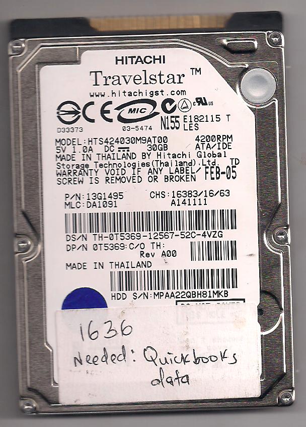

Wait a minute...
You're asking for WD donors and you show a Hitachi drive??
Which one is it??
