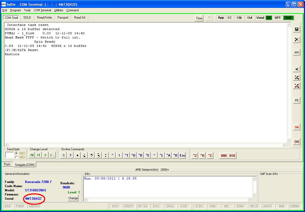

Hello, i've this Barracuda 7200.7 ST3160828AS with firmware 3.04 in busy state.
No head clicking and motor spins good.
Hyper terminal detects it in T level but i don't want to do anything more until i know the right procedure.
SeDiv detects the drive with correct S/N
I don't think the fix procedure is the same of 7200.11 serie, so i hope you can help me with the right procedure to fix it.
Thank you.

This:
T>Interface task reset
4096k x 16 buffer detected
PUMA2 - 1_Disk    0.03  12-12-05 14:40
Head Mask FFFF - Switch to full int.
              Spin Ready
3.04  12-12-05 14:42  4096k x 16 buffer
(P)(H)SATA Reset
Restore

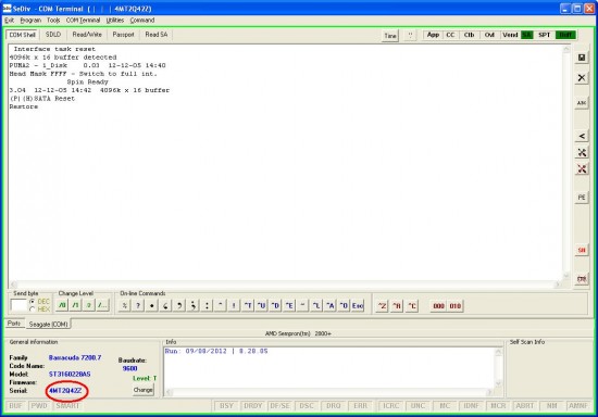

SeDiv the same of terminal when i apply power, but it shows me also the serial number of the drive:

T>nterface task reset
              Spin Ready
(P)SATA Reset
Restore

Wrong boot ROM message (1-disk), it should be (perhaps) 2-disks - 4 heads
Am i right?

Could you tell me if this script is right when i apply power?
Or if the right script should be this?
PUMA2 - 2_Disk    3.04  12-12-05 14:42  4096k x 16 buffer
My firmware database:

Thank you for your help SAjunky.
This is the terminal log:
              Spin Ready
(P)SATA Reset
Restore
T>/1
1>N1
Initializing SMART Sectors...................................RPO................
......ENDOK
1>
After the RPO message it did 2 horrible GRRRRRZZ noises (long about 4/5 secons for each), and i was very worried when i heard those, but after i rebooted i was very surprised.
BIOS detect it again, and also windows, and i can access to all my data again.
You're great Sajunky, you're the best and the only one in this forum who really helped me to recover something
:lol: :lol: :lol:
I don't understand why the famous gurus in this forum could not figured a way to solve this issue.
Maybe because they don't want to help... :roll:
It was easy. 8)
Solution:
you can safely reset SMART. Terminal command is to restart firmware ^T, after startup message ^Z (don't wait too long), go level 1 and issue command N1, like this:
^T
^Z
T>/1 [ENTER]
1>N1 [ENTER]
Thanks also to disk-imager.com
http://www.disk-imager.com/data-recovery-blog/?p=385
