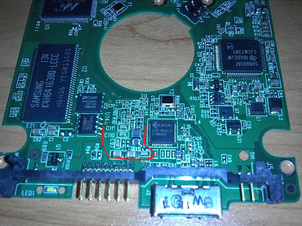

I got a 1TB My Passport 2.5" with usb 3.0 interface.
The drive is not spinning at all.
The customer said that he connected it to some PCI-EXP card and applied power and then it happened.
It seems like one or more PCB components are fried, similar to the TV's on a 3.5".

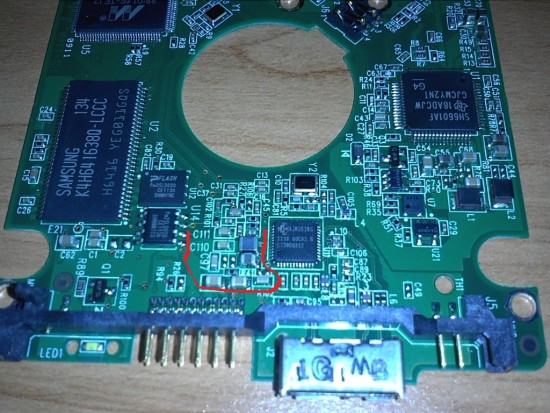

When i opened it up, there was a single burn mark on the Gray sponge attached to the PCB from the internal side.
If you look at the attached images, it was somewhere in the PCB-Internal.img inside the area marked with red but i can't say exactly which component.
Does these drives has TV's diodes?

I would think that those components in the red area would form part of a 1.2V switchmode Vcore supply for the JMS538S bridge IC. Capacitors don't normally produce any heat, so I would suspect that one of the resistors may have cooked. There could be a current sense resistor (Rnn) but I can't make out anything other than R41 or perhaps R10.
The voltages at coils L1 and L2 near the SH6601AF motor controller would probably be the Vcore and Vio supplies for the Marvell MCU. You could also measure the voltages on pin #8 of each of the flash memories at U12 and U14 (either +2.5V or +3.3V). The voltage on pin #1 of the SDRAM should be +2.5V.
I presume you would backup U12 and U14 before applying power.
As for a TVS diode or fuse, I can't recognise anything that would fit the bill.
