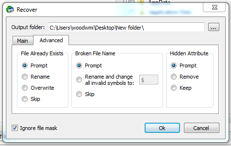

In R-Studio when you select ie tick the selected folders then click Recover Marked.
Then select the advanced tab
You can see in the picture Broken File Name options you can change to another symbol
Just run a few tests to get use to the updated R-Studio software
