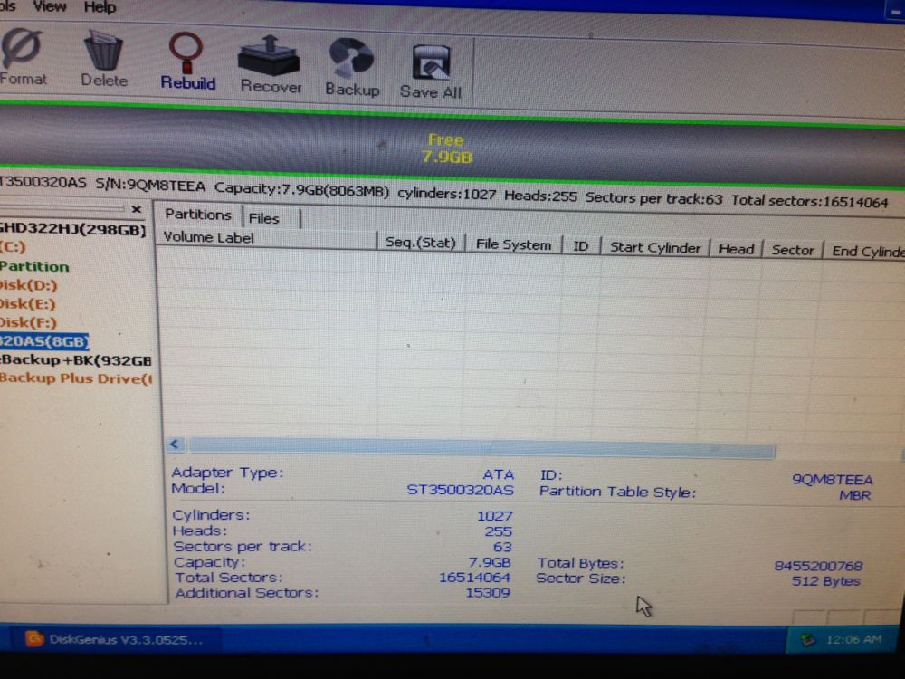

 Post subject: 500GB HD shows as 8GB HDD after power failure
PostPosted: March 14th, 2013, 12:47
Joined: March 14th, 2013, 12:37
Location: india

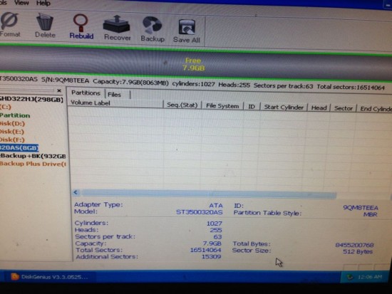

was seeing some movie sunddenly there was a power cut and after turning it on ......in the bios...HDD is dectected bt not the size...as there was data in the HDD...didnt do anything...so got a HDD (older one) installed XP.....installed getdataback....icare recovery.....diskgenius....n some more....the 500GB HD just shows as 8GB HDD in all the softwares......so wanna know how to recover the data...its seagate hard disc.....tried even seagate tools..bt no use.....plz help me out getting the data back :(

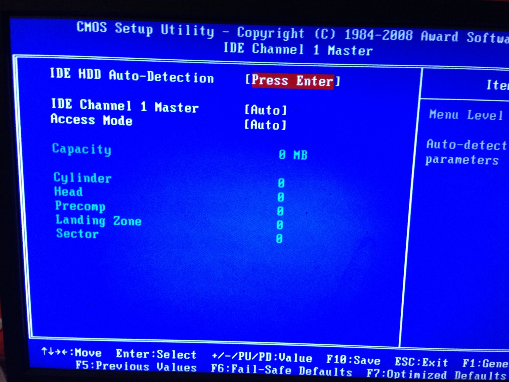

Please be clear:
What exactly is listed by the BIOS for this disk drive - you need to state the exact text which is displayed for the make & model information, and the exact size information which is shown. If you can take a photo of the BIOS disk setup screen showing this info, and attach that photo to your reply, then that would be good :)
Unfortunately for you, although your initial story is unclear in some key details, I suspect that your drive has suffered firmware damage (I have seen this before after a power cut) and on your own, you are unlikely to be able to recover the data yourself, as poehere said. The information I have asked you to supply above, will help to confirm or disprove this hypothesis.

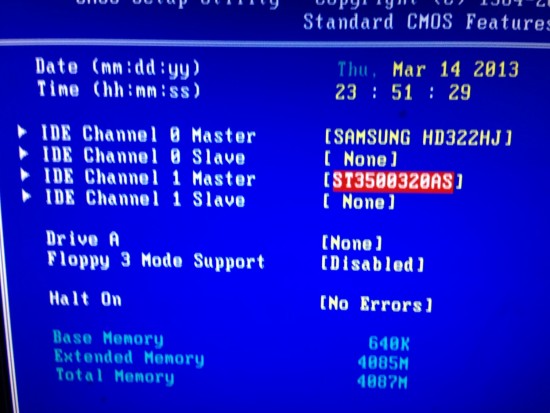

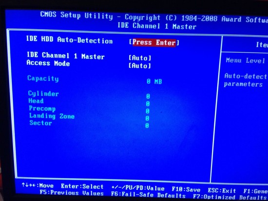

IDE channel 1 master is the one,,HDD detected..bt no size

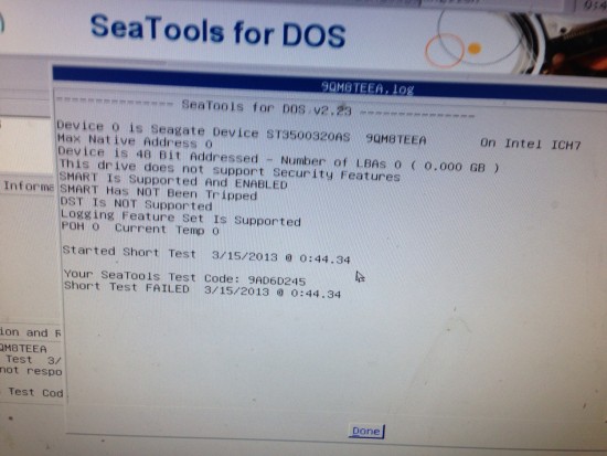

 Post subject: Re: 500GB HD shows as 8GB HDD after power failure
PostPosted: March 14th, 2013, 14:39
Location: india

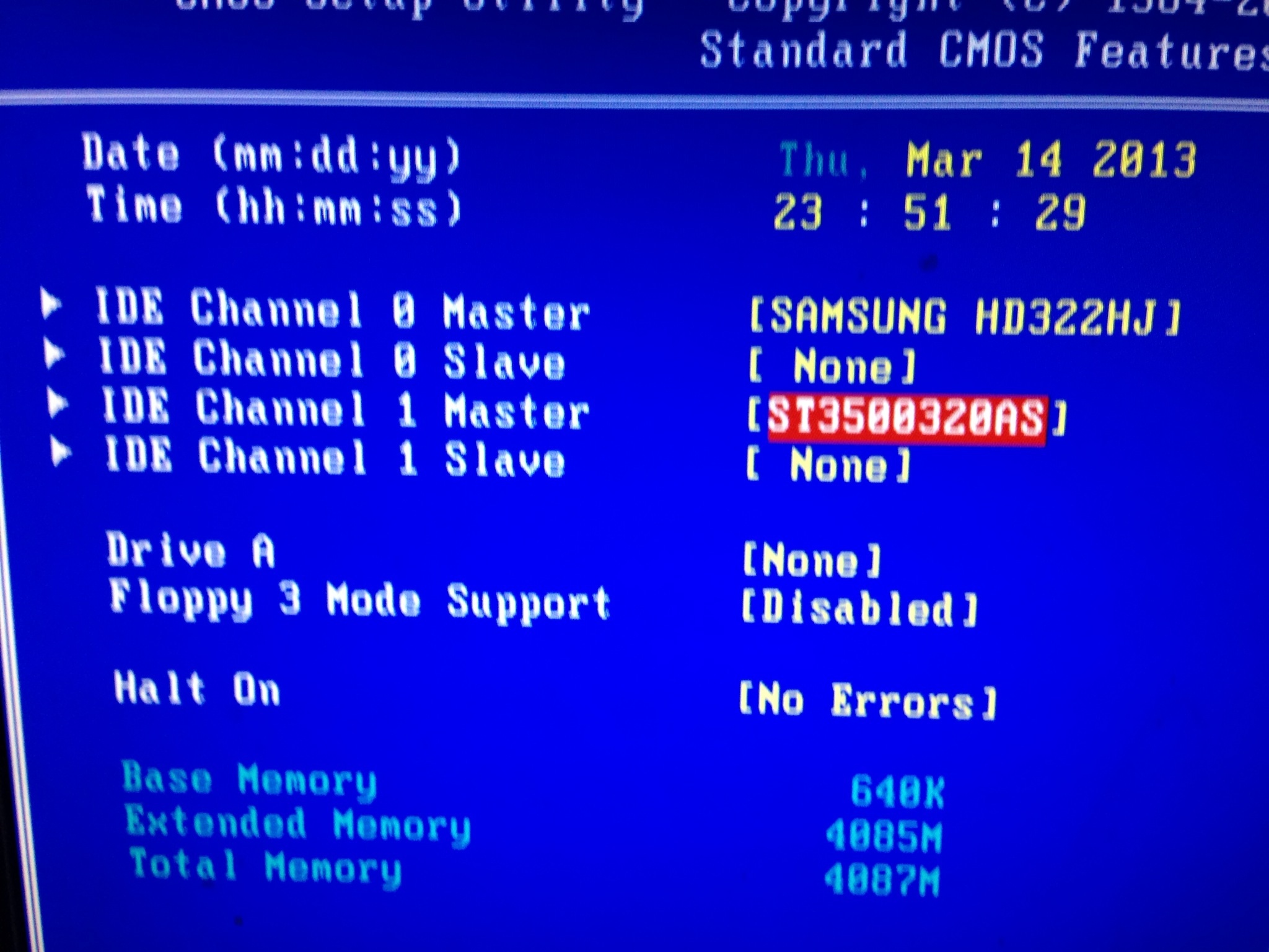

Thanks for the photos.
The BIOS is showing a drive size (capacity) ... of 0MB, which is important information. None of those software recovery utilities can recover from this type of problem, as this shows an internal drive problem (likely firmware-related).
There is something which a technically-skilled user could attempt, in order to do further diagnosis, but there are risks. Your next steps depend on your skills, the value of the data to you, and what risks you are prepared to take e.g. are you willing to risk making the data totally unrecoverable... If you explain more about your skills and the risks you want to take, then perhaps you will receive more suggestions.

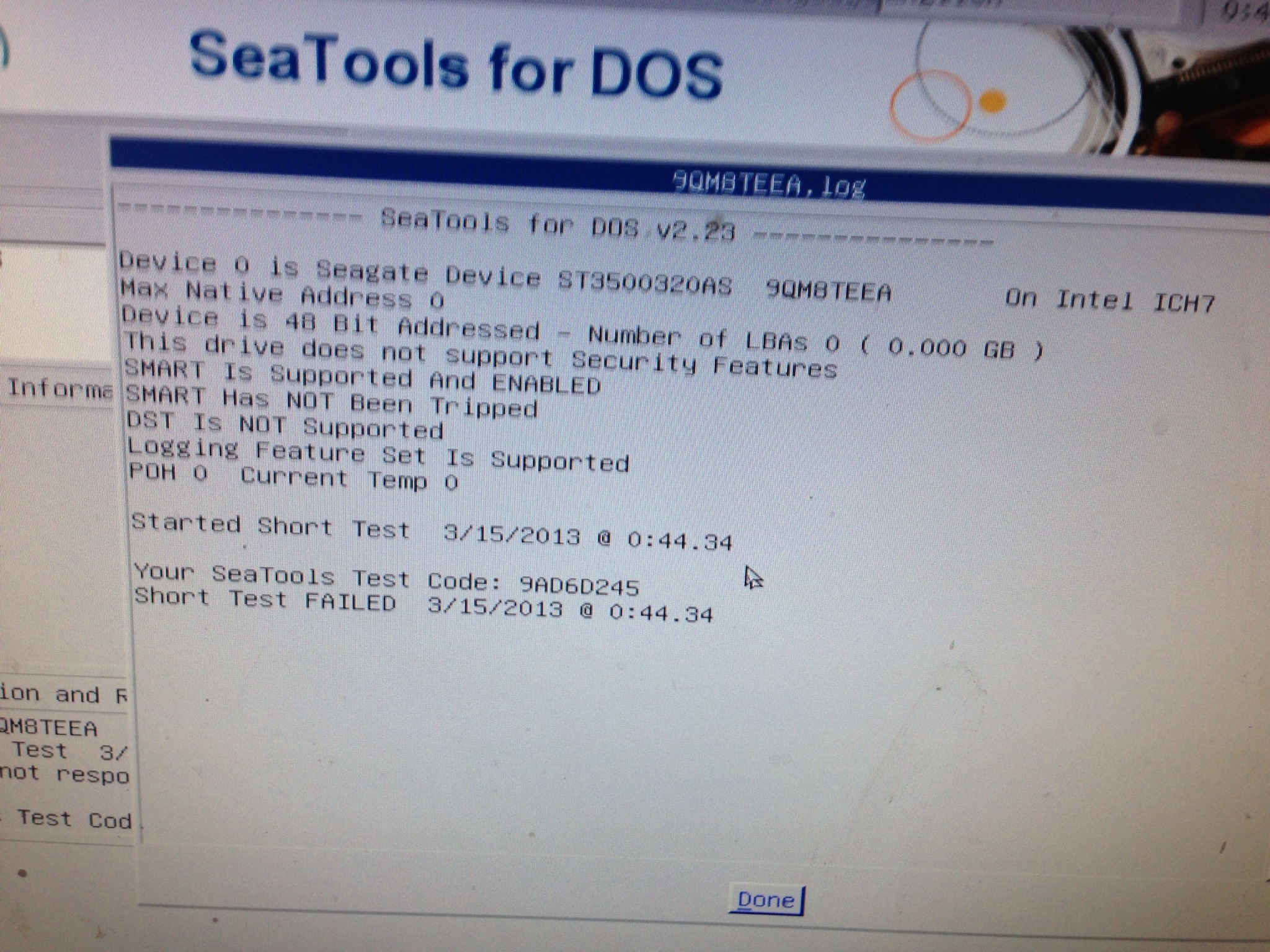

ya i will take the risk....i m ready....
