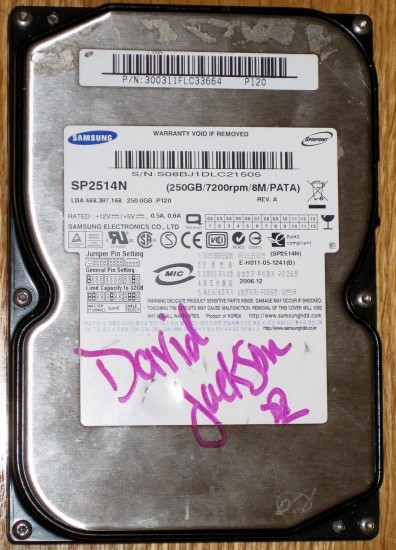

Hey everyone. I was given a Samsung SP2514N from an external Lacie enclosure. The person admitted to plugging in the wrong AC Adapter which caused the drive to break. It doesn't spin up or respond in any way. I posted a thread in the buy/sell section for a PCB. How are Samsungs when it comes to PCB replacement. Will any ol' SP2514N work or should I try to match part number / PCB numbers as well.
The information would be nice to have, but by no means is critical.

There is a certain chance the damage is limited to pcb - I repair the pcbs too. If drive click/no Id/id but doesn't read with new pcb it's time for a pro. Simple.

Samsungs are relatively sensitive to FW mismatch, so it is not easy to find a compatible pcb.

I mean it is not that dificult for me, but it might be dificult for one without a stock of samsungs and FW.
