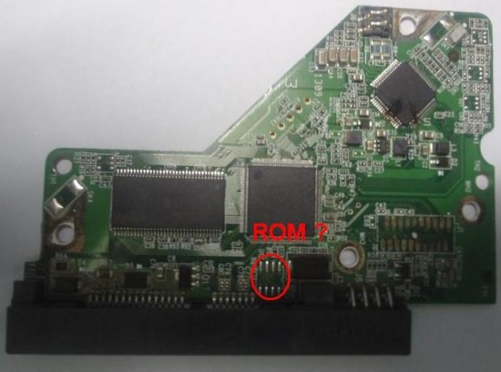

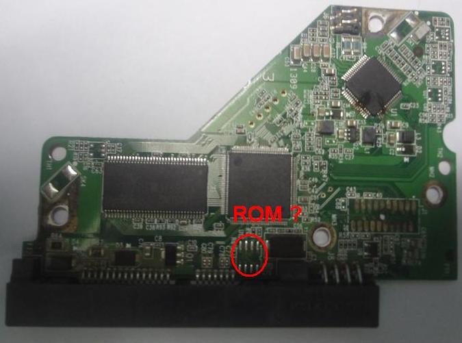

I'm not a pro but i have a bit of experience in hard drives recovery with faulty pcb and firmware issue.
As i know if the drive it totally silent the problem 99,9% is on faulty pcb or maybe something due the pcb rom.
As i can see in the pic, your original pcb doesn't have a rom chip so it means that the rom is embedded in the MCU, the donor pcb does have the rom chip or not?
The 1590 PCB doesn't have a ROM CHIP and the PCB that the engineer has swapped doesn't have a ROM chip too, but according to a previous experience if is was a ROM issue the heard at least will spine or produce any sound. and this is confirmed with my readings through forums. thank you alot for your Hint, I really wished that it is only a faulty PCB issue.

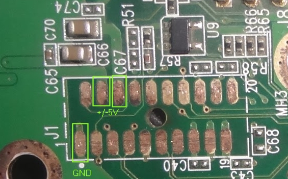

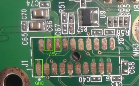

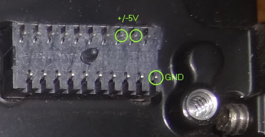

Your photo isn't clear, but the preamp's supply and ground pins should be around 2,4,6 IIRC.
You can determine the +5V and ground pins by testing for continuity with the SATA power connector.
The -5V pin can be located by testing for continuity with the anode (left side) of diode D2 below the SMOOTH chip. Once you have located these pins, then test for short circuits between ground and each of the +5V and -5V pins at the HDA.

Thank you again fzabkar pardon my Basic Electronic Knowledge I'm not a specialist at all and I'm not one of those who are insisting on DIY on every thing but this case is different as nearly 99% of the technicians here once the PCB swap didn't work they tell you nothing could be done and they consider the Hard DEAD. and that why I'm trying to make sure about the PCB and PreAmp and that's stuff so I can decide weather I will have to get a donor or only a an exact matching PCB. and then we can proceed with a specialist from there just to low the budget to something affordable. So please let me know know in a simple way in which pin can i put the Common cable to measure the HDA pins.
I'm attaching you two a bit clearer pictures for the HDD it self for the HDA pins and the PCB
have a look from This link for the PCB https://lh5.googleusercontent.com/oALiZqRhFW-J_ASz1ajvzVlY5sYXRJxGMbenaePoXTqsKYdkYiL0RSWNmcS6C_RwsM9s4UyNeSU
and for the HDA pins from this Link https://lh3.googleusercontent.com/3UV0P9FV14dqZvqFuUY2ztmOmKUOtk4Dhu_vitxBBNKCziqRW8hc6HazfGqfrn30Nwk7weQ9dyg

Here they are.

yes it is Shorted on both -/+5V Pins. So Now we can say its a Head Stack replacement Nothing else right ? Thank you.
Yes, it looks that way. It would explain why your donor board didn't spin up the drive.
