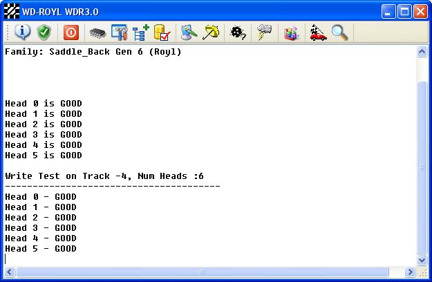

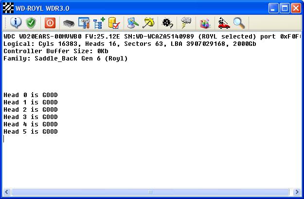

You can try the Solve "slow response" option in the WD utility
But Einstein is correct...
It could be Bad heads, a Faulty board,
Do a head test
But since all the modules are clean i would suspect it is the slow issue. second is a weak head

How can i find which head is damaged?

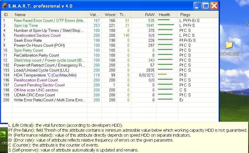

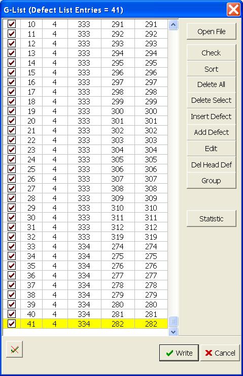

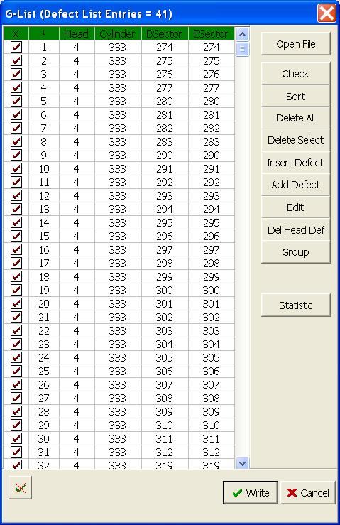

I tried also to reset G-list (which had 41 reallocated sectors) and smart, but nothing has changed.

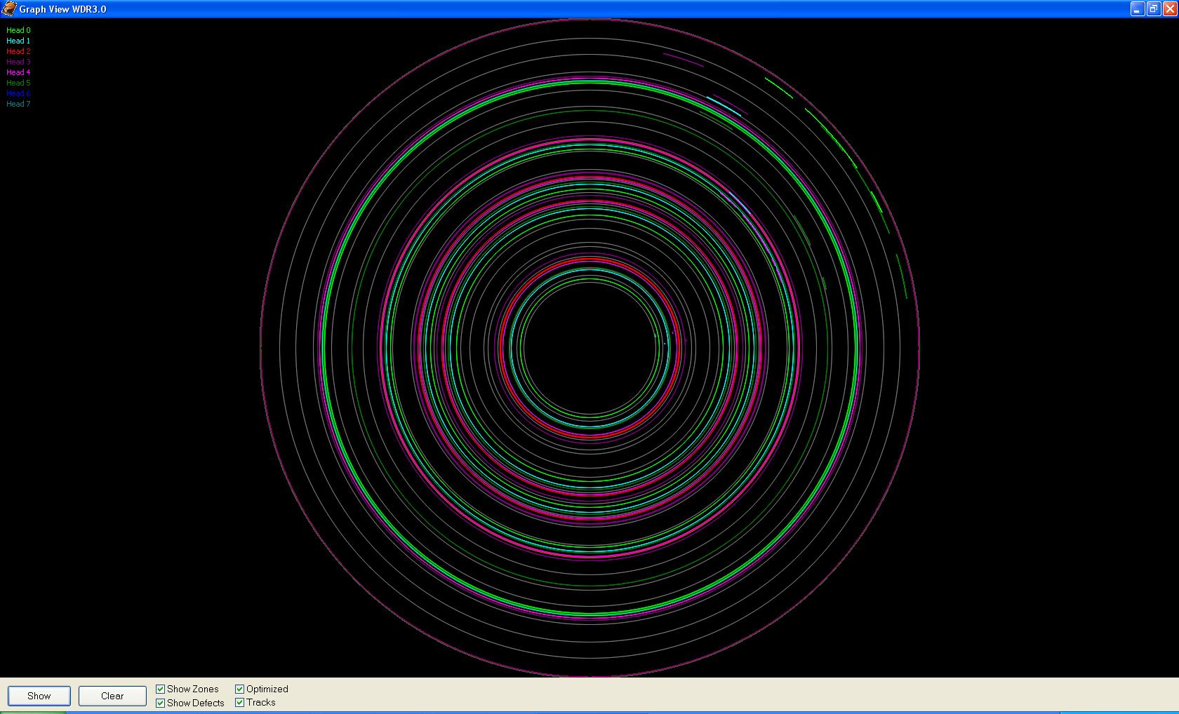

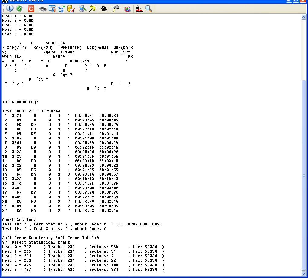

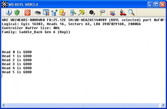

AMNF is always on when i start WDR
Defect P-list
Defects.ini [45.19 KiB]
Downloaded 990 times
IBI Common Log and SS defecs chart:
there is a head test in the wd utility. and so is the solve slows solution.
edit - i see your head test now...
try the solve slow solution

in PC-3000 there is a head test, but you already posted a test that shows as good. ( thow it may be wrong)
