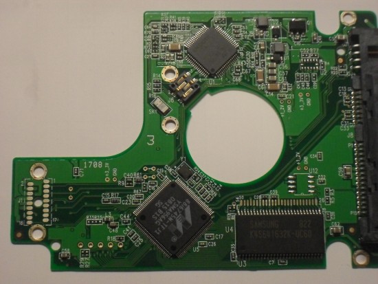

hello all ;
i have a wd2500bevt-22zct0 that doesn't spin up at all .
pcb# 2060-701499-000 rev a
pcb printed #2061-701449-500 AF
pcb has no burn spots and looks totally normal.
i have a donor drive (that has some problems reading SA , drive spins but not detected at all)
tried just to swap the pcbs , but the patient drive doesn't spin either (it produces a tiny sounds of ticking - not related to head assembly as it donut move at all)

any way to repair the broken pcb using the working pcb components ? to avoid the embended flash transfer ?

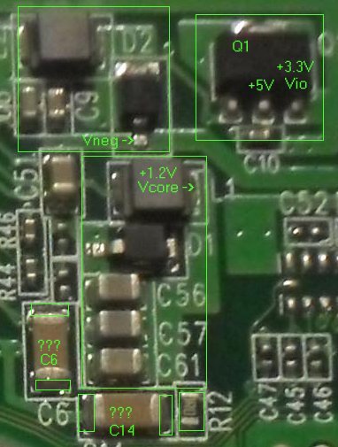

I suspect that the MCU is responsible for the low resistance reading on the Vcore supply. It also looks like the SMOOTH chip may be bad.
I would check the voltage at the anode of D2. I believe it is probably the negative supply (Vneg) for the preamp.
I would also confirm the voltages at Q1. I believe this is the Vio supply.
There are also two capacitors (C6 and C14) that look interesting, as well as R12 (1 ohm resistor). Could you measure the voltages at these points?

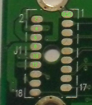

Could you also measure pins 2 - 12 at the preamp connector? I suspect that 10 and 12 may be the VCM pins, but the others are probably the supply voltages.

the measurments are :
Q1 : from left to right
5 **6.75** 4.25 volts
d2 : 0.14 V on the Vneg leg
L1: 0 v (shorted with GND)
c6 : from top to bottom 4.10 ***** 0V
c14:from left to right 4.6V *** 0 v
r12: 0 V from two sides

on the working pcb , readings are
4 **5.10 ***3.25 volts
d2 : 3.05 V on the Vneg leg
L1: 1.4 v
c6 : from top to bottom 8.2 ***** 0V
c14:from left to right 4.75V *** 0 v

The readings for Q1 look wrong. The centre pin should be connected to the +5V SATA pins. Either your PSU is BAD or your multimeter is flaky.
L1 cannot be shorted to ground. You previously measured 24 ohms. Instead it appears that the SMOOTH chip is not generating the PWM pulses for the Vcore supply.
Vneg is also generated by the SMOOTH chip. Once again it appears that the PWM pulses aren't there.
Therefore ISTM that your motor controller is dead.

Do you mean -3.05V for Vneg?
If the voltage on C6 is correct, then maybe it's a charge pump capacitor. This would then support my previous diagnosis that the SMOOTH chip is dead, ie a voltage of 4V would imply that the charge pump on your original PCB is not working.
The voltage of 1.4V seems high. AFAICT it should be +1.2V. Is that your multimeter playing up?

As for a dead preamp, if you could measure the voltages at the preamp connector, then we could locate its supply pins. Then we could test for shorts right at the HSA.
yes ... working pcb reading -3.05 v while broken one reading +0.12v V
smooth chip is bad then ... will look for a soldering pro < and see if he can move the smooth chip from one to another ...
