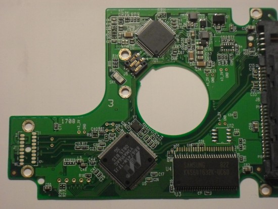

hello all ;
i have a wd2500bevt-22zct0 that doesn't spin up at all .
pcb# 2060-701499-000 rev a
pcb printed #2061-701449-500 AF
pcb has no burn spots and looks totally normal.
i have a donor drive (that has some problems reading SA , drive spins but not detected at all)
tried just to swap the pcbs , but the patient drive doesn't spin either (it produces a tiny sounds of ticking - not related to head assembly as it donut move at all)

any way to repair the broken pcb using the working pcb components ? to avoid the embended flash transfer ?

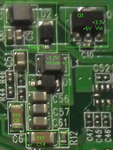

What is the resistance between the +1.2V test point and GND? Is it 24 ohm?
What is the resistance between the +3.3V test point and GND?
What voltages do you measure at these points? Don't bother powering up the board if the +3.3V supply is shorted.

I suspect that the MCU is responsible for the low resistance reading on the Vcore supply. It also looks like the SMOOTH chip may be bad.
I would check the voltage at the anode of D2. I believe it is probably the negative supply (Vneg) for the preamp.
I would also confirm the voltages at Q1. I believe this is the Vio supply.
There are also two capacitors (C6 and C14) that look interesting, as well as R12 (1 ohm resistor). Could you measure the voltages at these points?

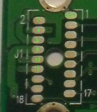

Could you also measure pins 2 - 12 at the preamp connector? I suspect that 10 and 12 may be the VCM pins, but the others are probably the supply voltages.
If you could compare the voltages between your two PCBs, then that would help a lot.

Spildit wrote:- Place the donnor PCB (the one that spins the drive with SA issues) on the patient drive and INSULATE the contacts to the head stack (J1) with a piece of plastic bag. If the drive spins up that way then Pre-Amp is shorted and prevents the PCB from even spinning it. If the drive still doesn't spin then either spindle is damaged or heads are stuck.

the measurments are :
Q1 : from left to right
5 **6.75** 4.25 volts
d2 : 0.14 V on the Vneg leg
L1: 0 v (shorted with GND)
c6 : from top to bottom 4.10 ***** 0V
c14:from left to right 4.6V *** 0 v
r12: 0 V from two sides
thank you again for helping ...

raven4d wrote:Q1 : from left to right
The readings for Q1 look wrong. The centre pin should be connected to the +5V SATA pins. Either your PSU is BAD or your multimeter is flaky.
L1 cannot be shorted to ground. You previously measured 24 ohms. Instead it appears that the SMOOTH chip is not generating the PWM pulses for the Vcore supply.
Vneg is also generated by the SMOOTH chip. Once again it appears that the PWM pulses aren't there.
Therefore ISTM that your motor controller is dead.

raven4d wrote:on the working pcb , readings are
4 **5.10 ***3.25 volts
d2 : 3.05 V on the Vneg leg
L1: 1.4 v
c6 : from top to bottom 8.2 ***** 0V
c14:from left to right 4.75V *** 0 v
Do you mean -3.05V for Vneg?
If the voltage on C6 is correct, then maybe it's a charge pump capacitor. This would then support my previous diagnosis that the SMOOTH chip is dead, ie a voltage of 4V would imply that the charge pump on your original PCB is not working.
The voltage of 1.4V seems high. AFAICT it should be +1.2V. Is that your multimeter playing up?

patient pcb Q1 readings: from left to right
3.95 **5.12 ***3.22 volts

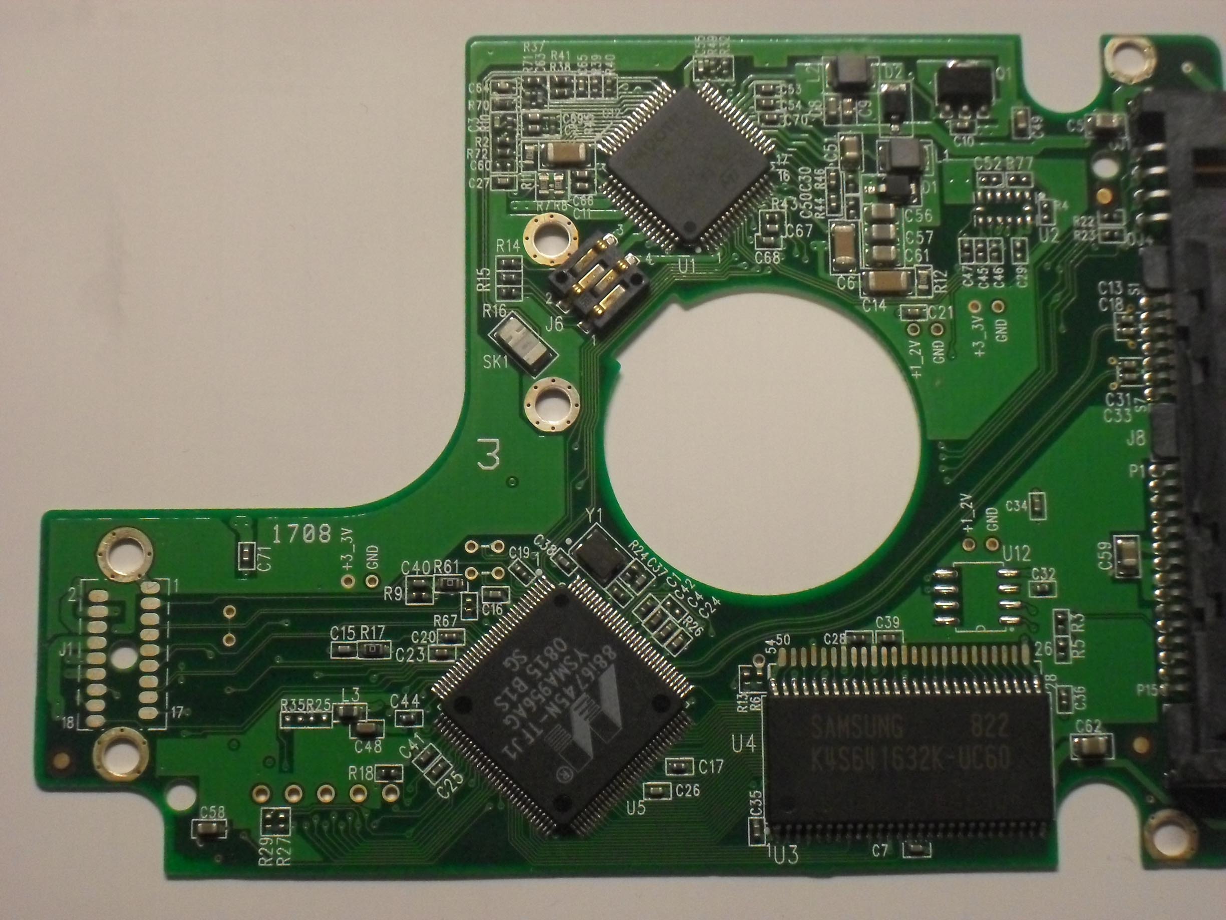

ISTM that you won't be able to retrieve your ROM from the patient PCB. Even if you could replace the SMOOTH chip, it could still be that the MCU is dead.
As for a dead preamp, if you could measure the voltages at the preamp connector, then we could locate its supply pins. Then we could test for shorts right at the HSA.
yes ... working pcb reading -3.05 v while broken one reading +0.12v V
smooth chip is bad then ... will look for a soldering pro < and see if he can move the smooth chip from one to another ...

Re: wd2500bevt-22zct0 doesn't spin
April 12th, 2013, 17:59
raven4d wrote:smooth chip is bad then ... will look for a soldering pro < and see if he can move the smooth chip from one to another ...
I still think the MCU is also dead. A reading of 24 ohms is much lower than your donor PCB. I think it is unlikely that this low reading is due to the SMOOTH chip. The other thing that leads me to suspect the MCU is your resistance reading for C1.
