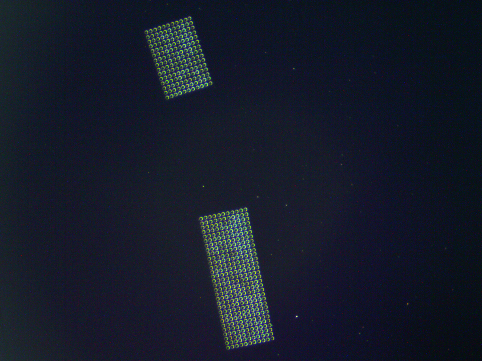

Was doing some dead drive autopsying on a:
Seagate Barricuda 2000GB
ST2000DM001
9YN164-302
Had a massive amount of trails, and stiction marks on every platter, for the first time i got to try out my new microscope on some stiction marks, then i noticed something freaky.
The stiction mark appeared to be a series or tiny circles at max (90X) zoom. :shock: :shock: :shock:
Circles? Why circles? Can anyone explain this strange phenomena to me?

 Post subject: Patterned media (bit-patterned media, BPM) under microscope
PostPosted: June 29th, 2015, 5:23
Posts: 456
This drive uses patterned media (aka BPM).

Fascinating! So each circle is a bit.

And this pattern on the posted picture is not a stiction mark.

Enlighten me. What do we call it?

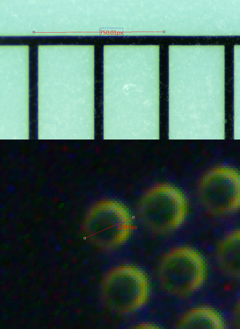

After fiddling around with the scopes software i was able to get pixel measurements, at max (90x) zoom.
1mm at MAX zoom = ~750px
1 circle at MAX zoom = ~23px
23 / 750 * 100 = ~0.0306mm
or ~30.66 μm (micrometers)
or ~30666.6 nm (nanometres)
So yes these circles are about 3,000 times larger than the '10nm' quoted from that toshiba link. (If my math isn't off.)

CleanestRoom wrote:
If anyone else is wondering what microscope i used, it was an Amscope:
Basically duplicating my PM to CleanestRoom here, but anyway:
Yes, these dots aren't magnetic grain for sure.
I probably should sleep more, but I asked CleanestRoom about the microscope as I thought he got his hands on some sexy equipment and decided to (ab)use it properly :)
This is an amateur judgement, but I believe optical microscopes can't produce such a detailed picture of the grain on a modern platter due to their diffractional limit.

Using just the measurable parameters (max transfer rate, outside diameter, RPM), we can arrive at an upper limit for the size of a "bit".
(210 MB/s) / (7200 per minute) / (3.5 inch x pi) = 50 bits per um = 20 nm per bit
http://www.google.com/search?q=210+MB%2 ... its+per+um
Obviously the size would be lower if we were to account for the "overhead" bits.
According to the product manual (http://www.seagate.com/staticfiles/supp ... 686584.pdf), the maximum recording density is 1807kFCI (kilo flux changes per inch).
That works out to 13.6 nm per flux change.
