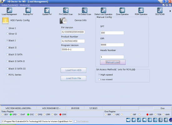

Hi Friends,
I need firmware for
WD400BB-00FJAO
DCM: HSCHCTJAH
PCB: 2060-701335-003
how can solve this problem ?

If it is clicking, then 99% a physical issue (e.g. heads)
 Post subject: Re: CLICKING NOISE
PostPosted: May 14th, 2013, 7:03
Firmware is not needed to resolve case.
Ensure PCB is not the problem first.
Then move onto other tests.

-FJA- can not be ( UNICORN )
PostPosted: May 15th, 2013, 10:16
Joined: May 6th, 2013, 2:48
Posts: 84
what do you mean (-FJA- can not be ( UNICORN )?
PostPosted: May 15th, 2013, 10:22
Posts: 1729
WD400BB-00FJA0 must be (MAMMOTH) NOT (UNICORN).

i agree with unknown 00fjao is mamoth family not unicorn
PostPosted: May 15th, 2013, 18:49
Posts: 17232
A Google search turns up 2060-001130 as the PCB number for the WD400BB-00FJA0.
It's easy enough to compare the date code on the label against the date codes on the PCB and on the chips.
PostPosted: May 15th, 2013, 20:50
Posts: 17232
Why do you have a SATA PCB on a PATA drive?
