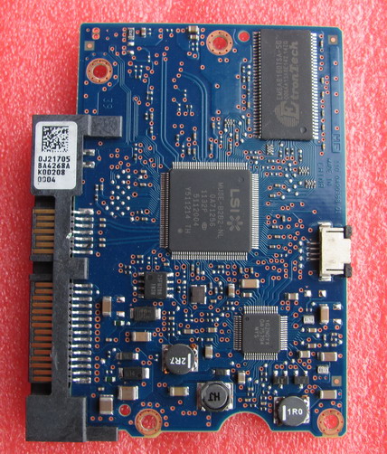

PostPosted: June 21st, 2013, 15:33
Posts: 17335
If you upload a detailed photo of the PCB, I could help you locate the supply and signal pins for the preamp. We could then compare your two drives.

See the pic
http://www.hddzone.com/index.php?main_p ... ge&pID=356
http://www.drivestar.biz/hitachi-0a71256-p-2096.html

 Post subject: Re: NO SPIN - Hitachi CLA3
PostPosted: June 22nd, 2013, 7:25
Posts: 17335
shahij wrote:
Those are two different boards. I need a detailed photo. A quick analysis will take only 1 minute and will tell you whether you really do have a preamp problem.
http://www.drivestar.biz/images/pcb_ht/OA71256.jpg
http://www.hddzone.com/images/HTS10033.jpg

sorry, i gave you 2 different. 1 wrong and another right pcb link.
here is the right no...
http://www.drivestar.biz/hitachi-0a71256-p-289.html
