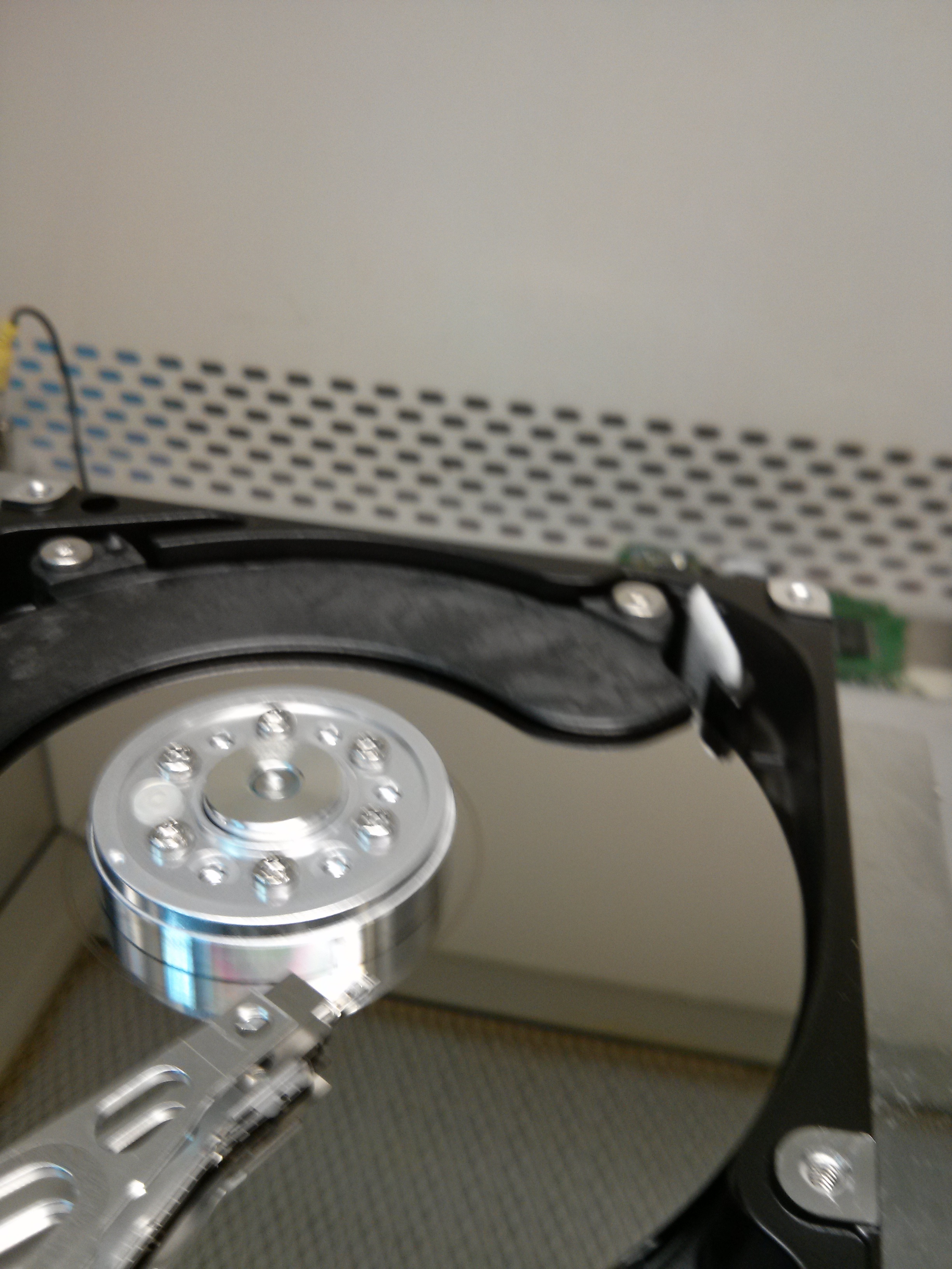

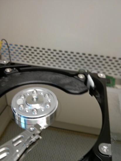

Hi
I have a drive with these scratches.
Does it worth to swap heads?? Or will they be killed on the moment?
ACELab partner
 Post subject: Re: Samsung HD103SI
PostPosted: July 1st, 2013, 7:19
Posts: 1752
They will be killed when they reach that area.
PostPosted: July 1st, 2013, 10:43
Posts: 3670
Rarely works. More headache than success.
PostPosted: July 1st, 2013, 12:57
Have had limited success by installing "limiters" but not great.
I wouldn't offer free parts on this recovery, I would ask the client to pay for 2 or 3 donor drives upfront. If they refuse, then the data cannot be so important and let them take it somewhere else.
PostPosted: July 1st, 2013, 15:15
I have some solutions but the outcome is unknown and in such scenario I would ask diagnose fee and parts upfront.
