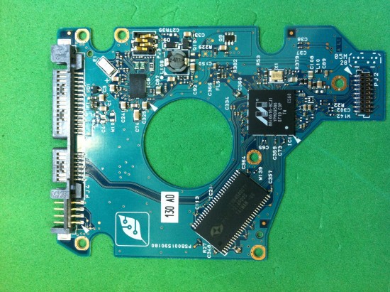

 Post subject: PCB SWAPPING FOR TOSHIBA MK2035GSS
PostPosted: July 6th, 2013, 5:35
Joined: July 6th, 2013, 5:09
i need to recover my data by swapping the failed PCB board of my TOSHIBA MK2035GSS, I have managed to get an identical working pcb, however a simple swapping didn't work, i read somewhere that the firmware info are imbedded somehow that cannot be simply swapped,
my question is:
if i swapped the main controller (HAVING THE CODE 2Y64S40CTP ON IT) from the original pcb to the new one, would it work? is there any tips? i can take it to any electronic repair workshops, they have special machines to remove circuit board and solder new ones, please someone help me in this, i dont want to risk damaging the working pcb or permanently destroy the original pcb for nothing, attached the photo for the pcb
That the Ram memory, you need to move the other one with a big M on it...Marvell cpu.
Or try to repair the original board.

 Post subject: Re: PCB SWAPPING FOR TOSHIBA MK2035GSS
PostPosted: July 6th, 2013, 6:07
Posts: 17393
Check fuse F1 near the SATA power connector.
Also check diode D1.
If you are lucky, a repair might cost you nothing.
PostPosted: July 6th, 2013, 7:10
Posts: 3670
Given the data is important...
Best suggestion I can give is to find a way to fix the PCB, ideally someone highly competent to do so.
There is a high risk of losing data if the PCB gets damaged as the "M" chip is sort of difficult to swap. All of the adaptive data for this particular drive is in that chip, so damaging it = no recovery.
Think twice before doing anything and if not sure, always practice or have the individual doing the work practice.
PostPosted: July 6th, 2013, 8:25
Joined: July 21st, 2010, 5:03
Posts: 247
Location: Norfolk, UK
F1 is pretty burnt, and one of the legs on D1 is discoloured.... you may be lucky and this will be simple fix (unless they've got this way after a failed attempt at a repair)....But if you have any doubts in your ability to diagnose and fix these, then seek a pro who can do it for you.....
http://www.eadr.co.uk
PostPosted: July 7th, 2013, 8:29
thank you guys, i really appreciate your help,
the damage happened when i plugged the drive into an enclosure used for 3.5 hdd, it seems it received a 12 volts instead of 5 volts, i have spoiled 2 hard drive actually (akhhh stupid me)
Someone tried to repairs it, he told me when he bypassed the diod (or the fuse) an ic got heat, therefore he didn't continue, now i dont know how to proceed, data is there and cant touch!
PostPosted: July 7th, 2013, 9:36
Bingo... !
All that shouldn't happen, happened.
It is still possible to get back data (at this point being cautious about the outcome) but generally speaking if there was a range (cost) I think if the pcb is destroyed the cost is now 2 to 5x...
PostPosted: July 7th, 2013, 15:46
Posts: 17393
That's bad luck. :-(
As a DIY-er you did all you could. Unfortunately the diode did not succeed in limiting the damage to itself. You can take heart in the fact that the damage to the IC occurred during the overvoltage -- it was not a consequence of your repair attempt.
Which chip is overheating? Is it the motor controller? Marvell MCU? I suspect the former.
Do you have a multimeter? If so, we can measure the resistances on the Vio and Vcore supplies. That may tell us where the damage occurred.
As for shorting the fuse, that's all that a DIY-er could reasonably be expected to do. If you had indulged me, I would have helped you to locate the short circuited IC before you powered on the board. But that would have changed nothing. In any case you are now no worse off than prior to your DIY repair attempt. Believe me, I have many years of chip-level troubleshooting experience in microprocessor based boards in mainframe computer systems where the data was valued in millions of dollars. Don't beat yourself up about it.

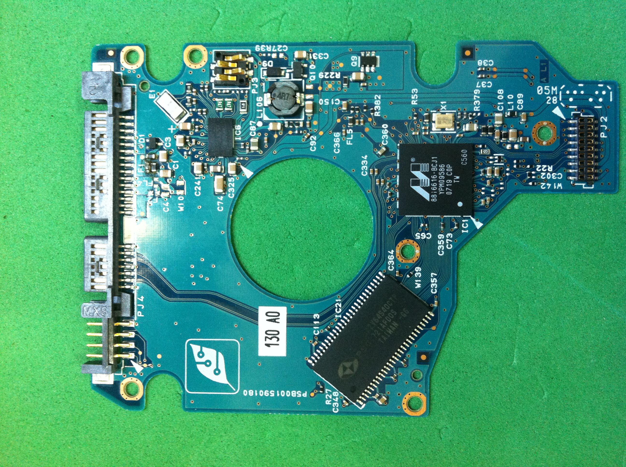

PostPosted: July 9th, 2013, 13:20
Joined: July 2nd, 2011, 14:16
Posts: 463
The repair might be okay at a data recovery, all the chips look fine and other components, I think the overcurrent buggered all the safety circuits and there are some missing too. Hopefully it will not cost that much, but you will need a DR company to look at the board and replace some of the components. Looking at the pic it looks like F1 IS Completely buggered, the component next to it looked like its fried too, the one above it dead too and F2 is missing C4 and W10 all missing too. I don't know if something should be in FL4 slot too.
I would not trust C1 and C3, and that component at D1 looks questionable.
I believe some fuses lower the current a little too, when I bypassed such a fuse a regulator would get uncomferlby hot when it did not before. I just attached a little bit of metal to the top and made it transfer the heat to the main drive frame, worked okay for a few years.
PostPosted: July 9th, 2013, 13:53
Joined: May 6th, 2008, 22:53
Posts: 2138
FYI no, those components are not "missing" (as in "needing to be fitted") - they are deliberately not populated. A new drive of the same type will also not have those components fitted.
