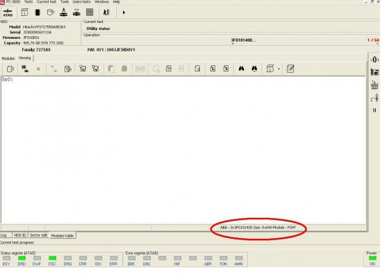

Any way to Write sectors in IBM-ARM Architecture if secs in SA badly
I have a HTS727550A9E330 with PSHT copy1 badly, i tryed to write form PSHT copy0 witout success.
Any way
Thanks in advanced

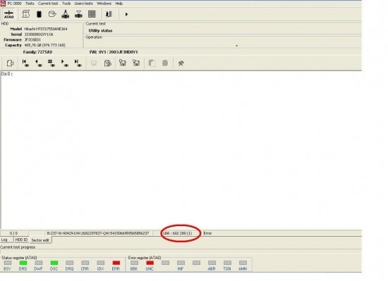

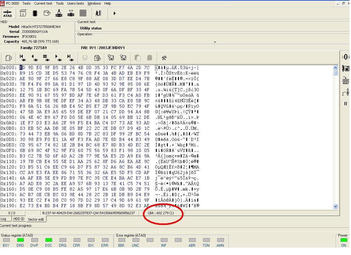

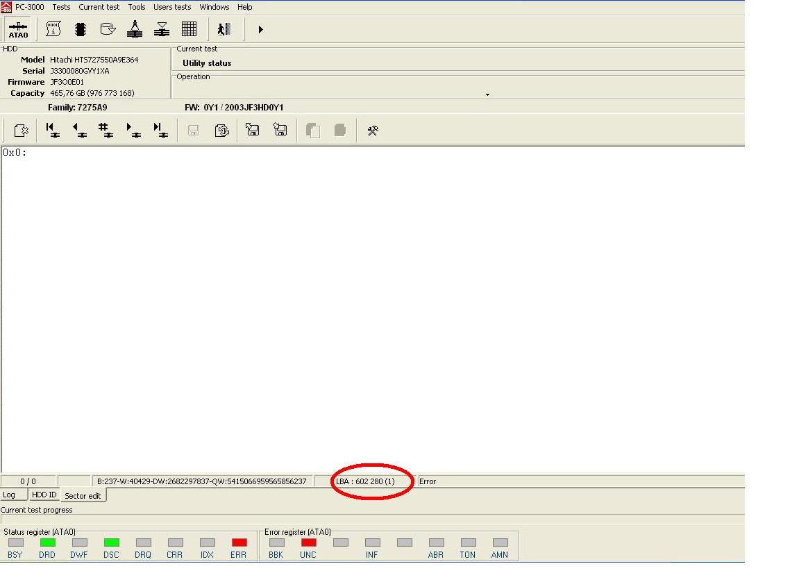

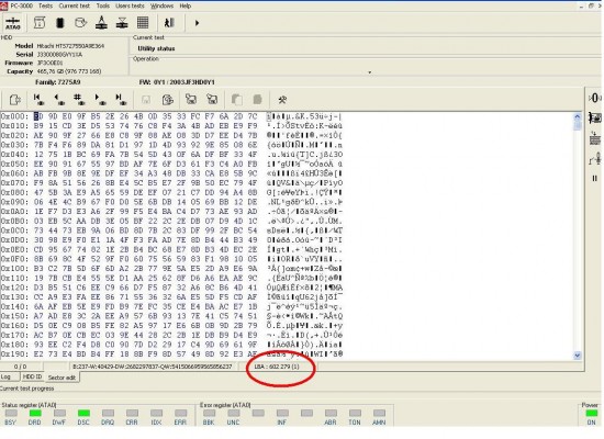

Yes, i have access to Secs but i can only access from sec=0 to to sec=602279
them i get error reading secs.

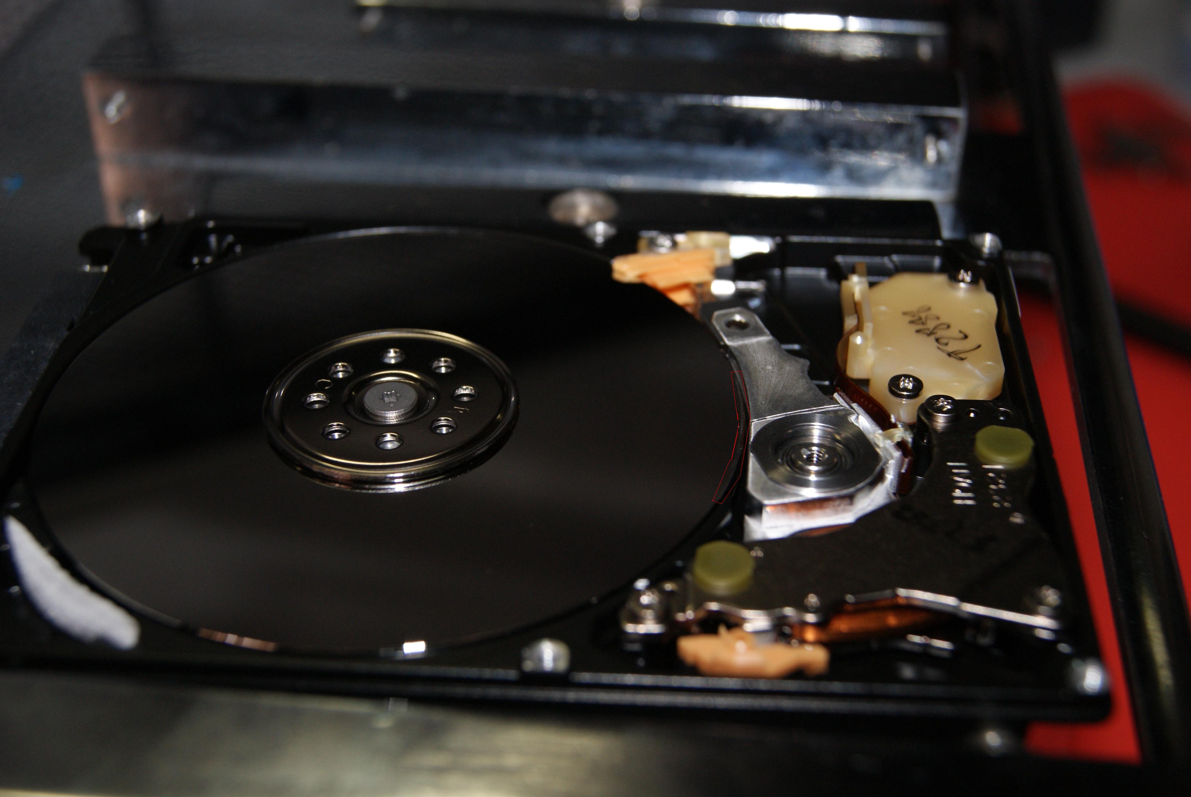

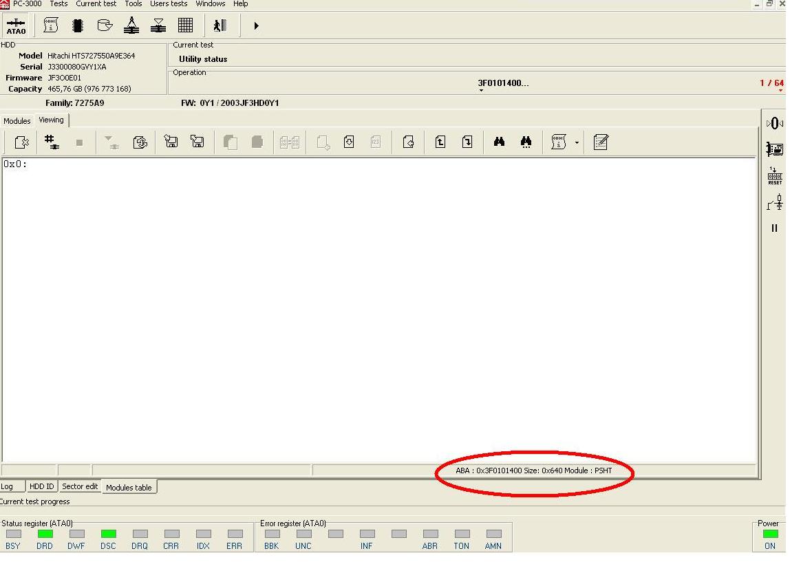

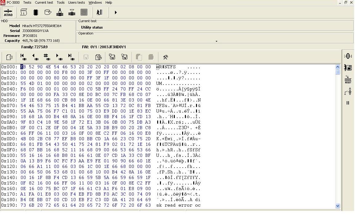

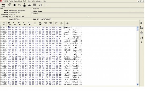

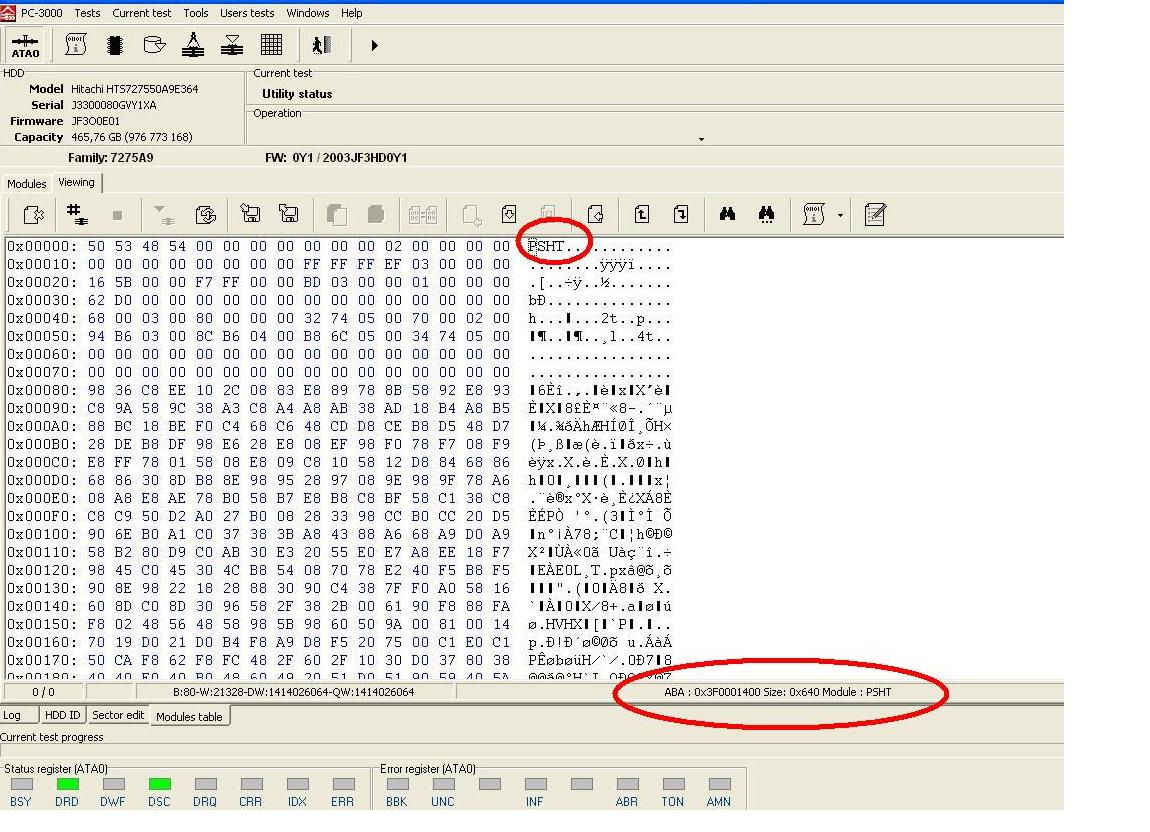

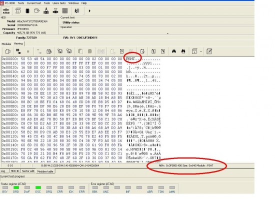

i atach pics about case

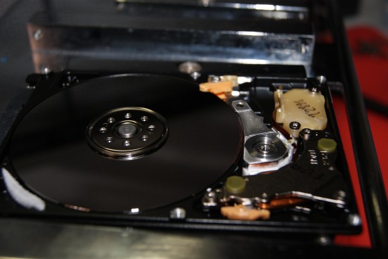

Needs a head swap, as at least h1 is toast.
Suggest not powering on as is. These are easily prone to further damage when trying to image working heads first. Got one right now. Wasting parts on it...

before had heads problem, but now is head exchanged.
I think problem is about FW

I am trying to read secs to 10.000.000 but no success in any of them in advanced to sec=602279.
If them problem is any head must i can read other secs areas.

This is new ARM hitachi drive. Problem can be solved, but, i am afraid, you have to send it.
If you check PSHT module in RAM , it is empty.

Hi DR-Kiev.
If this is a question:
Yes, the PSHT module in RAM is empty

i atach log From PC3k:
Test : Resource master copy creation in DB
Folder: /727550/Hitachi HTS727550A9E364 JF3O0E01 J3300080GVY1XA
ROM reading............................. : Ok
Reading ROM to DB (ROM/ROM.bin)....................................... : Ok
Reading NV-RAM to DB (NV-RAM/...)...
NV-RAM.nvr...
NV-RAM_0.nvr...
NV-RAM_1.nvr...
NV-RAM_2.nvr...
NV-RAM_3.nvr...
NV-RAM_4.nvr...
Reading NV-RAM to DB (NV-RAM/...)..................................... : Ok
Off-line start resources
Main modules table.................................................... : Ok
"Open" modules table.................................................. : Ok
Reading modules to DB
Folder: <root>/Hitachi-IBM-ARM Utility/727550/Hitachi HTS727550A9E364 JF3O0E01 J3300080GVY1XA/Modules
Module RPSH Copy 0...................... : Ok
Module RPSH Copy 1...................... : Ok
Module USAG Copy 0...................... : Ok
Module USAG Copy 1...................... : Ok
Module RAMI Copy 0...................... : Ok
Module RAMI Copy 1...................... : Ok
Module RAM0 Copy 0...................... : Ok
Module RAM0 Copy 1...................... : Ok
Module PSHT Copy 0...................... : Ok
[color=#FF0000]Error transferring command data: Reading SA [0x3F0101400, 0x40]
HDD Data timeout
Error executing command: Reading SA [0x3F0101401, 0x1]
Device error detected (UNC)
Error................................................................. : Error executing command: Reading SA [0x3F0101401, 0x1]
Loading : PSHT, P-List module......................................... : Error
Module PSHT Copy 1...................... : Error[/color]

Then in red we can see mods with errors:
PSHT Copy 1. - P-List
Maybe not needed because we have "PSHT Copy0" fine.
DMP1 -Unknown module
I do not know info about this module, maybenot important
WRT2 - Marker at head 2.
maybe here is the problem
What you think?

I am testing
this is the head map of HDD.
HEad Number:
3
HEadMap:
00 01 02 0F 0F 0F 0F 0F 0F 0F
 Post subject: Re: HITACHI HTS727550A9E364 Bad Secs in SA writing problems
PostPosted: July 12th, 2013, 10:52
Posts: 1752
As Dr. Kiev told you, I don't think no one will tell you how to do it.
Specially as that is something that only a few people know about yet.
PostPosted: July 12th, 2013, 10:53
Posts: 811
Location: World
but if i change HEAD map:
HEad Number:
1
HEadMap:
00 0f 0f 0F 0F 0F 0F 0F 0F 0F
i can acess from sec=0 to 195551
Posts: 811
Location: World
HEad Number:
2
HeadMap:
00 01 0F 0F 0F 0F 0F 0F 0F 0F
i can acess from sec=0 to 418751
PostPosted: July 12th, 2013, 10:54
Posts: 811
Location: World
HEad Number:
3
HeadMap:
i can acess from sec=0 to 602279

I can see to problems to write secs.
I tryed to write secs in User Area and i can not.
What you think? Heads problems? or other Problem?

i update case with a pic
what you think about lined in red Area? scrached?
