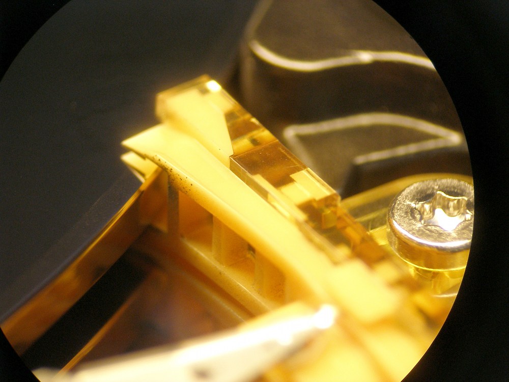

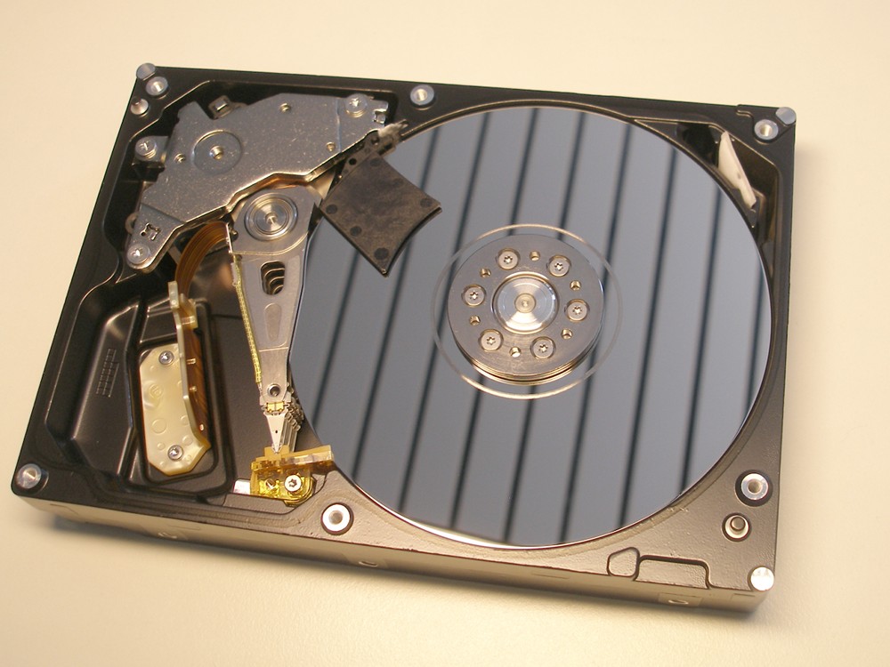

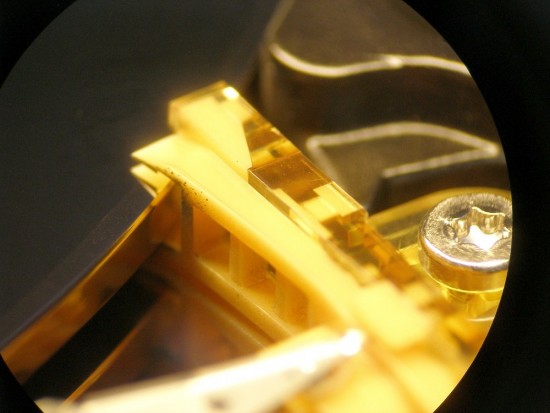

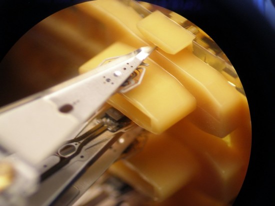

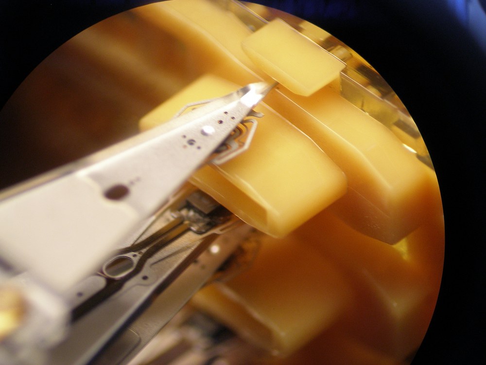

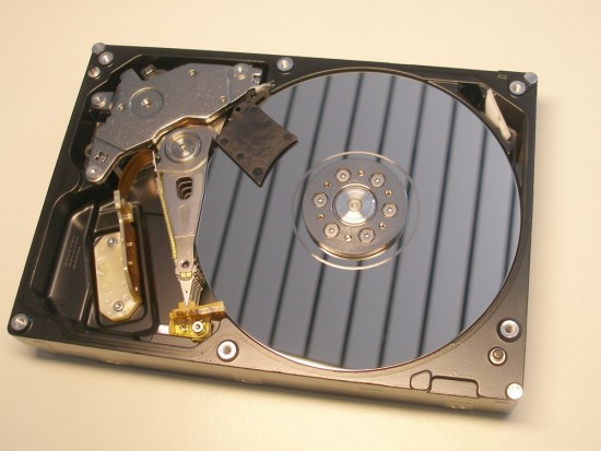

Here are the photos of the disk.
Maybe I expressed myself not very clearly: I am looking for a DR Lab that already DID such cases before, has appropriate devices, knowhow and had success.
File comment: Heads
File comment: Ramp
File comment: Disk
 Post subject: Re: Hitachi 2TB Scratched
PostPosted: July 17th, 2013, 8:00
One thing is expectations another is real life. I had success, but every case is different so it may not apply to this one. Not in your favor : already opened drive, contamination, extensive damage.
