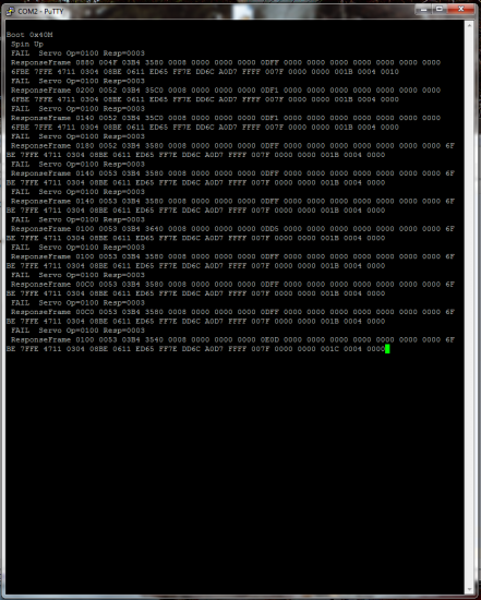

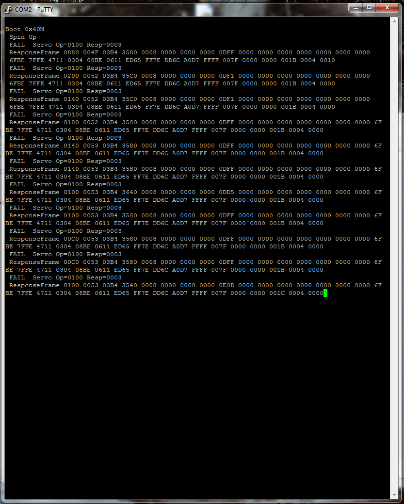

Hi! There was the exact same problem with the hard drive. Tell me, what can it be? Attach 2 files, the sound of the disc and a screenshot of the terminal.
Sound: https://www.dropbox.com/s/ijwen8pbo8fn2ax/audio.mp3
 Post subject: Re: ST2000DM001 Errors - Help Needed
PostPosted: August 1st, 2013, 14:28
Same diagnose.
No DIY solution.

Location: Chicago
Looks like dead heads (maybe accompanied with MD) on both drives
Can be PCB but very unlikely
