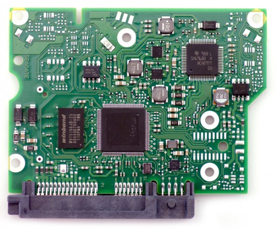

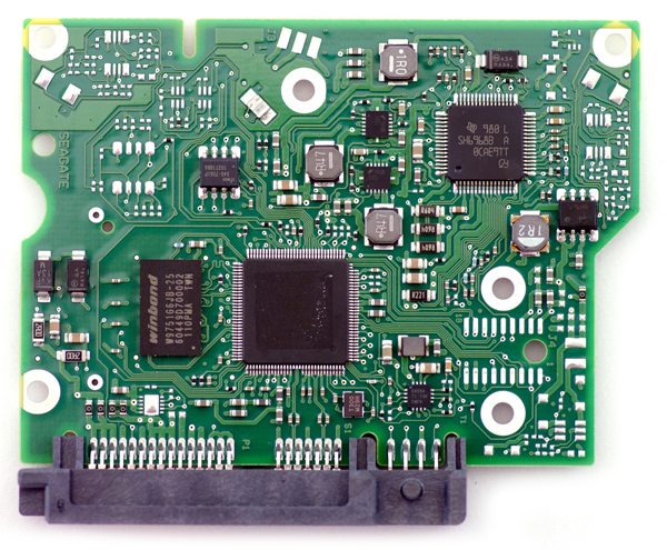

is this your PCB?
 Post subject: Re: Seagate ST3000DM001 motor starts then stops
PostPosted: April 11th, 2013, 6:12
Joined: November 13th, 2009, 4:39
Posts: 51
Location: Panama
Yes this is the same pcb...
PostPosted: April 11th, 2013, 6:46
Posts: 17230
AFAICT the read and write differential pairs are pins 12 & 14, and 16 & 18 of the preamp connector. I don't know which is which, though. You can identify them because each pair of traces runs side by side and is of equal length. They also terminate at the preamp pins in a characteristic "Y" pattern.
