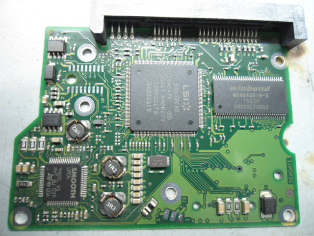

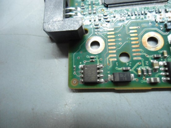

 Post subject: Rom chip
PostPosted: May 28th, 2013, 5:48
Joined: May 6th, 2013, 2:48
Posts: 84
ST3250318AS
Barracuda 7200.12
250 GB
PLEASE guide me where is the (ROM CHIP)on this pcb

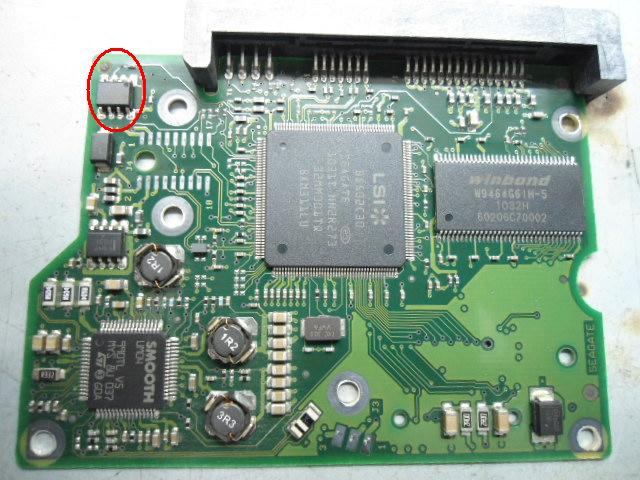

 Post subject: Re: Rom chip
PostPosted: May 28th, 2013, 5:56
Posts: 1754
Location: Verona, Italy
Top left corner chip.
Should be written on it 25P40 or 25X40 or something similar

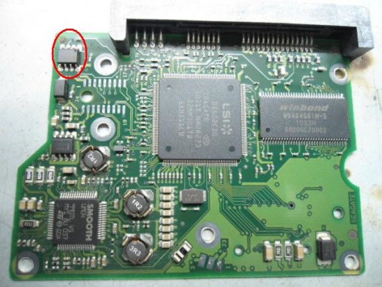

Posts: 84
when i replace the patient's pcb with donor pcb, i also replace the ROM chip of patient pcb the power goes off. hdd has no detection

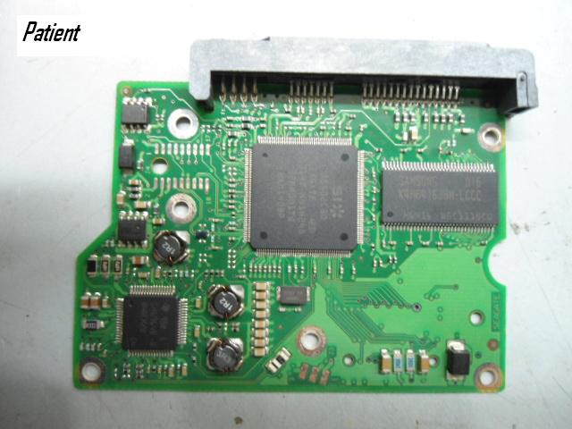

PATIENT PCB has no power , it is already dead.
when i replace a patient dead pcb
with donor ok pcb,the hdd power is on,but has no detection.
I replace ROM chip off ok pcb with dead pcb power goes off.

Measure the resistance between pin #4 and pin #8 of the flash chip.
Is your photo showing the damaged board or the donor?

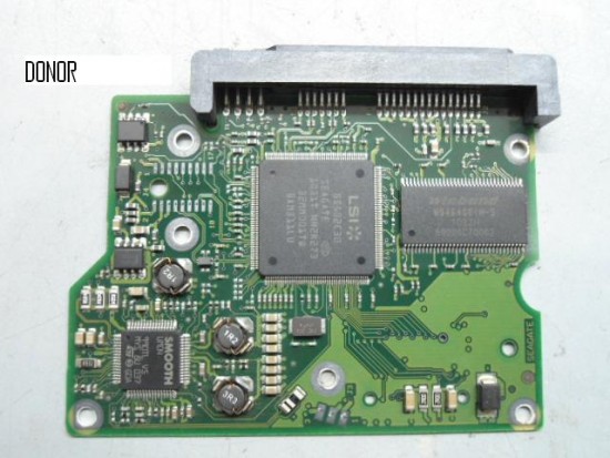

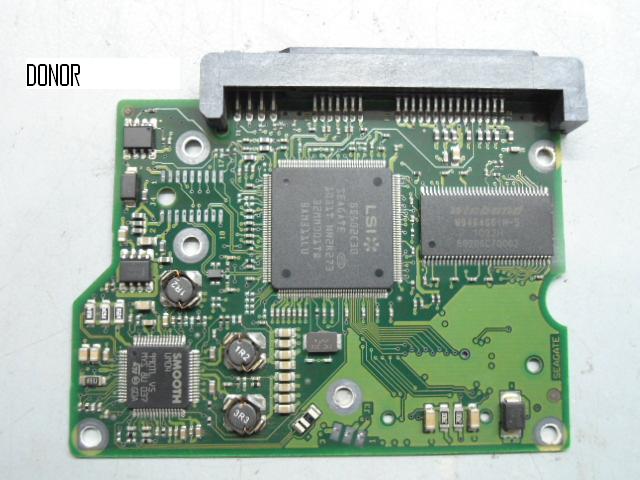

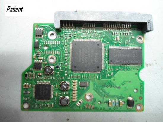

PostPosted: May 28th, 2013, 9:33
Posts: 84
please Mr fzabkar
see these both pictures of patient & donor pcb & guide me
PostPosted: May 28th, 2013, 15:31
Posts: 17223
See attachment.

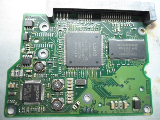

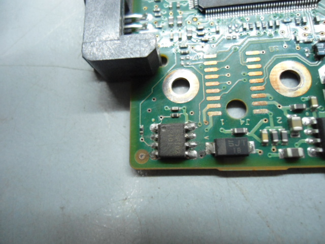

PostPosted: May 29th, 2013, 5:35
Posts: 84
Mr northwind
see the picture.i have sold the Rom chip accurately.
but the problem remain same
PostPosted: May 29th, 2013, 9:47
Posts: 3550
I'm not sure pin #4 (which by the way involves itself into the power supply) is making good contact.
PostPosted: May 29th, 2013, 12:21
Posts: 17223
Wrong chip ...
NTMSD3P102R2, ON Semiconductor, marking E3P102, FETKY P–Channel Enhancement–Mode Power MOSFET & Schottky Diode, Dual SO–8, –3A, –20V, 0.085 ohms:
http://www.onsemi.com/pub/Collateral/NTMSD3P102R2-D.PDF
http://www.datasheetcatalog.org/datashe ... 02R2-D.PDF
