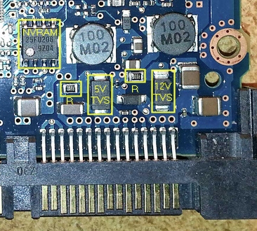

Here are some pics of the front and back of the PCB. There was no burnt smell, Twll me what to do to check it. I have a multimeter.

Measure the resistances of the two TVS diodes and the adjacent resistors ("R").
The NVRAM chip is the one you need to transfer to your donor PCB.
BTW, you should pull back on the tabs to release them before you withdraw the flex cable from the motor connector.
I notice that the 12V TVS diode has a dot. I don't know if this is a mould mark, or whether it is due to damage.

First, I have a cheapo Multimeter, even though it is probably not accurate, here are the results.
12V Diode
Setting my multimeter to Diode (with probes not connected it displays "1")
With the positive probe at the bottom it shows 180
If I reverse the probe a get "1" no connection.
The resistor (If I set it to the lowest dial number "200")
it reads 117
5v Diode
Set to Diode test
With positive at the bottom, it shows 200
If I reverse the probes it shows 450.
Resistor
With the positive to the right side I get 5 set at the 200k dial setting)
Any thoughts?

Neither diode is shorted.
The 12V resistor appears to be open. It should measure close to zero ohms on the 200 ohms range.
The reading for the 5V resistor (5Kohm) is suggesting that it is open also.
If the following thread is any guide, then your drive may have a dead motor controller IC, and perhaps a faulty preamp.
viewtopic.php?f=1&t=26543&p=183146
