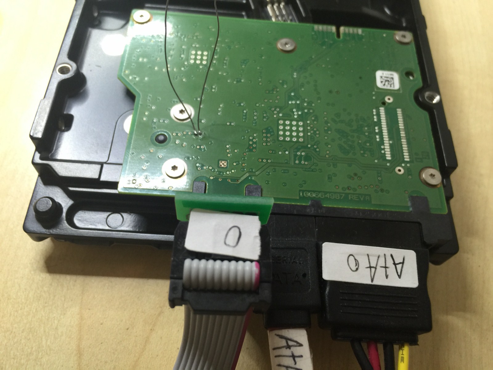

Hi to all!
Is hdd ST2000DL003
TERMINAL ERROR Is busy!
Boot 0x40M
Spin Up[0x000246DF]
Trans.
Rst 0x40M
MC Internal LPC Process
Spin Up
RECOVERED Op=0165 Resp=0005
RECOVERED Op=0055 Resp=0005
RECOVERED Op=0065 Resp=0005
RECOVERED Op=0900 Resp=0005
RECOVERED Op=0600 Resp=0005
(P) SATA Reset
MediaPartition:
Host LBA Length Disc LBA Length Start Cyl Head
Media Partition 00000000 0099B268 00000000 0013364D 00000000 00000000
MC 00000000 0098A210 00000000 00131442 00000000 00000000
MSP 009923C0 00000CF8 00132478 0000019F 00000210 00000004
User Partition 0099B268 0013364D 0000021B 00000004
MCMainPOR: Start:
Check MCMT Version: Current
MCMainPOR: Non-Init Case
MC Seg Disc and Cache Nodes: 40134924 40132A34
Seg Write Preamble VBM start: 000011B2 end: 000011D9
Footer - start: 000011DB end: 00001202
Seg Read Preamble VBM - start: 00001204 end: 0000122B
Footer - start: 0000122D end: 00001254
Reconstruction: MCMT Reconstruction Start
Max number of MC segments 22E0
Nonvolatile MCMT sequence number 0000196A
[RSRS] 1098 DiscLba 00091320 RW_RTL FFFFFFFF
RECOVERED Op=0455 Resp=0005
ProcessRWError -Read- at LBA 00091325 Sense Code=40000087
InitiateMarkPendingReallocateRequest for disc_lba: 00091325!
Reconstruction: EXCEPTION: Seg Read Fail: Status = 0000
Continuing after error
ReadFooters (Forward): Segment 1098 StartLBA 00489900 Starting Footer LBA 00489928
SeqNum 0000196B TotalUserBlocks 0000 DiscLba 00091325 RW_RTL FFFFFFFF
Footer Status = 0000 DiscLba 0009132A RW_RTL FFFFFFFF
Footer Status = 0001 DiscLba 0009132F RW_RTL FFFFFFFF
Footer Status = 0001 DiscLba 00091334 RW_RTL FFFFFFFF
Footer Status = 0001 DiscLba 00091339 RW_RTL FFFFFFFF
Footer Status = 0001 DiscLba 0009133E RW_RTL FFFFFFFF
Footer Status = 0001 DiscLba 00091343 RW_RTL FFFFFFFF
Footer Status = 0001 DiscLba 00091348 RW_RTL FFFFFFFF
Footer Status = 0001 DiscLba 0009134D RW_RTL FFFFFFFF
Footer Status = 0001 DiscLba 00091352 RW_RTL FFFFFFFF
Footer Status = 0001 DiscLba 00091357 RW_RTL FFFFFFFF
Footer Status = 0001 DiscLba 0009135C RW_RTL FFFFFFFF
Footer Status = 0001 DiscLba 00091361 RW_RTL FFFFFFFF
Footer Status = 0001 DiscLba 00091366 RW_RTL FFFFFFFF
Footer Status = 0001 DiscLba 0009136B RW_RTL FFFFFFFF
Footer Status = 0001 DiscLba 00091370 RW_RTL FFFFFFFF
Footer Status = 0001 DiscLba 00091375 RW_RTL FFFFFFFF
Footer Status = 0001 DiscLba 0009137A RW_RTL FFFFFFFF
Footer Status = 0001 DiscLba 0009137F RW_RTL FFFFFFFF
Footer Status = 0001 DiscLba 00091384 RW_RTL FFFFFFFF
Footer Status = 0001 DiscLba 00091389 RW_RTL FFFFFFFF
Footer Status = 0001 DiscLba 0009138E RW_RTL FFFFFFFF
Footer Status = 0001 DiscLba 00091393 RW_RTL FFFFFFFF
Footer Status = 0001 DiscLba 00091398 RW_RTL FFFFFFFF
Footer Status = 0001 DiscLba 0009139D RW_RTL FFFFFFFF
Footer Status = 0001 DiscLba 000913A2 RW_RTL FFFFFFFF
Footer Status = 0001 DiscLba 000913A7 RW_RTL FFFFFFFF
Reconstruction: EXCEPTION: Segment Overall Sequence Number Mismatch, No Valid Footer 0000196B FFBFFDFB
Reconstruction: ProcessIncompletelyWrittenSegmen
Problem? is SA?

 Post subject: Re: TERMINAL ERROR BUSY
PostPosted: November 19th, 2013, 9:24
Posts: 1060
F3 T>
ATA 15 Cmds
Ts(ms) dT(ms) Op Cnt LBA
0 99999999 00 0000 000000000000
0 0 00 0000 000000000000
RW 32 Cmds
Ts(ms) dT(ms) xT(ms) Type Option Mode St EC Info
4294967295 99999999 0 FF FFFFFFFF FFFFFFFF FF FFFFFFFF
4294967295 0 0 FF FFFFFFFF FFFFFFFF FF FFFFFFFF
9325 9326 0 2F 000000 000000 1 00000080 SPN_UP NORMAL
9352 27 11 34 000000 000000 1 00000080 TCC 1
9364 12 415 02 002241 000000 2 43110081 XFR RD SYS LBA B 0000000246DF L 0000000C BO 000000 BES 00A750A.00A7809.00A750A
9780 416 2825 02 002241 000000 2 43110081 XFR RD SYS LBA B 0000000246DF L 00000001 BO 000000 BES 00A750A.00A7809.00A750A
12605 2825 447 02 002241 000000 2 43110081 XFR RD SYS LBA B 00000005FAFE L 0000000C BO 000000 BES 00A750A.00A7809.00A750A
13052 447 1440 02 002241 000000 0 43110081 XFR RD SYS LBA B 00000005FAFE L 00000001 BO 000000 BES 00A750A.00A7809.00A750A
14492 1440 419 02 002241 000000 2 43110081 XFR RD SYS LBA B 00000005FAFF L 0000000B BO 000000 BES 00A750A.00A7809.00A754A
14911 419 2825 02 002241 000000 2 43110081 XFR RD SYS LBA B 00000005FAFF L 00000001 BO 000000 BES 00A750A.00A7809.00A754A
17747 2836 439 02 002241 000000 2 43110081 XFR RD SYS LBA B 00000002B877 L 00000190 BO 000000 BES 0042363.0048762.0042363
18186 439 2835 02 002241 000000 2 43110081 XFR RD SYS LBA B 00000002B877 L 00000001 BO 000000 BES 0042363.0048762.0042363
21051 2865 427 02 002241 000000 2 43110081 XFR RD SYS LBA B 000000066C96 L 00000190 BO 000000 BES 0042363.0048762.0042363
21479 428 1843 02 002241 000000 0 43110081 XFR RD SYS LBA B 000000066C96 L 00000001 BO 000000 BES 0042363.0048762.0042363
23323 1844 408 02 002241 000000 2 43110081 XFR RD SYS LBA B 000000066C97 L 0000018F BO 000000 BES 0042363.0048762.00423A3
23731 408 2835 02 002241 000000 2 43110081 XFR RD SYS LBA B 000000066C97 L 00000001 BO 000000 BES 0042363.0048762.00423A3
26580 2849 49 02 005041 000000 0 89800094 XFR WR SYS LBA B 00000002FD5D L 00000001 BO 000000 BES 0042063.00420A2.0042063
26779 199 10 02 005041 000000 1 00000080 XFR WR SYS LBA B 000000028FDC L 00000008 BO 000000 BES 0042123.0042322.0042123
26789 10 51 02 005041 000000 0 89800094 XFR WR SYS LBA B 0000000643FB L 00000008 BO 000000 BES 0042123.0042322.0042123
26840 51 439 02 002241 000000 2 43110081 XFR RD SYS LBA B 00000002FD3F L 00000051 BO 000000 BES 00932CA.05FFFFF.00932CA
27280 440 2591 02 002241 000000 0 43110081 XFR RD SYS LBA B 00000002FD3F L 00000001 BO 000000 BES 00932CA.05FFFFF.00932CA
29871 2591 409 02 002241 000000 2 43110081 XFR RD SYS LBA B 00000002FD40 L 00000050 BO 000000 BES 00932CA.05FFFFF.009330A
30280 409 99999999 02 002241 000000 FF FFFFFFFF XFR RD SYS LBA B 00000002FD40 L 00000001 BO 000000 BES 00932CA.05FFFFF.009330A
RECOVERED Op=0155 Resp=0005 PASS
MSP MainPOR:
MSP Init Metadata
Buf Bytes/VBM 00000210 DBA Base 40000000

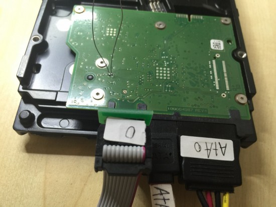

You net to do:
in pcb do the photo.
In comand line do:
F3 T>m0,6,3,,,,,22
(is a: REGENERATE TRANSLATOR).
By RecuperoDatos.com
File comment: short circuit in PCB by RecuperoDatos.com
PostPosted: October 8th, 2015, 0:48
Banned User
Joined: January 6th, 2015, 11:10
Posts: 6
Location: Argentina
Hello, :D
I solve this problem as follows:
Short circuto of the PCB as they are in the photo Image
Then in the terminal:
F3 T>m0,6,3,,,,,22
(is a REGENERATE TRANSLATOR).
After Power reset and :lol:
working again!!
So I solve it.
