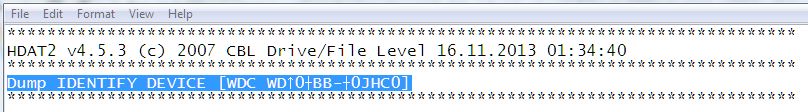

Earlier this evening I ran HDAT2 from the Hiren's disk, and it saves it's reports to the "R:\" RamDrive, but I cannot figure out how to get my 16 Gbyte USB thumbdrive recognized so I can copy the report over.
Is there a trick to getting a thumbdrive recognized in Hirens?
EDIT***
Decided to solve the problem by creating a Hiren's Bootable USB. When it's done, I'll get the HDAT2 data. Thanks for the responses.
Re: WD800BB-00JHC0: Corrupt Firmware?
November 16th, 2013, 4:01
Okay so I've managed to get the system configured so that HDAT2 will save it's reports to my thumbdrive.
I'm using HDAT2 off of two Hiren's disks. One is ver. 9.6 or so and the other is ver. 15.x. the earlier version of HDAT2 clearly says "firmware corrupt" on the main screen, as well as a checksum error, while the later version only mentions the checksum error.
Also note the model "WD800BB-00JHC0" in the title is correct and printed on the HD's label, but this name is corrupted in various places, such as the file name in the .BIX file (see attached, "B__0JHC0.rar") from HDAT2, as well as these excerpts (below) from the HDATCOPY.TXT and HDETECT.TXT from HDAT2 (also attached).

Your drive has a stuck bit on the IDE interface.
If you compare the data in the IDENTIFY DEVICE dump against the expected data, you will see that bit #13 is stuck low. This corresponds to pin #14 on the IDE interface.
Here is the pinout:
http://pinouts.ru/HD/IdeInternal_pinout.shtml
Remove and reseat the IDE cable, examine the connectors for a bent pin, check the HDD PCB for a dry solder joint where the connector attaches to the board, or try another cable.
The following article explains the problem in more detail.
Bad model number due to stuck bit in IDE interface:
http://malthus.zapto.org/viewtopic.php?f=59&t=147&p=262
You can see the bit differences here:
44 57 20 43 44 57 30 18-42 10 2D 42 30 10 48 4A   DW CDW0.B.-B0.HJ
30 43 20 00 20 00 20 00-20 00 07 20 00 20 00 20   0C
44 57 20 43 44 57 30 38-42 30 2D 42 30 30 48 4A   DW CDW08B0-B00HJ
30 43 20 20 20 20 20 20-20 20 20 20 20 20 20 20   0C

fzabkar wrote:Remove and reseat the IDE cable, examine the connectors for a bent pin, check the HDD PCB for a dry solder joint where the connector attaches to the board, or try another cable.
I replaced the IDE cable and the model name appears normally now, however it still will not boot. Right now I have Easeus Partition Manager (Server) from the Hiren's 15.x disk running, looking for partitions. Easeus reports the HD as being 100% unallocated.
I wonder if running "FIXBOOT" on a proprietary (IBM) system drive could have caused this? Years ago, I ran fixboot on a Dell HD and discovered I broke some kind of code that allowed you to access a hidden Data Restore partition. Thanks for the help so far. I'll update the thread when Easeus has finished it's run. Is there anything else I should be doing?
