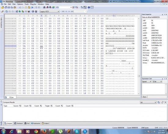

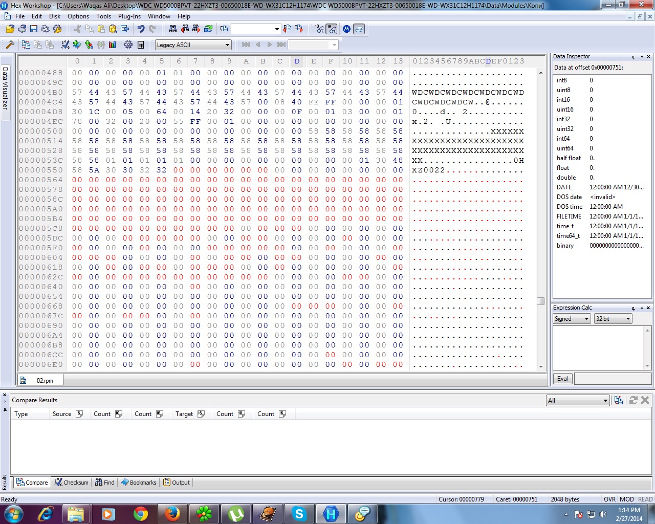

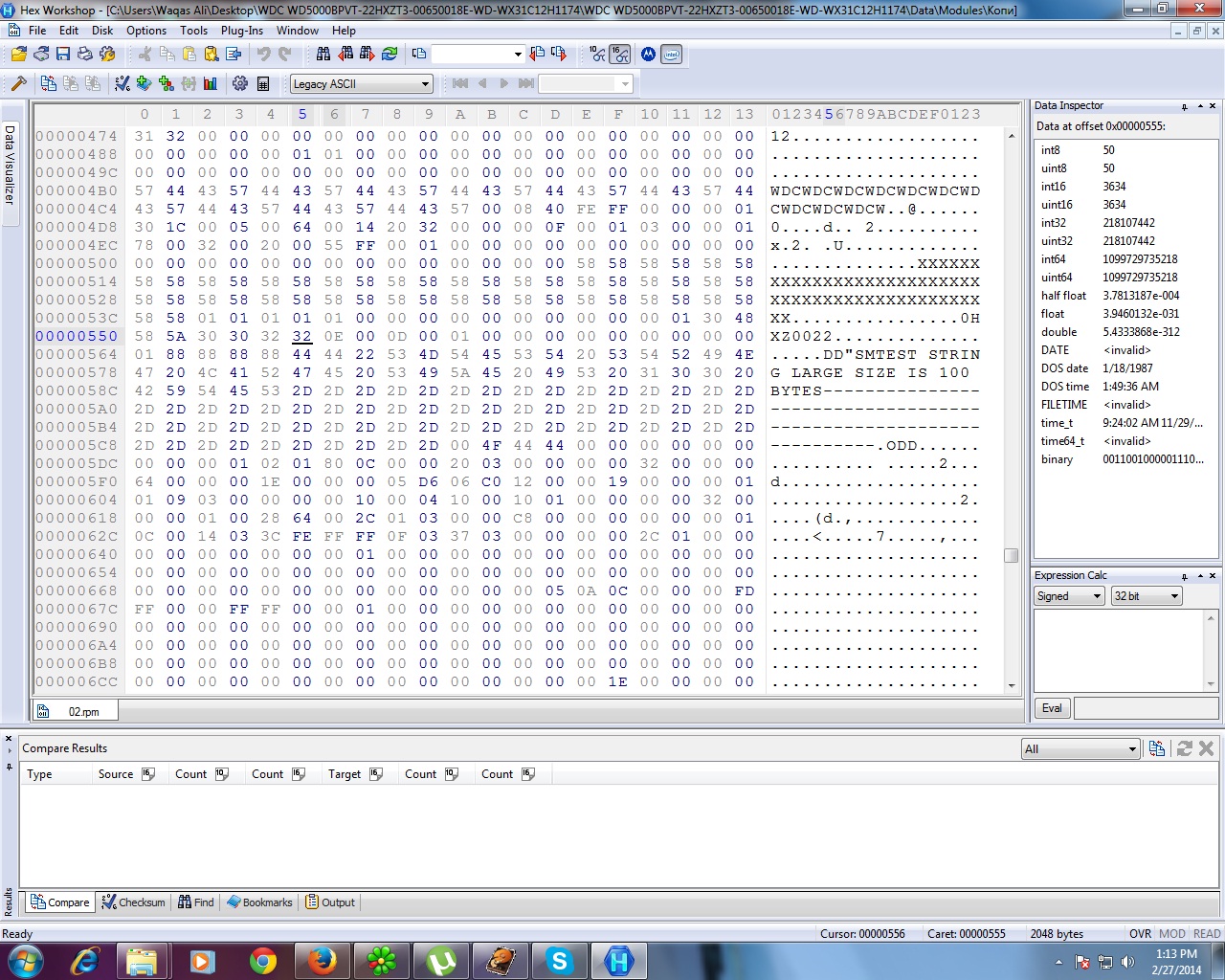

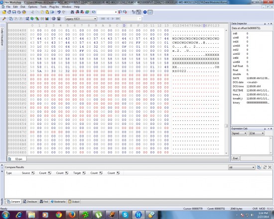

hello
open 02 module in hex and after this word (XXXXXXXXXXXXXXXXX 0HXZ0022) all values will be 000000 and then save it to module 02,to remove idle mode.
Waqas Ali
http://www.sediv.net

Thanks Waqas again,
I tried to edit Mod 02 as suggested by you.
I noticed that Copy 0 is not getting edited and it remains the same. Copy 1 is edited but the problem remains the same.
In a working drive i am able to edit and both copies are getting edited.
What do you suggest ??

ah that is the thing, now you find the damaged and read only head, due to which reading is slow. try to use selective head image. or head map in ram.
