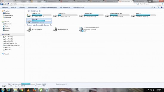

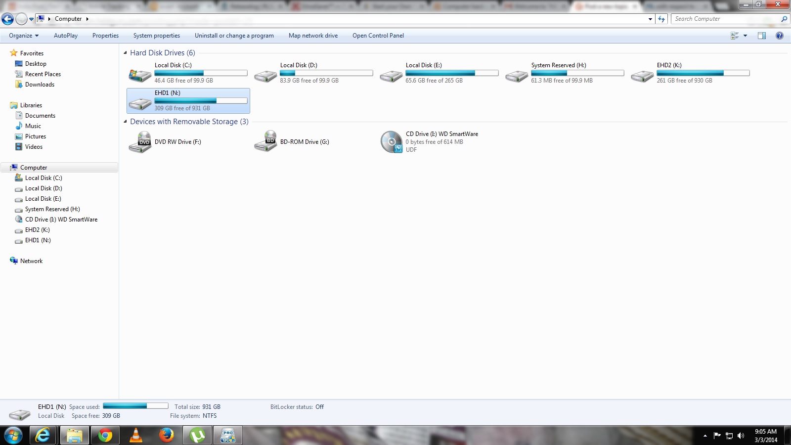

2.) Then all of a sudden about two weeks ago the problem escalated and since then its remained so until now. now when i plug it in to the computer, it reads the EHD, even shows that it has about 309gb free of the 931gb (see attachment 1.jpg)
File comment: The EHD in question is EHD1...it shows the available space as well.

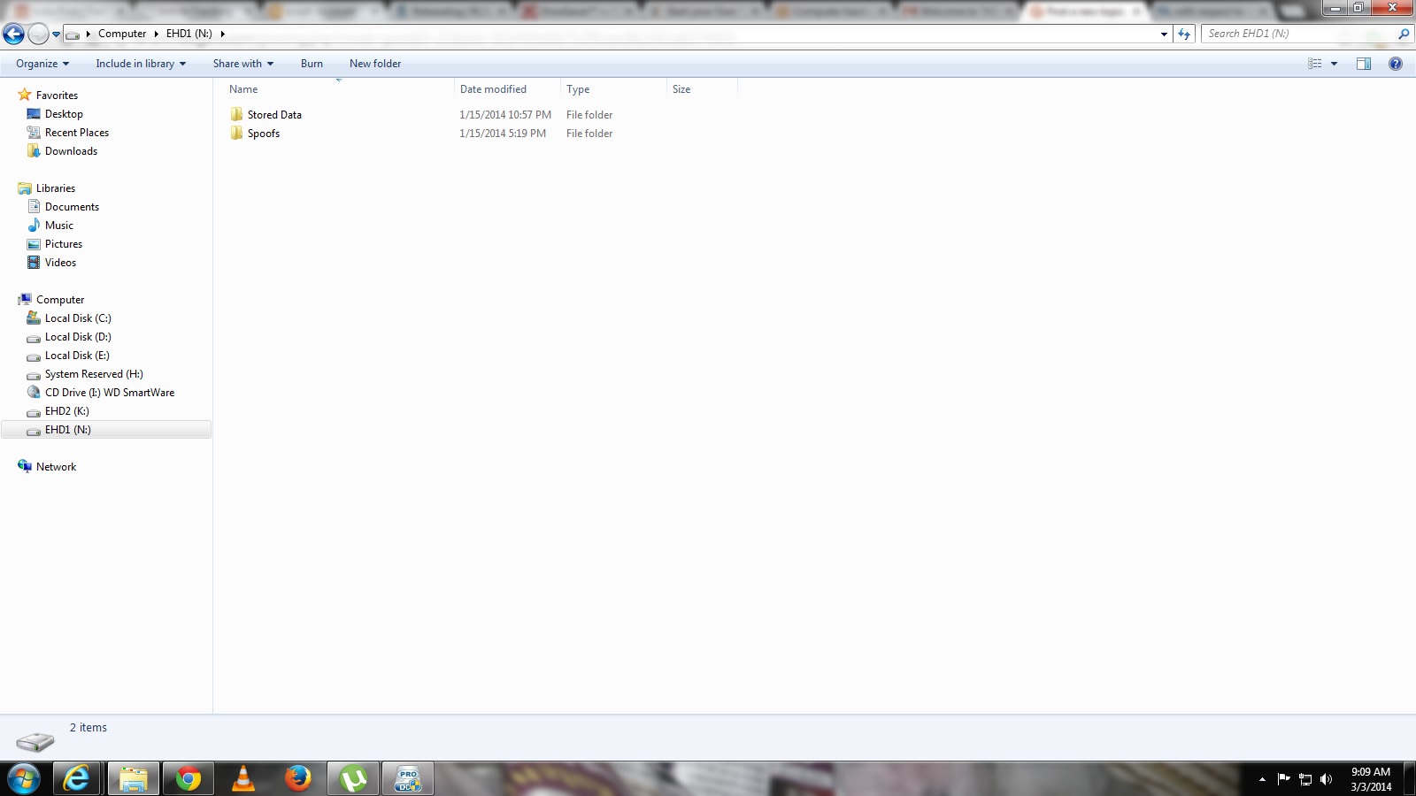

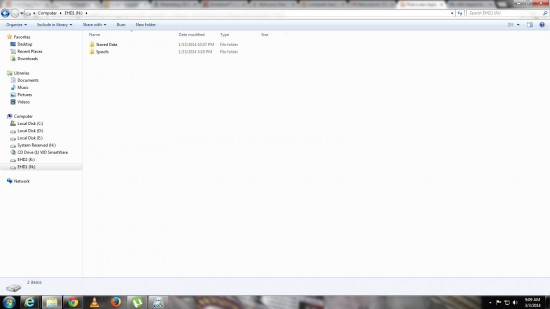

, but when i try to enter the folders inside(see attachment 2.jpg)
File comment: This is the first level of folders inside it... even these are accessible.

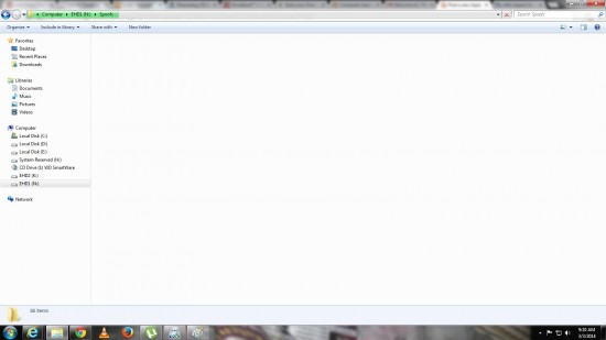

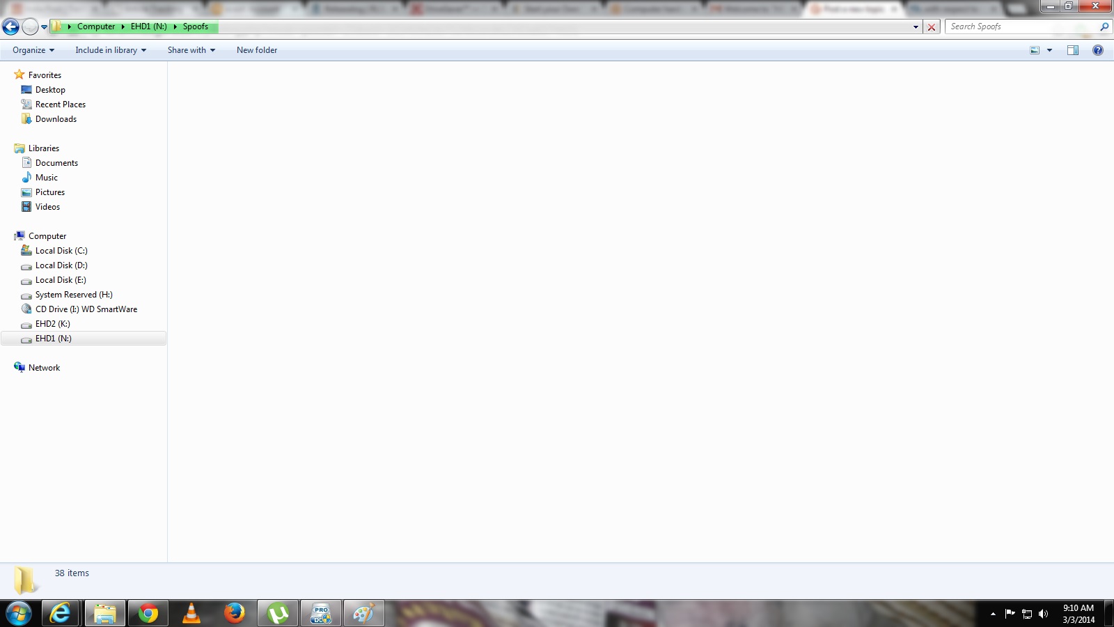

, the light of the EHD starts to flash and the windows explorer appears as if it is trying to read the data (see attachment 3.jpg)
File comment: And if i try to enter either of these folders, this is what happens... see the green line at the address bar, its as if its trying to read, but it will file the entire bar green and nothing will happen.
, but no response from the EHD. I will wait for a long time and then when i close that window and open a new window to enter the EHD once again, it will not show anything, not even that it has 309gb free of 931gb.

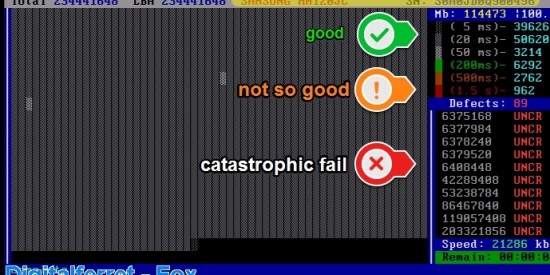

Hi Leolov, top marks for quality of post btw, descriptions / diagrams etc.
Obvious statement first: If the files you are trying to recover are valuable to you, please do consider pro help. This help below is a guide only and should you lose data whilst carrying it out, it is your own risk.
Given what you have said already about not wanting to send to DR Co:
So...
you could try the following without spending huge sums on hardware tools.
Attach the drive via native (sata) cables to the PC.
Maybe best to make this, the bad drive, the ONLY drive attached to the PC at this stage.
Run a copy of MHDD from CD (its in Live CDs such as Hirens Boot CD, UBCD and here on hddguru as a download.
If it reads the drive and identifies correctly this is good, run a SCAN .
If it is reading and processing sectors this is also good, the disk is readable.
If it completes with no errors it is likely you have file or filesystem corruption and this is a software solution issue and can be dealt with using data recovery SW such as R-Studio (you will need to tweak a setting first tho)
Let us imagine this is the case.
Next invoke the SWITCHMBR command. This changes the 55AA signature at the end of MBR.
(You can toggle back again should you need to after you have done the recovery).
Exit and power down.
Reattach your Main OS drive.
You should now be able to attach the bad drive and run windows as normal.
You will not see the drive in Explorer but will be able to pick it up via DR software.
Open the file system with say R-Studio and find your perhaps corrupt file directory and try to recover.
If it stalls, its likely that file is corrupt or that part of the disk had bad sectors.
This system may also be useful in the event of bad sectors where you don't want or are not able to take a full disk image.
Let us now imagine that MHDD started showing a huge range of bad sectors or returned other system errors while in SCAN.
You are now entering the territory of having to make a disk image and would either need repair / dedicated hardware, or a reasonable knowledge of Linux and its dd command or the many derivatives of it to take an image.
Once you have an image, back to DR software to proceed.
Hope this points you in right direction.

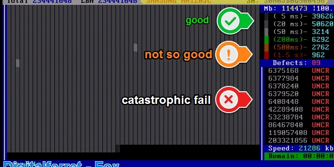

image attached is screencapped from another program Viktoria but gives the sort of thing you may see on MHDD
K
