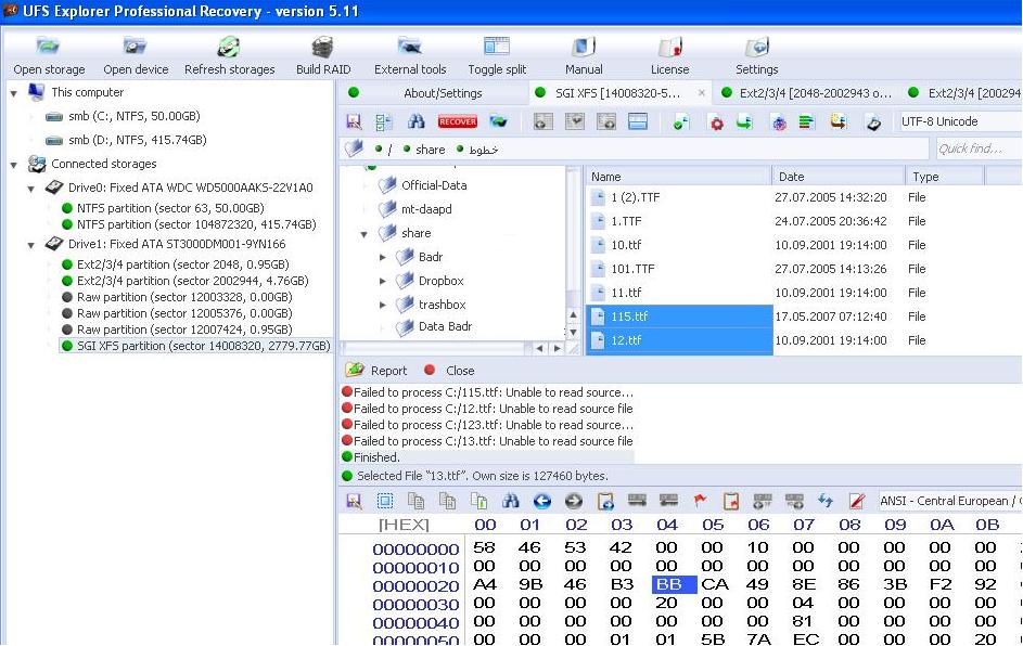

Hi
I have Buffalo with network(3TB) .The HDD not appear in my pc .I used UFS Explorer pro. 5.11 I saw the files and folders , when I recovery any file or folder I got zero files size.
Pls any advice ?

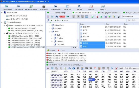

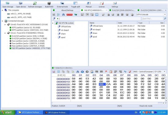

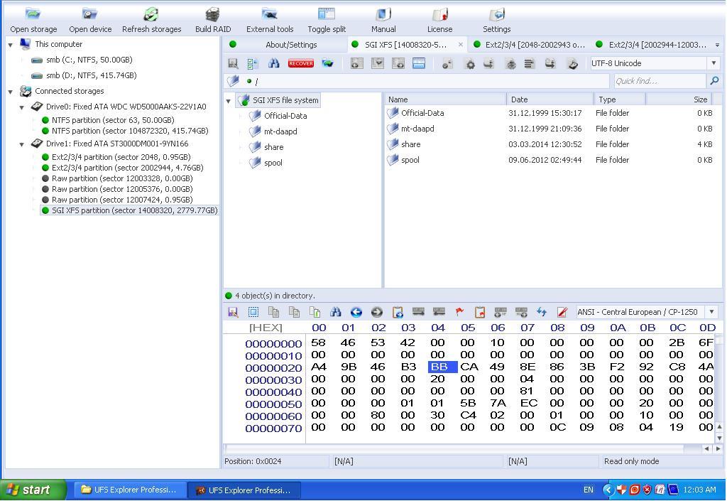

Can you see the file system with Linux Reader for Windows (freeware)?
http://www.diskinternals.com/linux-reader/
Can you show us the contents of sector 0 (in hex)?

attached 2 files
Thank you
