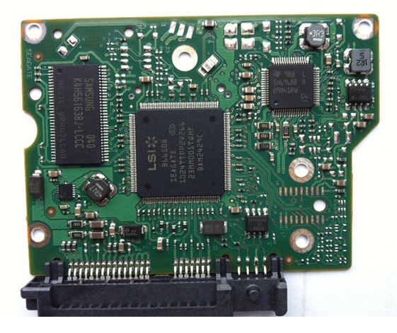

My backup hdd got burned (probably electrical surge or something similar), symptomps are: hdd wont spin, no clicks, total silent, there are no visible burns on PCB, no any smell.
I think the PCB is damaged, am I right ?
I ordered exact same PCB from ebay
Specs:
ST2000DL001
PN: 9VT156-570
FW: CC96
PCB: 100617465 REV A

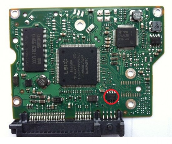

- My questions are:
If all parameters are the same, will I need to do ROM swap to new pcb ?
Which one of chips should I swap (see attached picture), I have no idea, which one is the correct rom :-(
Free-Shipping-100617465-font-b-HDD-b-font-font-b-PCB-b-font-Logic-Board-Board[1].jpg [ 90.03 KiB | Viewed 5545 times ]
 Post subject: Re: Seagate ST2000DL001 fail - which chip to swap?
PostPosted: May 11th, 2014, 13:11
8 legged chip, bottom right of pic

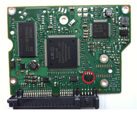

So this is the one ?
Thanks for answer
