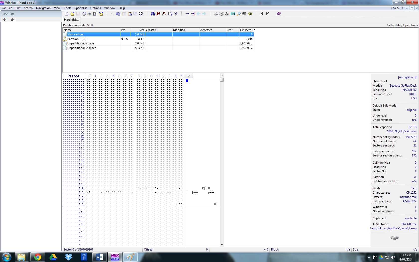

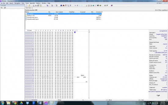

Here are my steps I wrote down when I had a look at recovering a deleted partition with Truecrypt I know its not the exact same issue your describing but it might be helpful if sector0 has got corrupted.
I was using Winhex to do this.

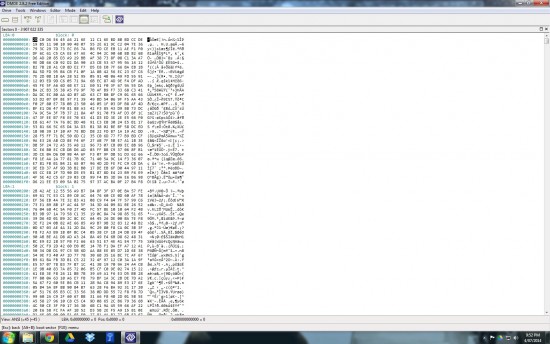

@Loki
Its a single partition
It is NTFS
No, Hvaen't cloned or imaged the partition
Also looking at your instruction sheet :
[*]How do i action step 3 ? Actually can you help me out with points 3-11 on that list. I haven't used winHex before.
Here is the screen shot when i load the drive in winHex :

 Post subject: Re: Recovering data from possibly corrupted Truecrypt volume
PostPosted: July 4th, 2014, 7:41
Posts: 927
Location: uk
You could just run Dmde and point it towards the external drive and "j" partition to see what partition info is available. I would certainly do that! If you see your partition you can open the volume and then recover a couple of files to a second drive and check them.

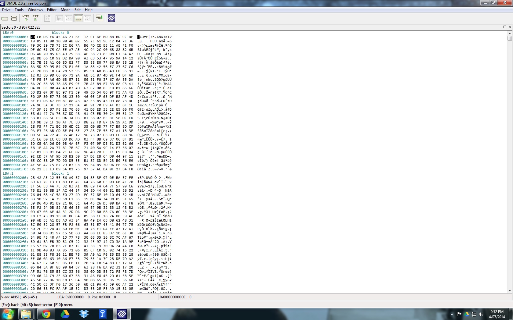

PostPosted: July 4th, 2014, 7:55
Joined: July 4th, 2014, 3:20
@dick How do i do that. here is what i see when I open j drive in dmde:
