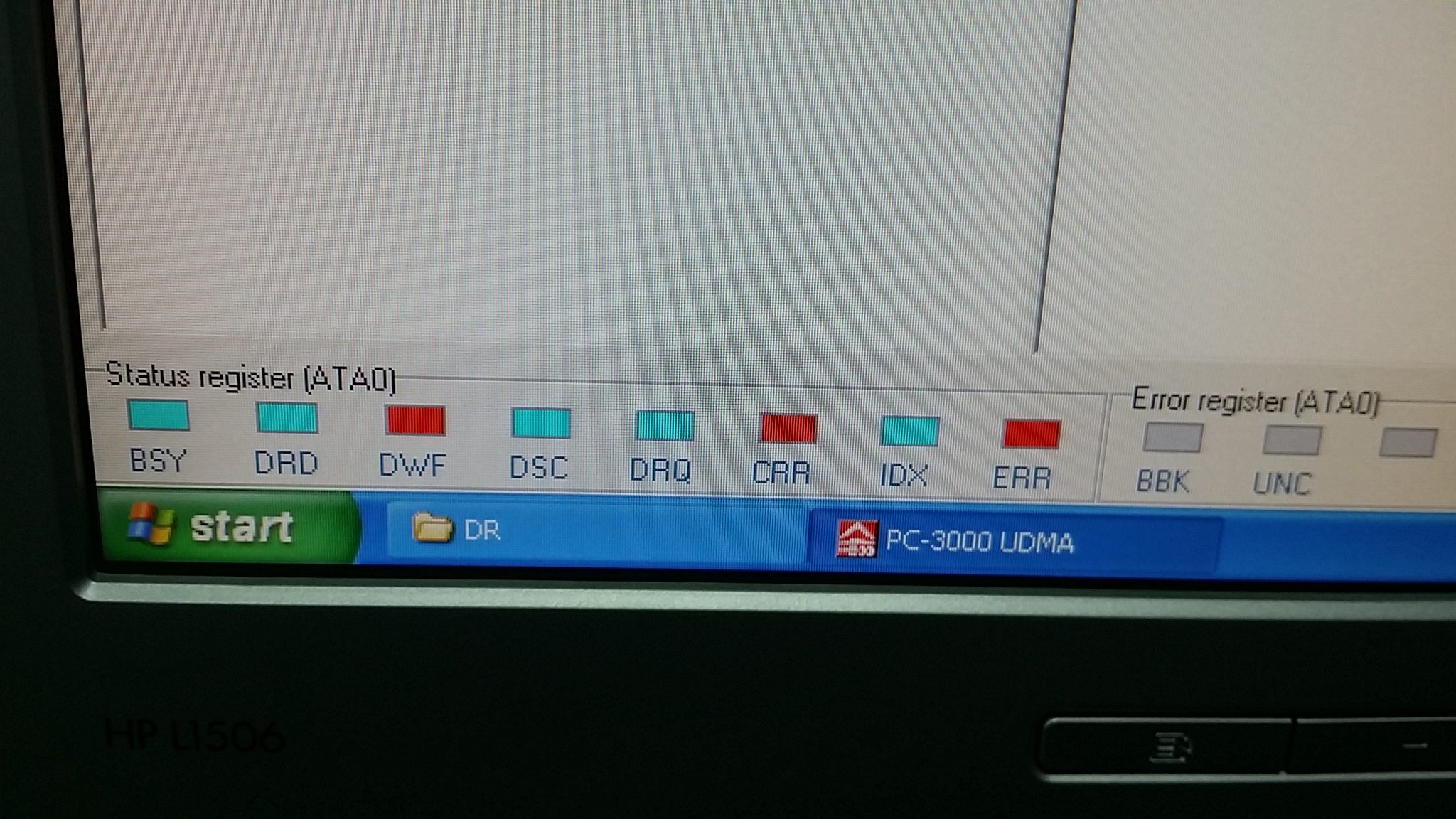

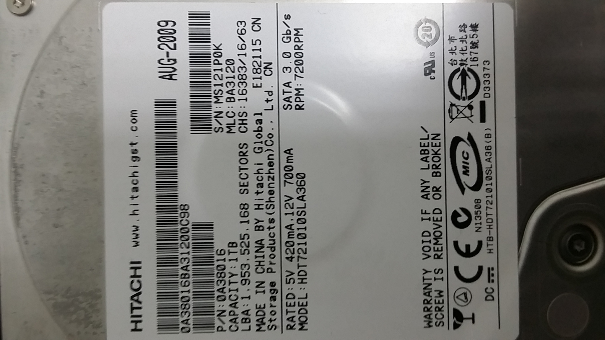

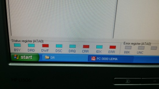

I have a Hitachi HDT721010SLA360 Disk. When powered on not spinning up and silent.
PC3000 shows all registers red and bsy
Please find the attached pics.
What cud be the likely issue with this drive ?

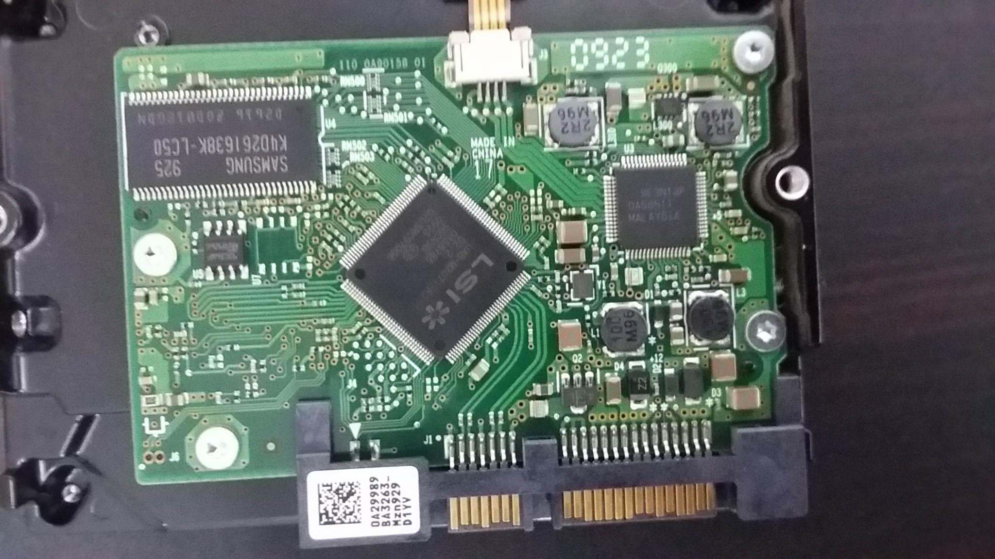

 Post subject: Re: Hitachi HDT721010SLA360 - No life
PostPosted: August 9th, 2014, 8:18
Posts: 1768
Location: Verona, Italy
very likely bad pcb.
PostPosted: August 12th, 2014, 6:37
Posts: 811
Location: World
I think Bad PCB, you need donnor PCB.
PostPosted: August 12th, 2014, 8:29
Posts: 1061
Location: Bangladesh
It could be bad PCB, sometime it's bad head.
If you have SD SATA TO IDE converter then you can see if 2 LEDs are on or off. If 1 is on, another 1 is off. Then it's PCB.
If both LEDs are on, then it's internal damage.
Isolate PCB from HDA, you can also confirm.
