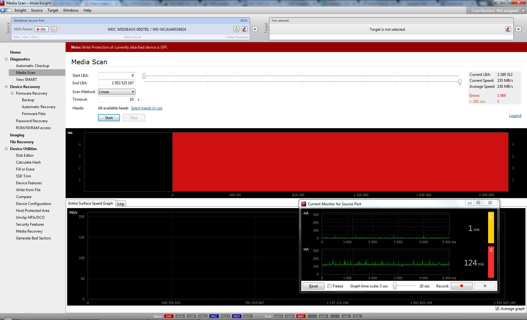

I write here, maybe somebody could help me.
The patient drive is a WD10EAVS-00D7B1
ROM rev:05.ASE
Mod 0D:01.00
Mod 4F:05.AS
DIR Rev:02.00
OVL Rev:05.AS
The drive idetifiable fine as 1TB drive, no clicking or any strange noise.
I can read all firmware modules fine but when i would like to access to ANY sectors, then all sectors are has CRC errors.
I tried with WDR to clear, and regenerate translator that finished with "success"(format quick with P-list), but nothing changes.
WDR head tests are finished with all heads good result.
The strangest thing is, when the drive heads parked or the motor spins down (when i do a command for it) and i try a Medai Scan with Atola, the drive does not spins up again. The drive spins up only when i want to read something from the SA. (i have attached the screen print)
I downloaded another WD10EAVS-00D7B1 firmware from hddguru files with the same microcode.
Could anyone help me to solve this firmware issue?
Thanks for any help!

It does like a password locked drive, but it does not locked with password.....
I can lock the drive with password, and can unlock it.
I have checked the overlay modules, and there are fine too.

Probably a weak head, preventing full translator initialisation.
 Post subject: Re: WD10EAVS-00D7B1 firmware issue
PostPosted: August 29th, 2014, 16:11
Or maybe suspect data in mod 32.

So....here it is the modules of the patient drive. The drive has "all sectors ABRT" error.

@HDD Spaz:"try booting off different head in ram."
Do you mean, try to boot the drive, and set head map in ram to 012345, soft reset, and set back the head map in ram to 234567 then soft reset again?
I have tried it, but no success.
@fzabkar: I tried with a clean mod 32 that i attached to this thread, but no success.
Einstein (forum member) says, the smart hot swap method could help me, but if i would like to read the SA tracks, there are some bad sectors.
Today Waqas Ali will send me my SeDiv license, and i'm really curious what Sediv could give me. :-)
PostPosted: September 1st, 2014, 14:01
Not quite. Try 222222 then back to 234567.

@saltwater, does this help?
http://www.deepspar.com/blog/Head-Map-in-Ram.html
Here is MOD 0A in your ROM:
0002FFB0        52 4F 59 4C 04 00 1E 00 0A 00 01 00 50 56    ROYL........PV
0002FFC0  B6 64 30 30 58 31 30 30 30 32 0B 0C 08 00 00 00  ¶d00X10002......
0002FFD0  20 06 00 06 06 FC 3F 00 7C 7C 7C 52 4B 37 45 45   ....ü?.|||RK7EE
0002FFE0  52 35 55 55 00 00 00 00 00 00 00 00 00 00 90 FA  R5UU...........ú
You can see that the drive has 6 heads, and that the head map is 0xFC:
Now 0xFC = 0b11111100, which means that heads 2,3,4,5,6,7 are present and 0,1 are absent.

1. upload all modules to donor drive
2. start donor drive with patient PCB
3. spin down donor drive and hot swap PCB to patient drive
4. spin up patient drive with it's own PCB
5. let's imaging
These five steps are work, now imaging the drive
Thanks the help for all.
PS: The donor drive is a WD10EACS with the same head map.

While imaging, i realized the head 0 is bad.....
PostPosted: September 2nd, 2014, 10:36
In which case, altering head map in RAM to 333333 would probably have worked :-)
