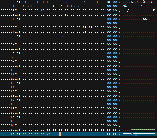

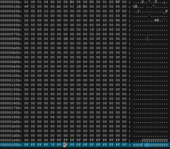

I've been dealing with a locked hard drive for about two weeks now. Um, I have learned a lot by viewing other people post. Right now, I'm using MHDD 4.5. The bin file that was created looks completely different from what others have posted. To me, it looks "empty". The hard drive I'm working on is WD500BEVT-75ZAT0. Most of the scripts that I found on here comes back with a DRQ error. Here's what worked for me:
regs48 = $d5 $01 $be $4f $c2 $a0 $b0
waitnbsy
checkdrq
sectorsto = INO1.bin
waitnbsy
checkdrq
sectorsto = INO2.bin
File comment: Mhdd bin

All you are doing is reading log file 0xBE twice. It's essentially meaningless.

Log 0xBE is used to transport a Vendor Specific Command (VSC) to the drive. Log 0xBF returns the data requested by the VSC.
Tutorial: Using MHDD to send ATA commands to a HDD:
http://www.alexsoft.org/viewtopic.php?f=91&t=987
