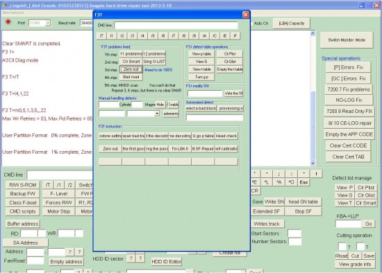

Any one know how to fix the 7200.12 after bad format with m0,2,,,,,22 using STcom software. I tried leonardo method but don“t work in my case. Could anybody explain in detail how to aply the method.See picture for details of the software. The HDD is ST3500418AS, FW: CC44, 500GB

I am using Stcom and give the command m0,2,2,,,,,22 for fix No HOST FIS-ReadyStatusFlags, the drive is not BSY now but give partial access, the data is not important, i read several post that speak abaut this:
Definition of Leonardo method:
1. Backup all modules, etc
2. Clear Altlist = Glist (i4,1,22)
3. Power off/on
4. Scan drive with MHDD or search manually with "Sector View", etc. STOP and RECORD (write on paper) FIRST PROBLEM LBA
5. Make sure drive add this LBA to Glist you can check it with V4 command
6. REGENERATE TRANSLATOR ---- BUT use command to USE AltList: m0,6,3,,,,,22
7. REPEAT #4 --> 6
This method not work in my case or i fail using it.Thank you for your help.

you need special tools, forget about STcom (it does not work with F3 drives) and forget about Leonardo method.
I have tried in the past this tool and Leonardo method, i never had success with those. I have now professional tools to deal with defect list, translator, etc.

As i know, there isn't any downloadable tool that is able to fix NRG.
You have to use professional tool to fix this as PC3000 UDMA, Salvationdata HD Doctor, DFL or send the drive to someone which has one of those.
