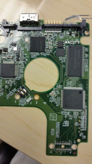

Seem to be overrun by these type of drives recently. I have a WD10TMVW thats very slow to respond. It has board board 2060-771737-00 (image attached). I have a matching SATA board 2060-771820-000 Controller number) and have swapped the U12 chip. The drive does not spin up, but the board comes RDY and I can see the ROM information to presume the ROM swap worked. Any advice.

771820 has a different motor controller (Nautilus):
http://ep.yimg.com/ay/yhst-144375849714 ... 2601-1.gif
2060-771737 has an SH6601AF.

use 1692-005 sata pcb

That board worked fine and can get into the drive to work on it. One more question, I presume I can image the drive (DDI) to a SATA drive and then use a WD Bridge Board to decrypt? I guess I could by a matching donor drive, image to that, swap the ROM over and we would be good. But they are currently running at $250. Do you know a bridge board number that would decrypt the imaged drive? My drive has Symwave SW6316 3VB14.

PCB 4060-705089-001
Mikippp
 Post subject: Re: Integrated USB Board Issue
PostPosted: October 22nd, 2014, 14:57
You can use WD My Book board 4061-705089-001 to decrypt that one.
