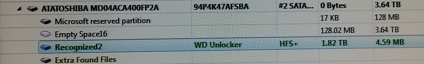

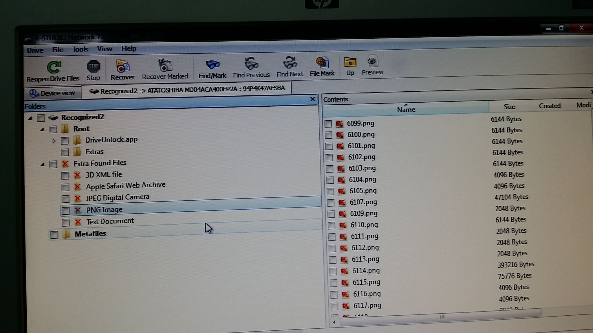

northwind wrote:
Are you scanning using the USB bridge, or using the drive alone directly connected via SATA?
I am using USB bridge.
When I scan directly using SATA, I see the following in R-studio after the r-studio scan complete
