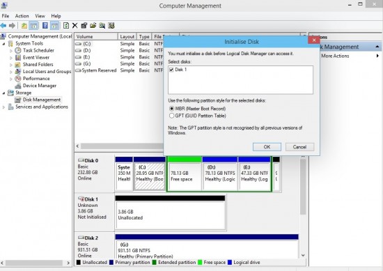

Hi my desktop HDD Seagate 1TB stopped working all of a sudden and and stopped booting.
so removed from desktop to connect to my external 1TB Hdd's usb pcb board and plugged through USB to my laptop.
In laptop's disk management it shows just 3.88GB (unallocated space)
can any one help me out to solve the issue so i can get full space back to be use and also to recover my data out of my Hdd.

Today morning used easeus recovery application even in that only one partition was showed of 3.88GB
and also in cmd mode used diskpart and guess what it remained the same 3.88GB

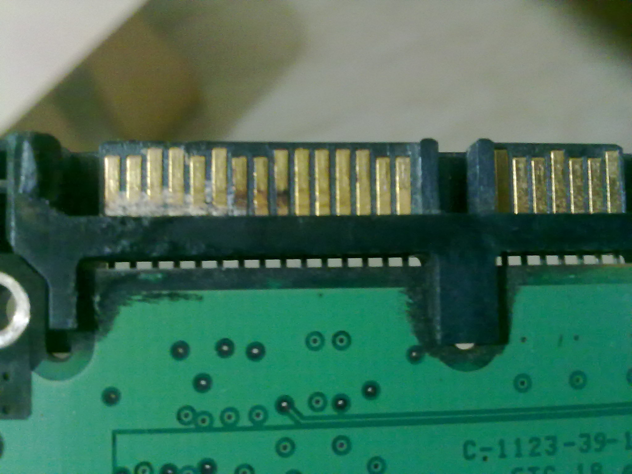

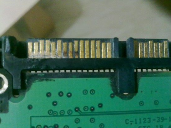

Tried but not able to upload the sound file from mobile will give it a try once I reach home from system
And yes the last 4 connectors of power supply is been damaged will post that image too once I reach home

image of pcb connectors attached
tried to attach audio file but its not allowing to add wav. and mp3. format files to attach.

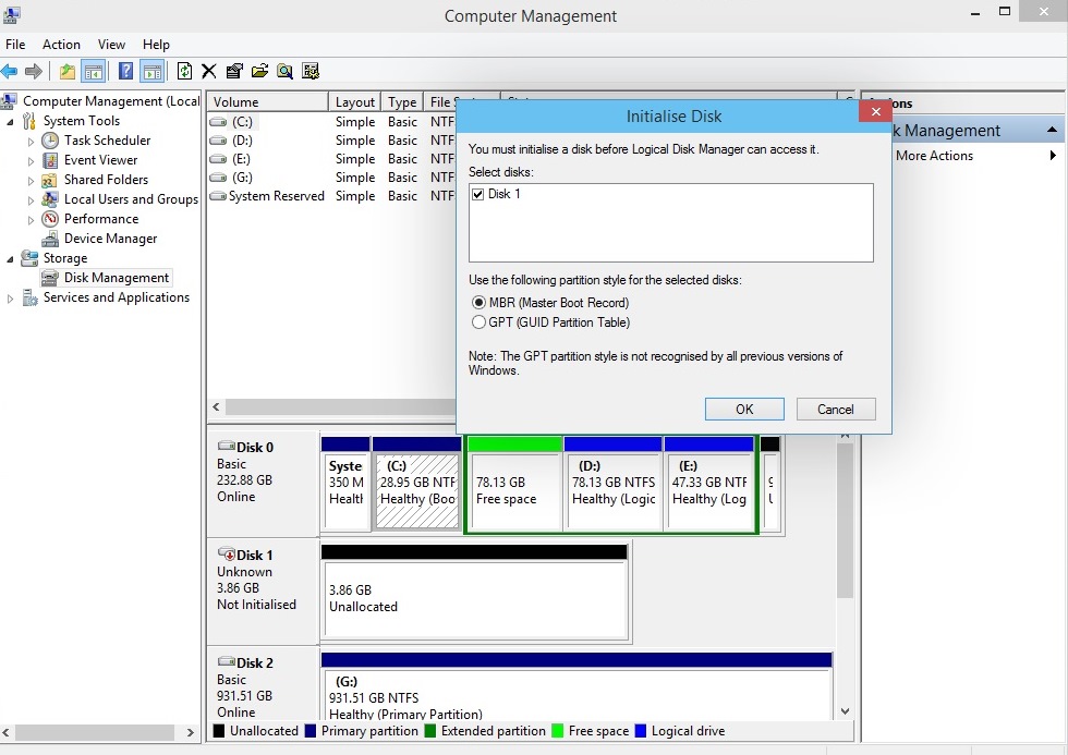

just now tried to connect again and a new tab of some warning was prompted by my DiskManager what does this means friends

It's a hardware issue, not software. Nothing you can do without special equipment will help, it will only make the situation worse.
Possibly the drive has a bad translator or something else wrong with it. You really should get it to a professional if the data is important.

Your power connector is fine, otherwise the drive wouldn't spin up.

Thanks guys and yes it is reading meadia error (head is not working) so just need to swap the head from another hdd if just the model match is sufficient to select a donor hdd
head damage was informed by me senior who was earlier into HDD recovery course Traineer.
