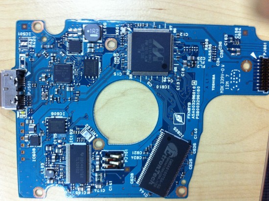

Dear all,
I've a unit of 2.5' USB port Toshiba hard drive, the front part of the disk (0% - 14%) is having massive of unread sectors, but the the rest are running smooth (right after 14%)
Was thinking to try out with compatible SATA PCB and run the imaging in Deepspar but then I realized that's no ROM chip on the board.
What other option(s) do I have for this hard drive? I've Deepspar and DFL-DDL
Thanks in advance

Hi all,
A forumer named 'cmcraeslo' mentioned the IC606 is the ROM chip in viewtopic.php?f=1&t=26163&hilit=usb+port+toshiba&start=20, it looks like it is the ROM chip.
Will give it a try
 Post subject: Re: USB Port Toshiba Hard Drive
PostPosted: December 16th, 2014, 21:06
Posts: 738
Location: Ottawa, Canada
In that thread, there is a post that shows the USB board and the SATA board side by side (http://prntscr.com/5hoxxw). You can see that IC606 appears only on the USB board whereas IC602 appears on both. I believe IC602 is your ROM and IC606 is for the USB-SATA bridge.
Hi Larry,
Now that's interesting. I didn't even notice that...
I'm searching for the donor SATA PCB, will see how it goes later.
Thanks again, Larry
Best regards,
Darecom

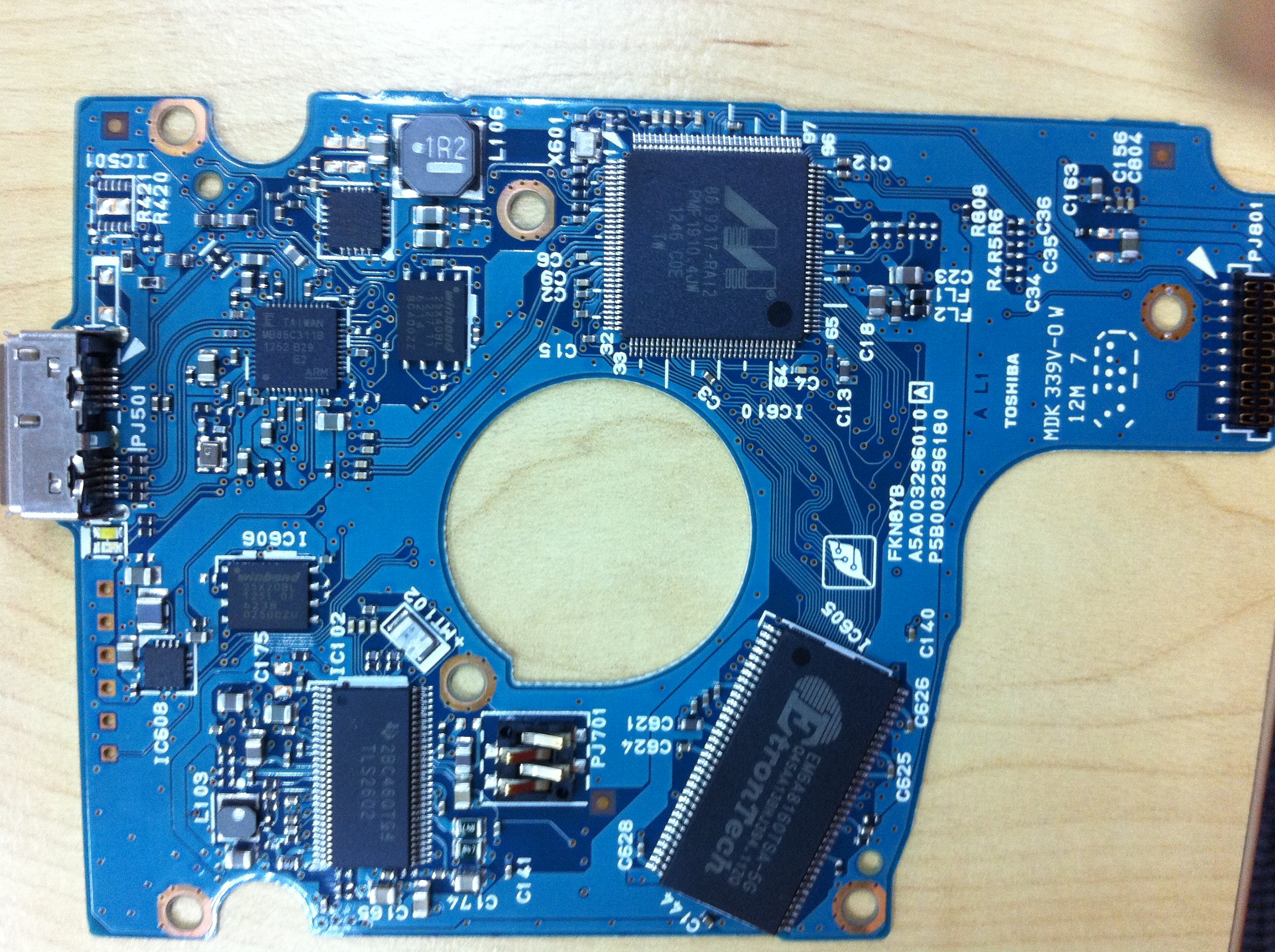

Why not convert to SATA Straight
Hi ROb,
Do you know the compatible SATA PCB that I should looking for?
Thanks in advance.

Look Again please ROb has marked the sata connections for you in his Picture :)

Hi ROb,
Thanks in advance.
Best Regards,
Darecom
No this one does not have any encryption for sure.
You can also search for more threads in this forum ( Specially Western Digital ) about how to convert it to SATA just to gain more confidence.
I have marked the points for you.
Need further help PM

Yes, these don't carry encryption.

Try FKN8LD.
