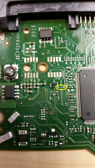

I have tried testing this board to define the read channel but the tests are inconclusive. I have marked what I presume is the read channel, can anyone confirm?
ST31500541AS
Board 100535537 REV A

Looks right to me...or the two just down to the left in the photo.
Its deciding which one of those two sets I am having issues with :D

I think you have the right two highlighted, the other set looks like it goes to the preamp which wouldn't make much sense.

you got it right mate
I've had same one a few weeks ago and I used the same pins

Thanks everyone :D

My tutorial shows you how to distinguish between the read and write pairs with a simple voltage measurement.
How to identify the Read Channel when no terminators:
http://www.alexsoft.org/viewtopic.php?f=24&t=123&p=1632
That is always my go to link to test these boards. But for some reason I was getting no voltage at all from the channels. I have another board I will test/compare it against tomorrow.
Why not? Where do they go, then, if not to the preamp?
