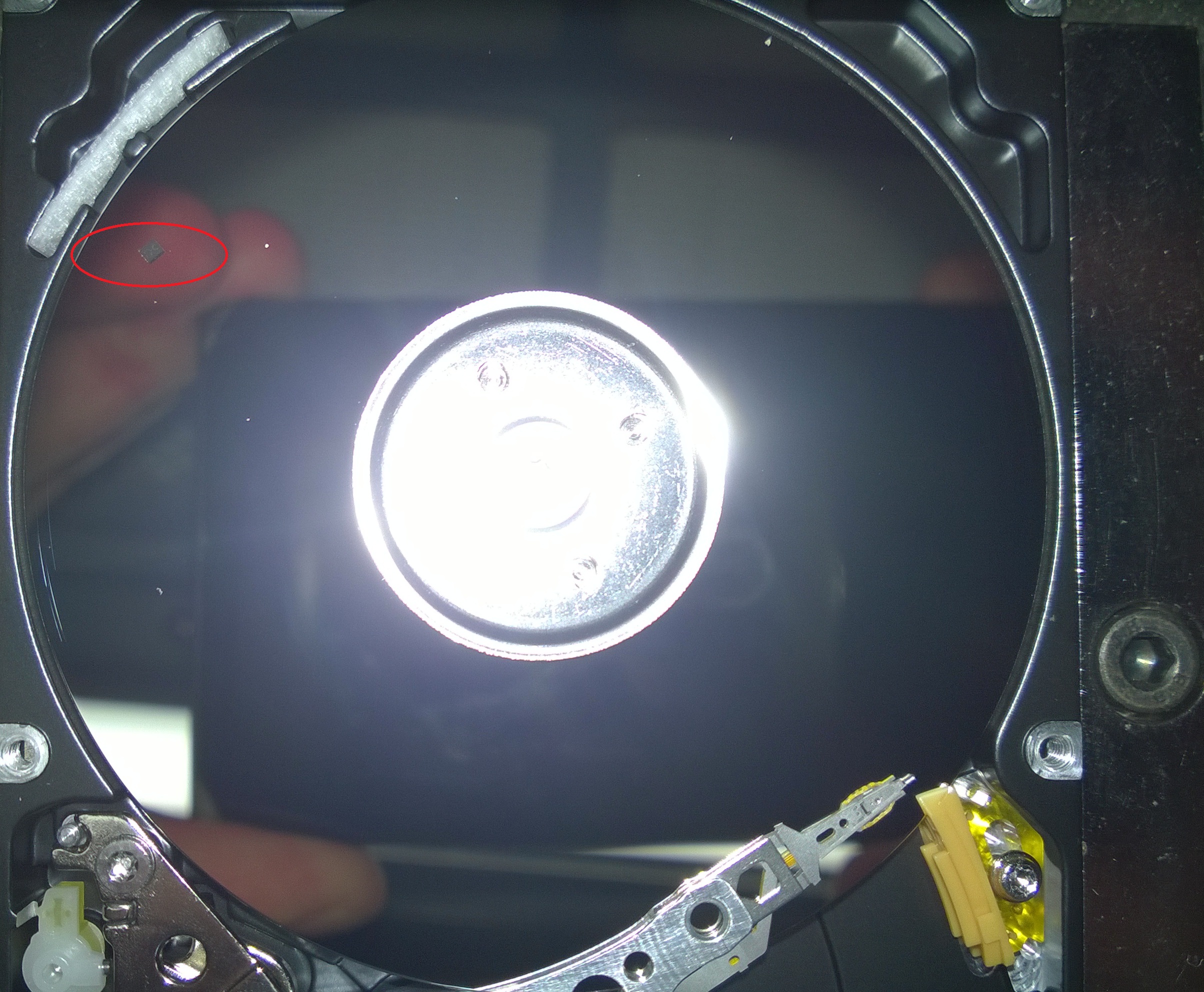

I have opend a WD800VE drive (IDE) and found that the heads are stuck on the platter and the magnets of the third and fourth heads are detached from heads and stuck on the platter in another place.
I could remove the magnet on the top by using a tweezers but with difficulty.
Is there a technique how to remove the magnet of the botton?
Thank you for your help.

Here is a photo of the top platter.

There are really no "methods" to removing the head sliders from the platters. But i would avoid removing them with any tool as your probably going to risk scratching the platters.
I would try heating the area with a heat gun (very low heat) with the HDD on its side. If it works they should just fall off the platters. I know heat isn't the best thing for platters but you don't have many options.

Its a head, not a magnet, for some reason its stuck to the platter due to stictation. Using a heat gun to warm the platter and magnet might make it loose. Again, strange how that happened the head must have been forced of the arm. Was the drive open in a clean room? It looks like there is dust on the platters, but that could be the image.

Twizzlers can Damage platters use paper to Remove it.

When I opened the drive in a clean room I found the magnet in that position. the head also is stuck (on the right).
the problem is not with the magnet on the top. I could remove it with tweezers . The problem is with the magnet on the bottom.

Those are NOT magnets...as stated before, it's the head (slider). If you have a plastic drinking straw you can flatten it and use it to remove the head on surface 0.

No, again. They are NOT magnets, they sliders and become stuck to the platter due to "stiction".

Have a look at a hard drive break-out here: http://hddscan.com/doc/HDD_from_inside.html
This is a slider: http://prntscr.com/5u4d13
This is a magnet: http://prntscr.com/5u4dj7
Now, which is it you are having difficulty removing?

Yes, I have done this on many occasions. In fact only last week we had a WD3200BEVT in with all four sliders snapped off and stuck to the platters.
Tricky, but not as tricky as a 3-platter 1tb portable :-)
Never had to perform this operation (yet) on a 4-platter Shrek drive, but not looking forward to it!!!

Possible without disassembling.
Lower part of the disk to the spindle in the cleaning solution from 3M for example.
Sliders themselves fall.

I didn't ment the big magnet. I thought that the slider also is a peice of magnet :)
Tomset, pleae could you expalain more? what is "the cleaning solution from 3M"?
