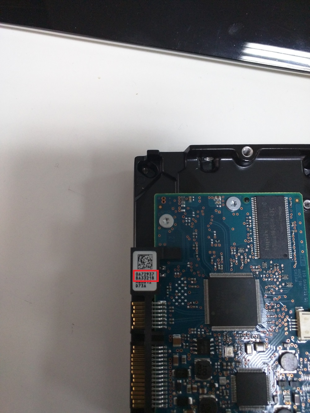

The pcb sticker shows: 0A72937 | BA3321B | M6H012 | D73A
What kind of requirements does the donnor PCB needs to fill ?
Thanks.

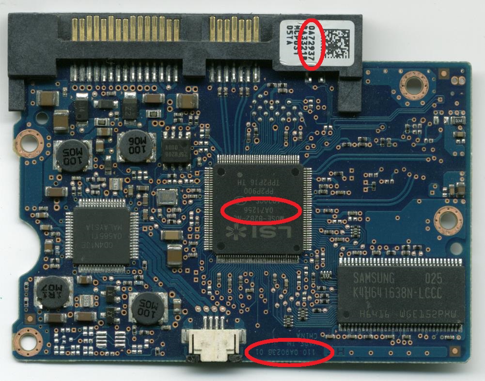

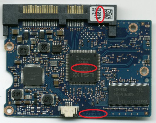

model, first 2 lines from sticker
 Post subject: Re: HITACHI HCS5C1010CLA382
PostPosted: January 12th, 2016, 11:57
Posts: 413

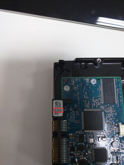

This ones right ?
Donor pcb must be from a disk with the same size also correct ?

This is the pcb I will buy, all the numbers match, however this pcb is from a hdd with 320GB capacity and not 1 TB.

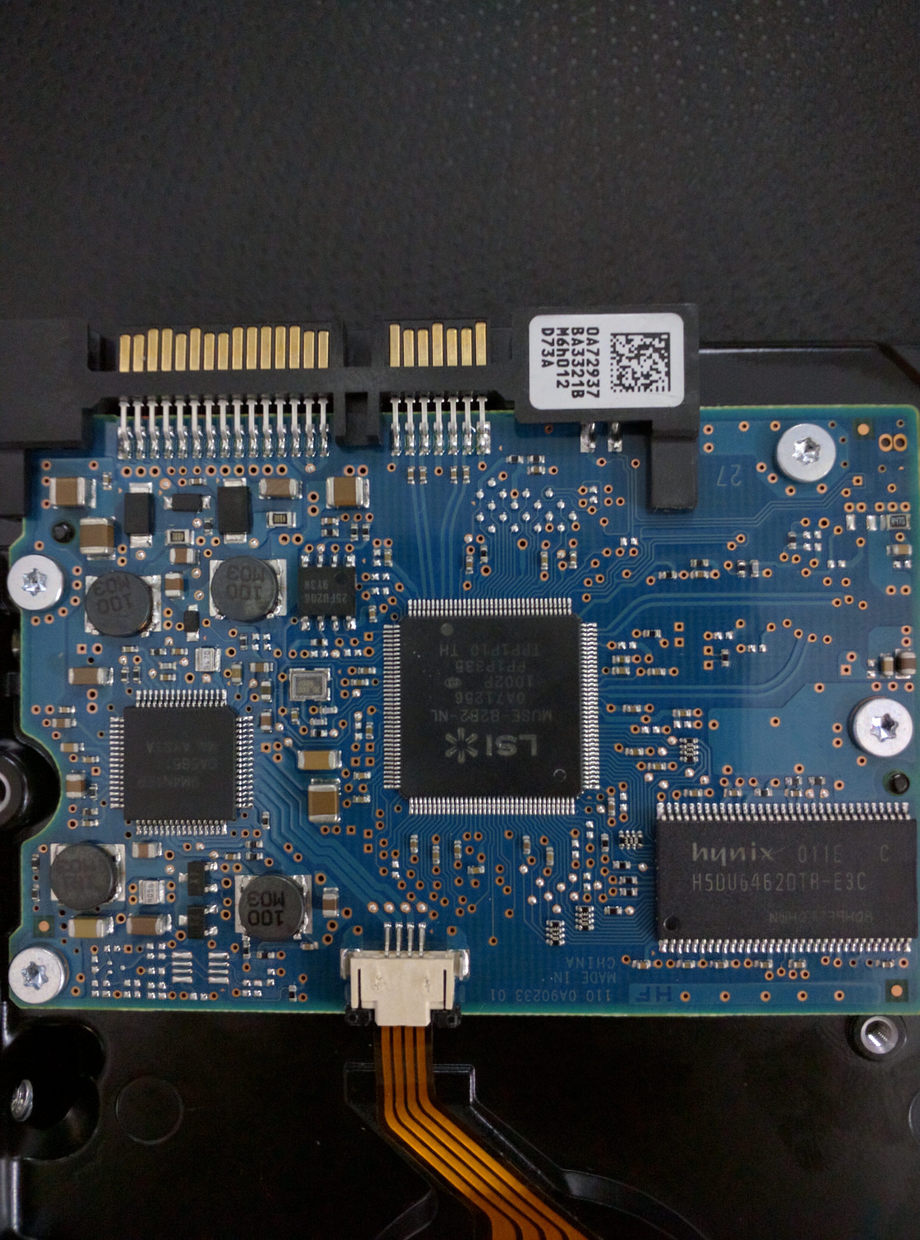

would you mind uploading a pic. from the patient's PCB ?
PostPosted: January 12th, 2016, 14:17
Posts: 413

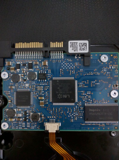

Here's the patient pcb

i can't read it

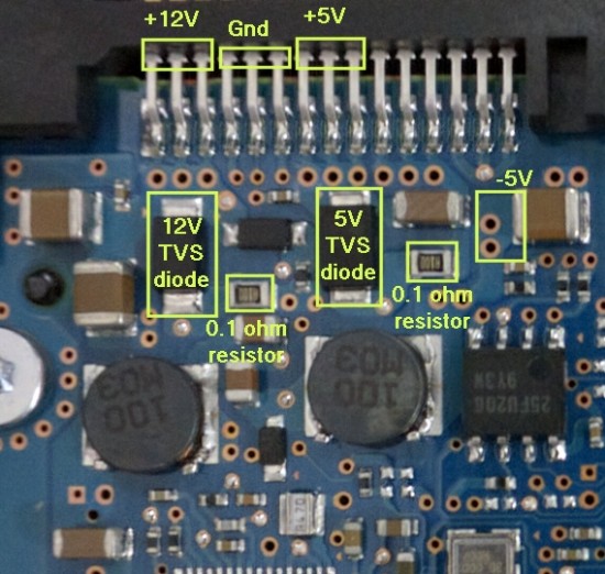

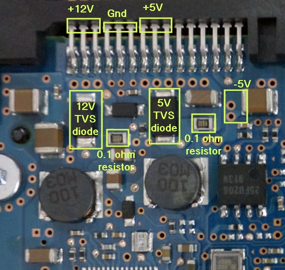

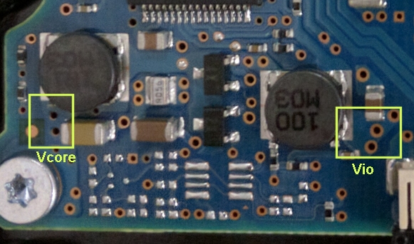

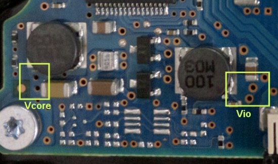

You can perform some basic measurements.
I would start by testing the 0.1 ohm resistors adjacent to the TVS diodes.
Next I would check the Vcore, Vio and -5V test points.

Posts: 413
all measures are correct, I'll order the freaking PCB and get on with it.

If the 0.1 ohm resistors are intact, and if either of the TVS diodes were shorted, then the drive should have shut down your PSU.
If "all measures are correct", then could it be that PUIS is enabled? If so, then a tool such as HDAT2 will allow you to disable PUIS.
BTW, the NVRAM checksum appears to be correct.
