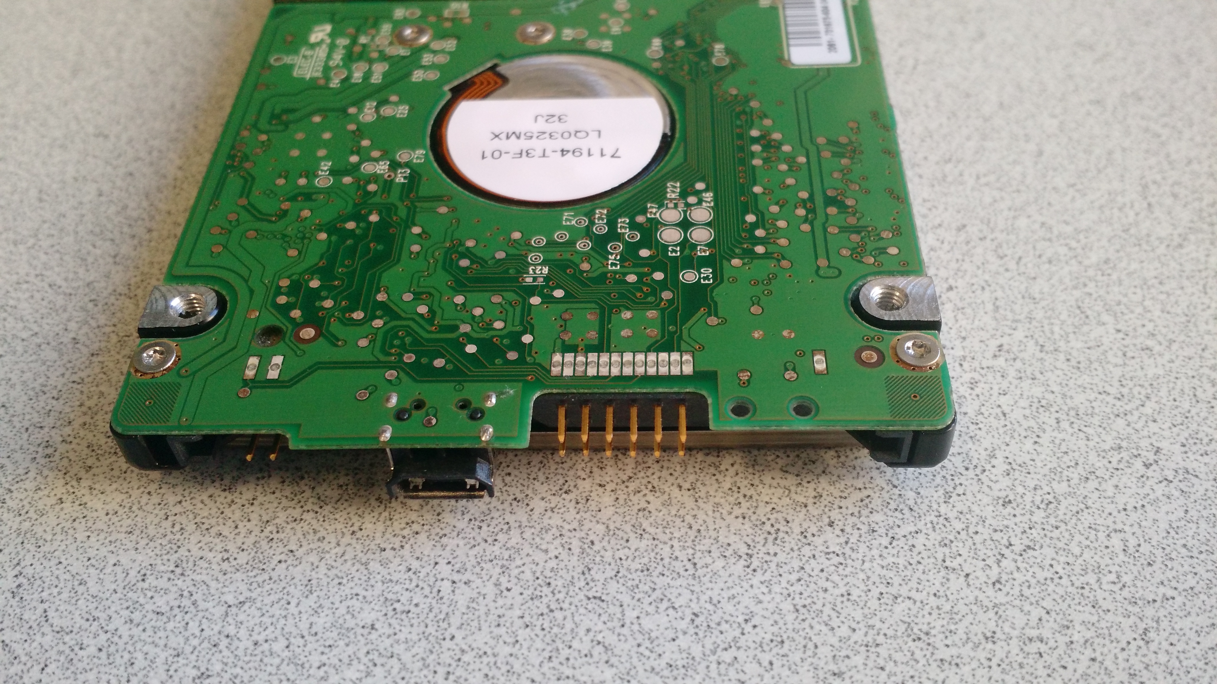

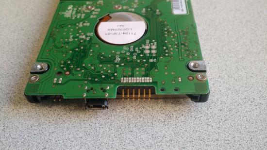

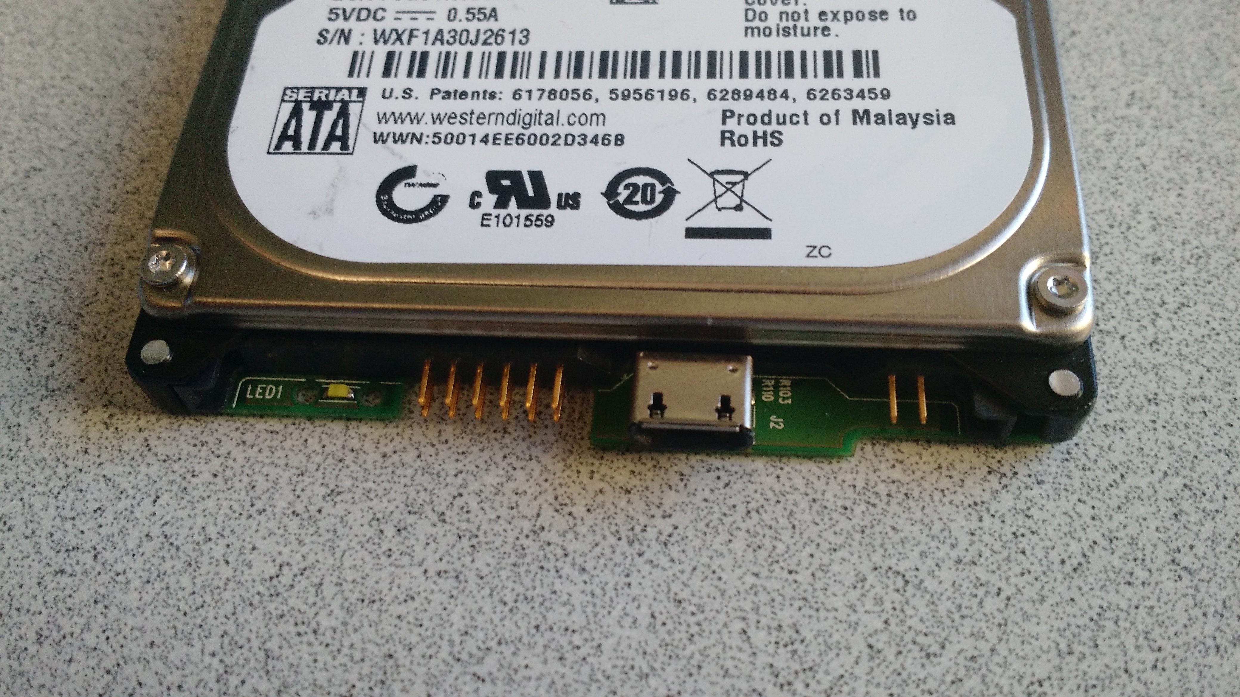

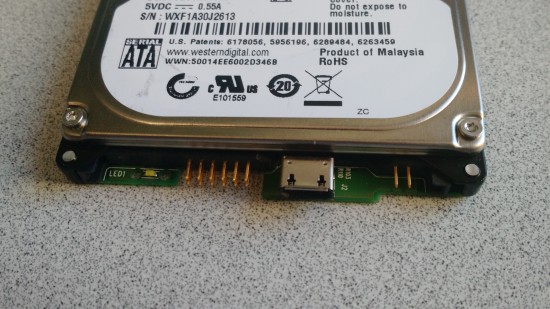

I found today that the original model number is "WD5000BMVV"
I am not still sure that whether there are any connector to SATA for the 12 pins near the usb cable or not.
any idea how to fix the usb port myself?
thanks again for your kind help guys. you rock
File comment: seems the usb port does not work, since the hdd spins

There is a slight possibility your USB connection might have some issues, but not likely.
You have to find compatible SATA board for your drive, modify it, image the drive and then decrypt it. Those drives could be very painful, if there is some other issues involved besides connection.
Good luck.

Any idea about how to modify it? I guess it would be hard to do it for me who has not ever done any professional soldering...
any easier solution? (other than taking to a specialist :)) )

I would say that replacing PCB with the ROM on this case is a GOOD BET because of this :
Note: previously I was able to hold the usb cable in a certain direction and have the hd works. but it does not work anymore.
I think that there is a good chance that the USB connector is broken.
Unfortunately, that board does not match mine. (since it seems board number should exactly match)
lets see if I can find any specialist in Houston
