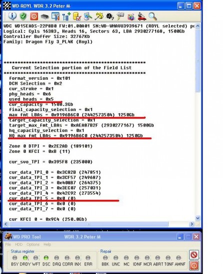

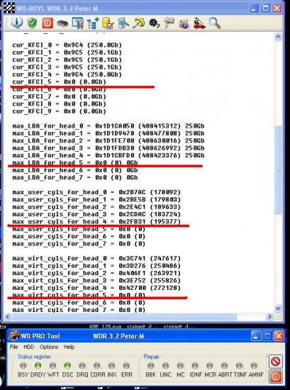

Hello everyone, Drive works again. The cause was, MCU Marvell 88i9045.
But, I have one question: How to fix it? Alternatively, the module that is responsible for that?
I warn you the hard drive is my private and no sale later is not an option. What's more, I do not want anyone to think that my attitude is demandingness.. Best regards, and sorry for my english(google translator)

Hello Spildit :)
Did you replace PCB and swap ROM to conclude the problem was with MCU ?

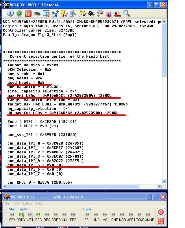

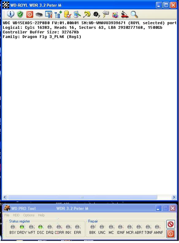

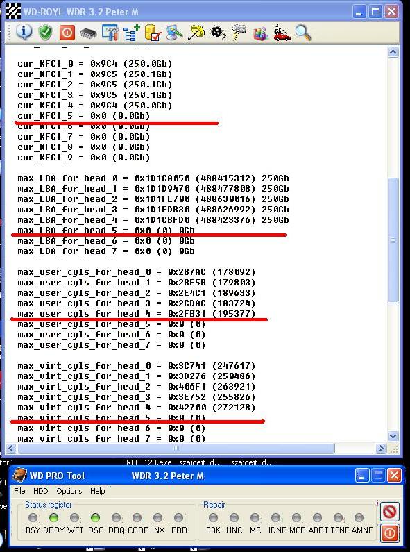

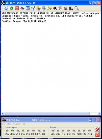

nope, i had, in their collections, the processor PCB 88i9045 so, the PCB native faulty processor desoldered and soldered efficient processor, as you can see, it worked.
You can see on the screenshot HDD name, SN, FW.
How do you intend to "fix" the MCU if as you stated -
The motor did not want spin, and by the way the heads did not want to calibrate. As the attached film.
On the other hand I am concerned on how to improve the entries is marked with a red line, which is responsible for that module.
Do you understand me?

Heads from 0 to 5 with 250 GB each :
0 - 250
1 - 250
2 - 250
3 - 250
4 - 250
= 1.5 TB
What do you want to improve ?
Missing 5 - 250GB, Therefore, I want to change that.
Drive has 6 heads, no 5 heads
What do you mean by this ? How could the heads calibrate on a non-spinning disk ?
In my case it was like trying to drive the motor to spin out, you could feel the vibrations, and when the heads were calibrated to the drive motor is stopped. Now you know what I mean?

Thanks Spildit, could you hint that FW module is responsible for these sections?
