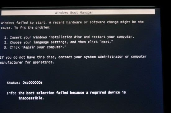

Interesting results, on my Dell Optiplex 7010 I bought a year ago, new.
Results are reported as a timeline to help clarify.
12:15am Physical setup: Hooked 500GB HD with Windows 8 to SATA 0 port on motherboard; Hooked 1000GB HD with Windows 7 to SATA 1 port on motherboard
12:25am In BIOS I set SATA 0 disk visible, SATA 1 disk not visible No problem. booted Win 8
12:28am In BIOS I set SATA 0 disk not visible, Sata 1 disk visible No problem, booted Win 7
12:32am In BIOS I set SATA 0 disk visible, Sata 1 disk visible. The system booted to Windows 8, but none of the partitions on the SATA 1 drive were seen by Windows Explorer.
12:35am I ran the Disk Management applet (Control Panel > Administrative Tools > Computer Management > Storage > Disk Management). In that view, hard disk 1 (i.e, the SATA 1 hard disk) was visible, and all its partitions were visible, but not assigned any drive letters. It had two partitions of interest, namely the boot partition, and a partition I had created to hold my data.
I unhid the data partition and rebooted.
12:39pm After rebooting, the data partition on hard disk 1 became visible in Windows Explorer, was assigned drive letter F, and files were fully accessible on that partition.
12:41 I shut down the system, went into BIOS, and set SATA disk 0 not visible, and set SATA disk 1 as visible. No problem, booted to Windows 7.
12:44 I shut down the system, went into BIOS, and set SATA disks 0 and disk 1 visible, and rebooted. I then ran the Disk Management applet, and unhid the boot partition on SATA disk 1.
12:47 Rebooted. Windows 8 (located on hard disk 0) went into action to establish its primacy. It recognized there was a boot partition on hard disk 1, and steriized that partition (not sure sterilized is the right word: but anyway, it rendered it unbootable.)
So... in sum... the data on the boot partition of hard disk 1 was exposed and made accessible, but the booting ability was removed.

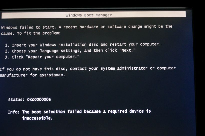

12:55 Rebooted into BIOS, disabled hard disk 0, and kept hard disk 1 enabled. Booted. Got an error message shown in the attached photo:
As expected, Windows 8 had established itself as king, and beheaded its rival.
