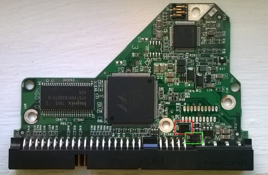

SOSdonnees wrote:
There might be some protective diode to replace on your circuit.
Do you mean transil?
 Post subject: Re: WD1600AABB - drive is complety dead
PostPosted: May 15th, 2015, 15:08
Posts: 17335
See http://www.users.on.net/~fzabkar/HDD/bi ... diodes.jpg
That said, ISTM that if your drive does not short the computer's PSU, then there must be other problems on the PCB (or preamp). I would still measure the diodes and resistors, though.
One other possibility that you should consider is Power Up In Standby (PUIS). Does your drive appear in BIOS, even if it is with a blank model number?

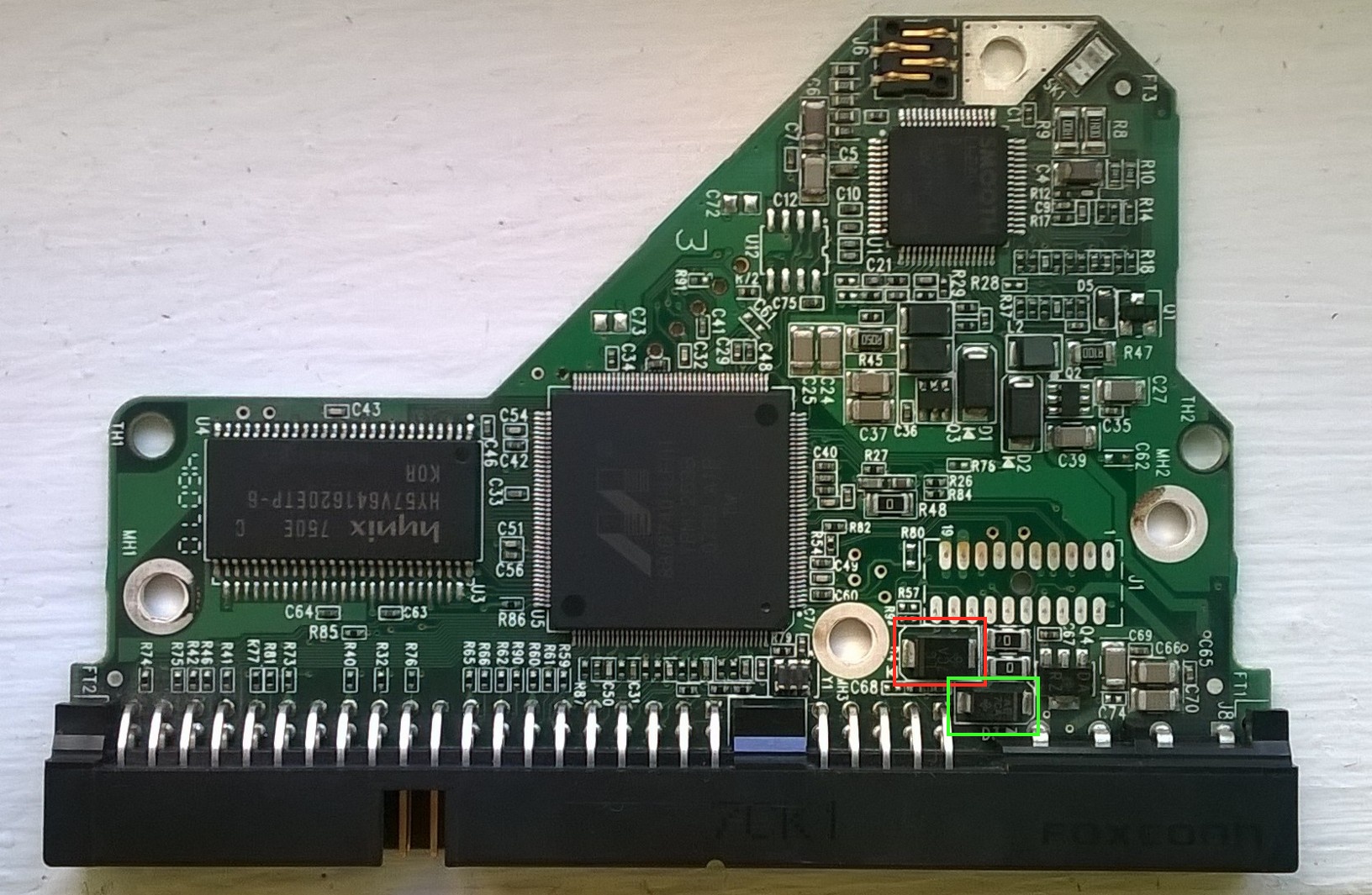

I've checked two diodes. I set multimeter range on 2 MOhm.
The red one give 0.55 MOhm in both directions.
The green one give 0.06 MOhm in both directions.

I've soldered out diodes and they are ok - let go current only in one direction.
I discovered that when the drive is connected to a computer, the PCB heats up

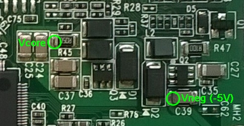

Measure the following voltages:
Vcore - Vneg: 1.2V
Vio_TVS: Left pin - 1.5V, right pin - 0.8V
PostPosted: May 18th, 2015, 18:42
Posts: 17335
Vcore - Vneg: 1.2V
Place the black probe (COM) on a ground point, eg a screw hole. Then measure the voltages with your red probe.
ISTM that you wrongly used the +5V tab of Q4 as your ground reference for one measurement, and the -5V test point as your reference for the Vcore measurement.
I have placed black probe in Vneg and red probe in Vcore.
Next picture Vio_TS - black probe in the botton pin, red probe in top left and right pins.

I have placed black probe in screw hole as fzabkar wrote and I have new measures:
Vio_TVS: Left pin: 3.28V,
Vio_TVS: right pin: 4.05V.
Vcore: 1.36V
Vneg: 0.14V
PostPosted: May 19th, 2015, 18:22
Posts: 17335
Measure Vneg again, but this time watch to see whether it goes to -5V immediately after power-on and then drops to 0V. AIUI, this will prove that the MCU is alive.
