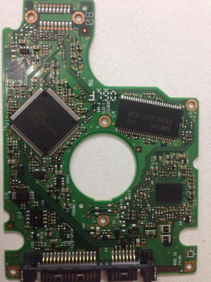

Greetings friends .
i would like to ask you for your professional opinion in this HDD .
Hitachi travelstar
model : HTS541060G9SA00
size 60 GB
drive is not spinning up at all ... below is a snapshot of the pcb hopefully it can tell it's story ..
nothing that the fuse and the near by resistor test OK , and no burm marks at all on any component ..
thank you in advance

have you checked the status of PUIS ?
 Post subject: Re: Help ! Hitachi PCB issue
PostPosted: May 22nd, 2015, 4:34
Usually it's the fuse at F1 that blows, but if you've checked that then I would transfer the NVRAM @ U6 to another compatible PCB.
If you can't find a PCB with same ROM version as yours, you'll have to switch ROM @ U3 too.

Did you check fuse at F1, as pcimage suggested?

Raven4d,
Are You From india .Let Me Know i can check my stock and let you know if i have this .Please Post Photo of HDD top cover also and the other side of this pcb

the fuse and the 0 OHM resistor are OK

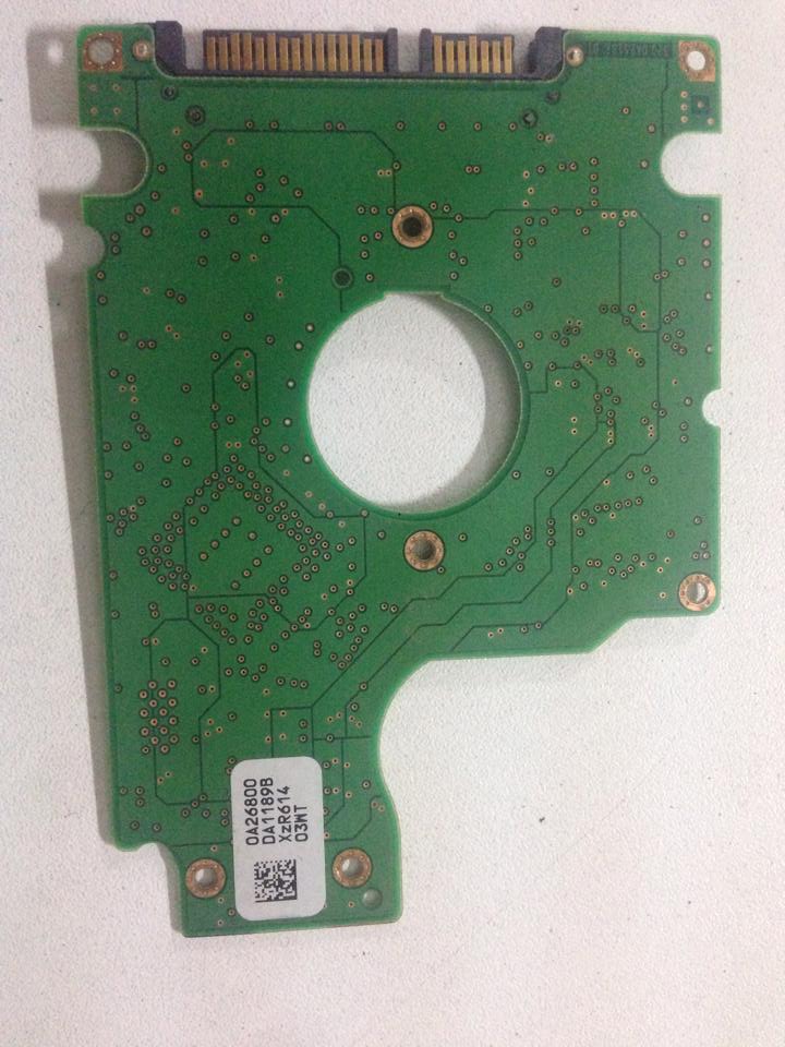

Post a photo of the other side of the PCB and I'll check if I have a suitable one here.

Please Post a Photo of Other Side As stated By Sean and Asked By Me

please find below a photo of the backside of the PCB
can someone who has the very same mode be kind to test the resistance between the motor pins ? now am suspecting a motor burn ?

well, after testing a non compatible PCB , the drive spins up and no clicks , so i presume now am sure that it's a pcb related issue ...
