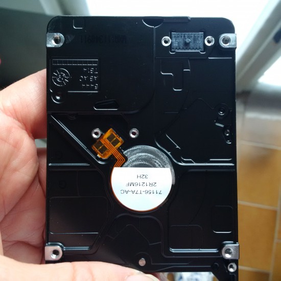

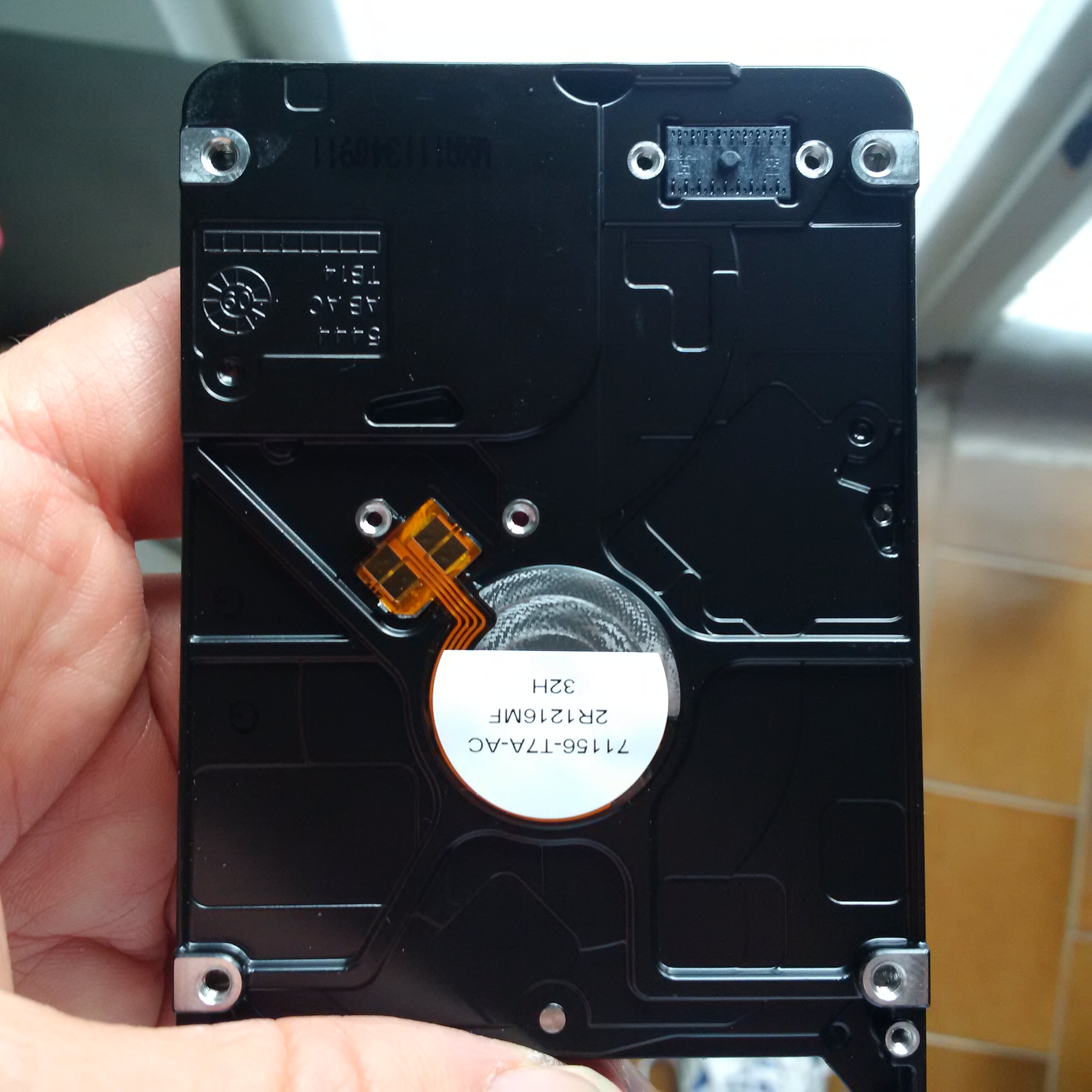

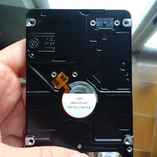

 Post subject: Re: WDC PCB Exists ? -> XXXX-771939-XXX
PostPosted: June 3rd, 2016, 11:34
Joined: June 25th, 2006, 13:51
Posts: 143
Location: Italy
Hi Amarbir is right,
See attached picture
The spindle contacts are near the motor
I'm not able to find it again, but the board 771939 is it seen by me red color instead than green, maybe it is reallya a rare board
Though Marvell processor is the same as in the 771814 (USB) and 771820 (SATA equivalent for 771814), on these latter boards, the spindle connector is in the right place
what it does change is the HDA controller, maybe they could work.
Now I try
File comment: Bottom view of WD10TMVW-11ZSMS4
 Post subject: Yes WD board 771939 exists
PostPosted: June 3rd, 2016, 11:59
Posts: 143
Location: Italy
OK discovered the issue
board 771820 loads the ROM but next the drive won't spin
mounted the board on the donor, it won't spin anymore neither the donor drive
finally I've re loaded the original ROM on the donor and now it is back spinning and initialize fine
Looks like that one test with that mysterious 771939 board is needed, otherwise the only way is the transformation USB-->SATA
