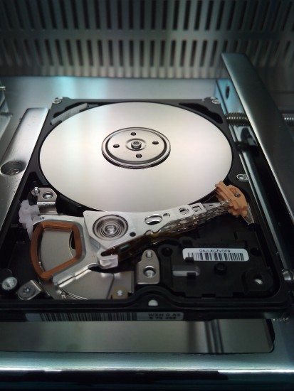

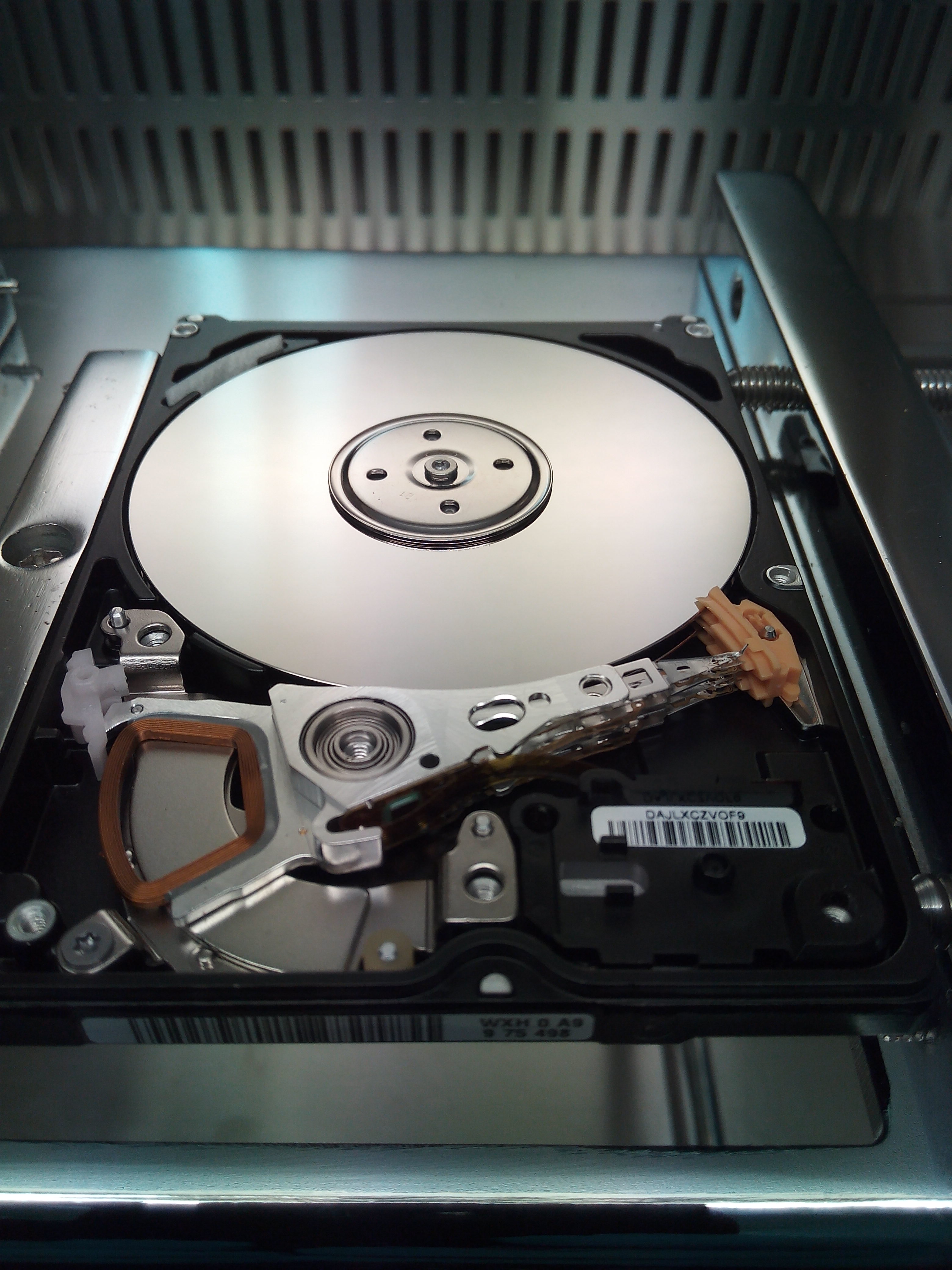

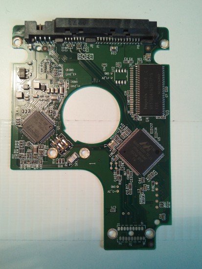

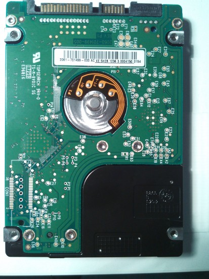

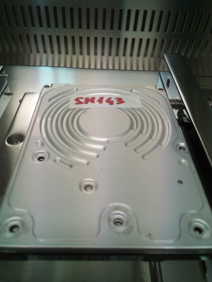

I'm getting mad... I am trying to find a donor for a WD HDD I have here. The HDD is without label, so I have no info about it, only PCB and serial number. I attach some photos of it. HDD needs new heads.
PCB is 2060-701499-000 rev A and S/N is WXH0A9975498
PC3000 says that PCB is Denali family, and head map is 0,1,2,3. So I think it's a WD3200BEVT-XXZCTX.

The drive always clicks with all these heads. The heads returned to donors work well.
Can you help me to find a right donor for this HDD or could you tell me where I am wrong in searching for donors?

 Post subject: Re: Trouble finding a donor for a WD without label
PostPosted: June 24th, 2015, 11:03
Posts: 402
Location: Moscow
It should be read the ROM on HW programmer
or
separate PCB, WD utility.

maybe the PCB is not the native ?!
PostPosted: June 24th, 2015, 12:02
1. Why is the label missing?
2. What was done before you got the drive?
3. As mentioned, can you be sure that this is the client original PCB?
It very likely is fatal damage, either from the original issue or as a direct result of someone else screwing around with the drive. I sure hope that your client is paying you for each donor and the time spent with the shotgun approach.

1) The label is missing because client removed it to open the drive :(
2) Client says he opened the drive and then closed it
3) So maybe this is not original PCB? I had this doubt... now I ask client... I'll let you know.

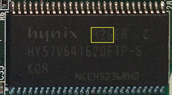

FWIW, there are Year/Week (YWW or YYWW) date codes on each of the ICs.
If you are incapable of understanding them, just upload a photo of the PCB.

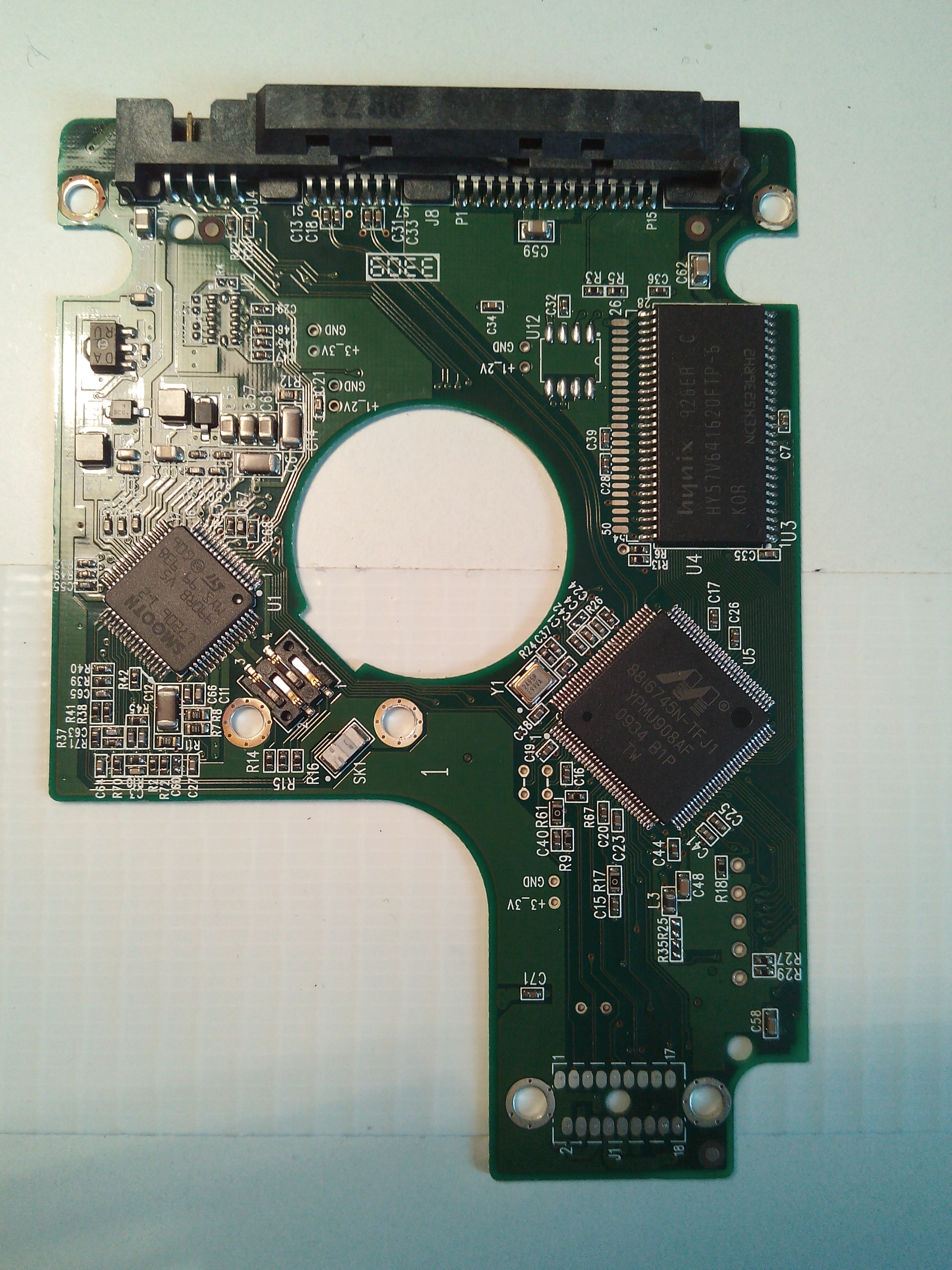

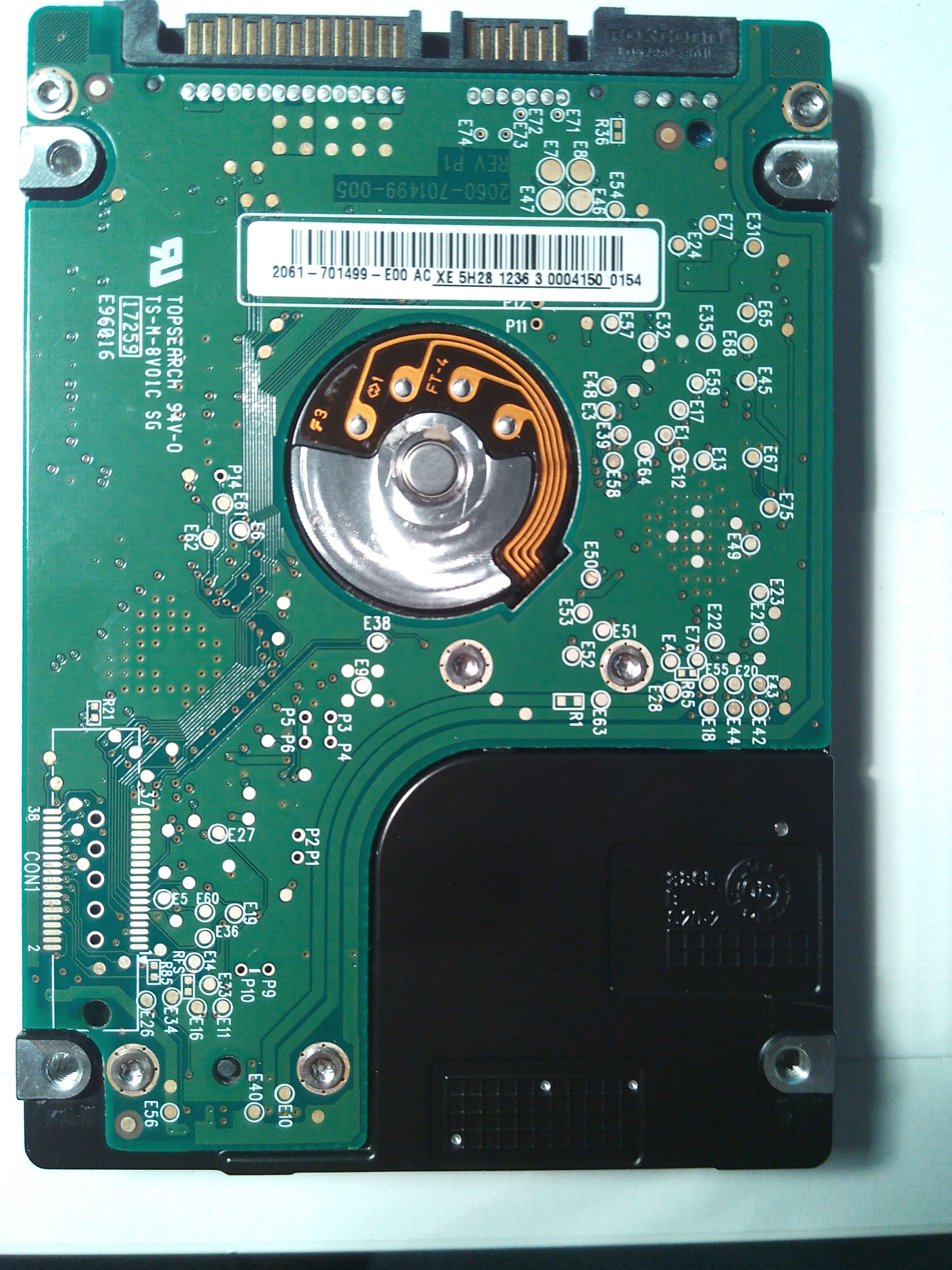

Thanks fzabkar, here is PCB picture.
PostPosted: June 24th, 2015, 15:48
Posts: 17232
Sorry, but I don't have Superman's xray vision.

Those are tricky when it comes to heads and other areas in terms of compatibility. Tomset's advice is good stuff.
PostPosted: June 24th, 2015, 18:33
Joined: May 5th, 2004, 20:06
Posts: 2782
Its model is > WD3200BEVT-00ZCT0
PostPosted: June 24th, 2015, 20:31
Posts: 1388
Location: isreal
so... we can assume
1) its the native PCB
2) the drive was probably manufactured around sep oct 2009
the question is in what country
have you tried heads from HDD no. 3 + the PCB from no. 3 ? i.e. using the heads + PCB from donor
(maybe the PCB is native but the ROM isn't)

here is another pcb pic for fzakbar
Simone

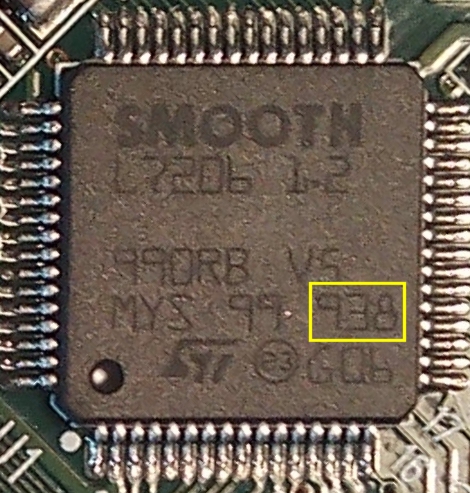

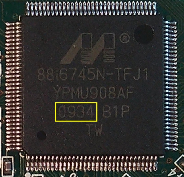

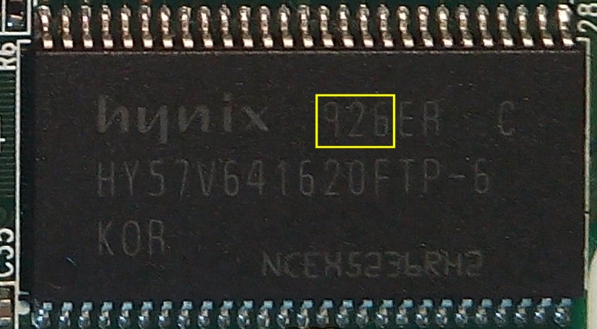

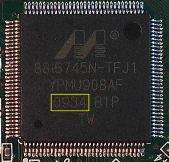

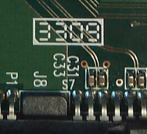

PostPosted: June 25th, 2015, 15:57
Posts: 17232
MCU - 0934
PCB - 3309 (WWYY)
SDRAM - 0926
SMOOTH - 0938
Identifying HDD IC markings - ST313021A case study:
http://www.hddoracle.com/viewtopic.php?f=59&t=207&p=510
