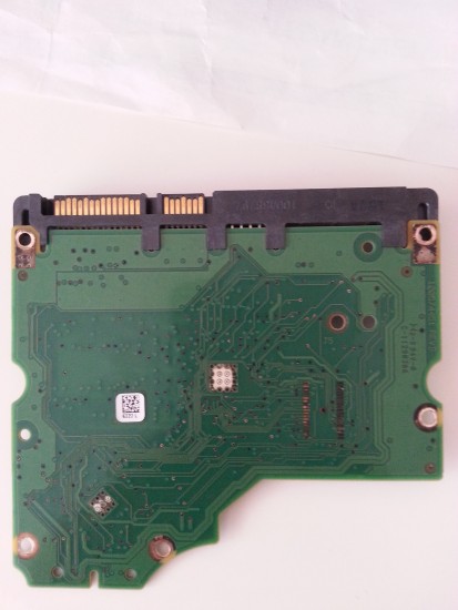

i need to find short points on pcb. any advice pls.
Best Regards
 Post subject: Re: i need help for ST31000528AS
PostPosted: June 29th, 2015, 8:49
Posts: 1388
Location: isreal
Tip: How to identify the Read Channel test points:
http://www.hddoracle.com/viewtopic.php?f=24&t=123&p=149
