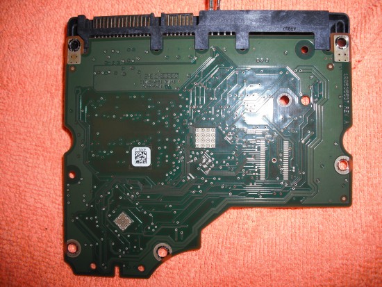

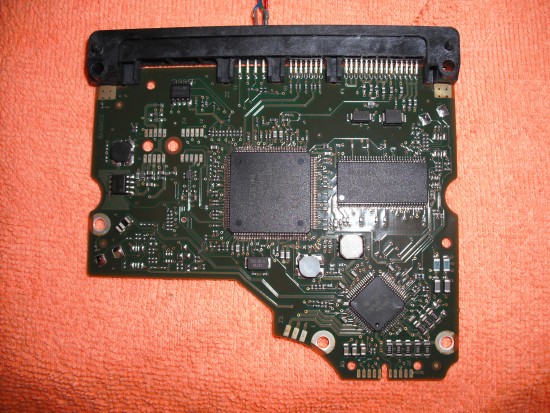

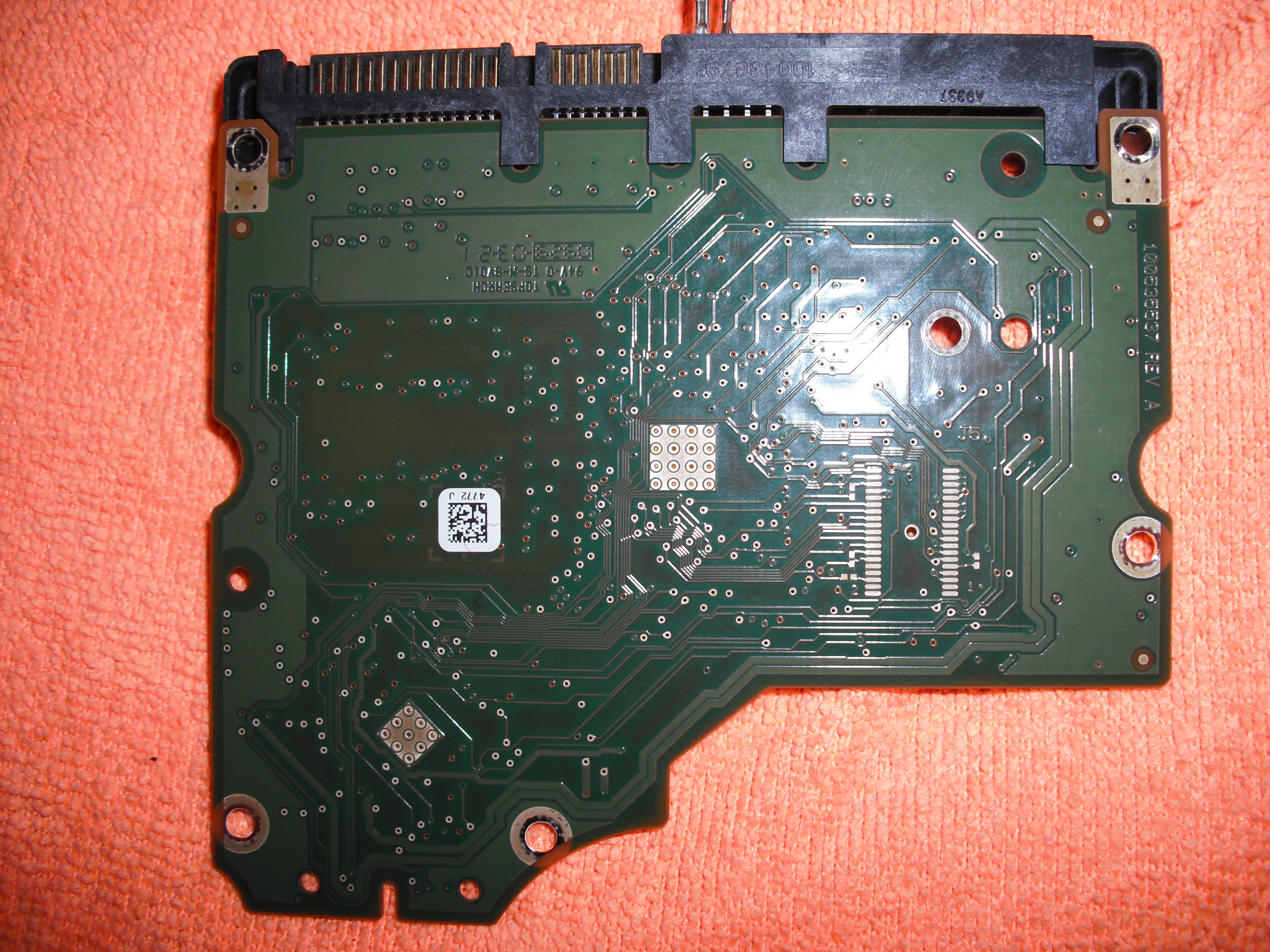

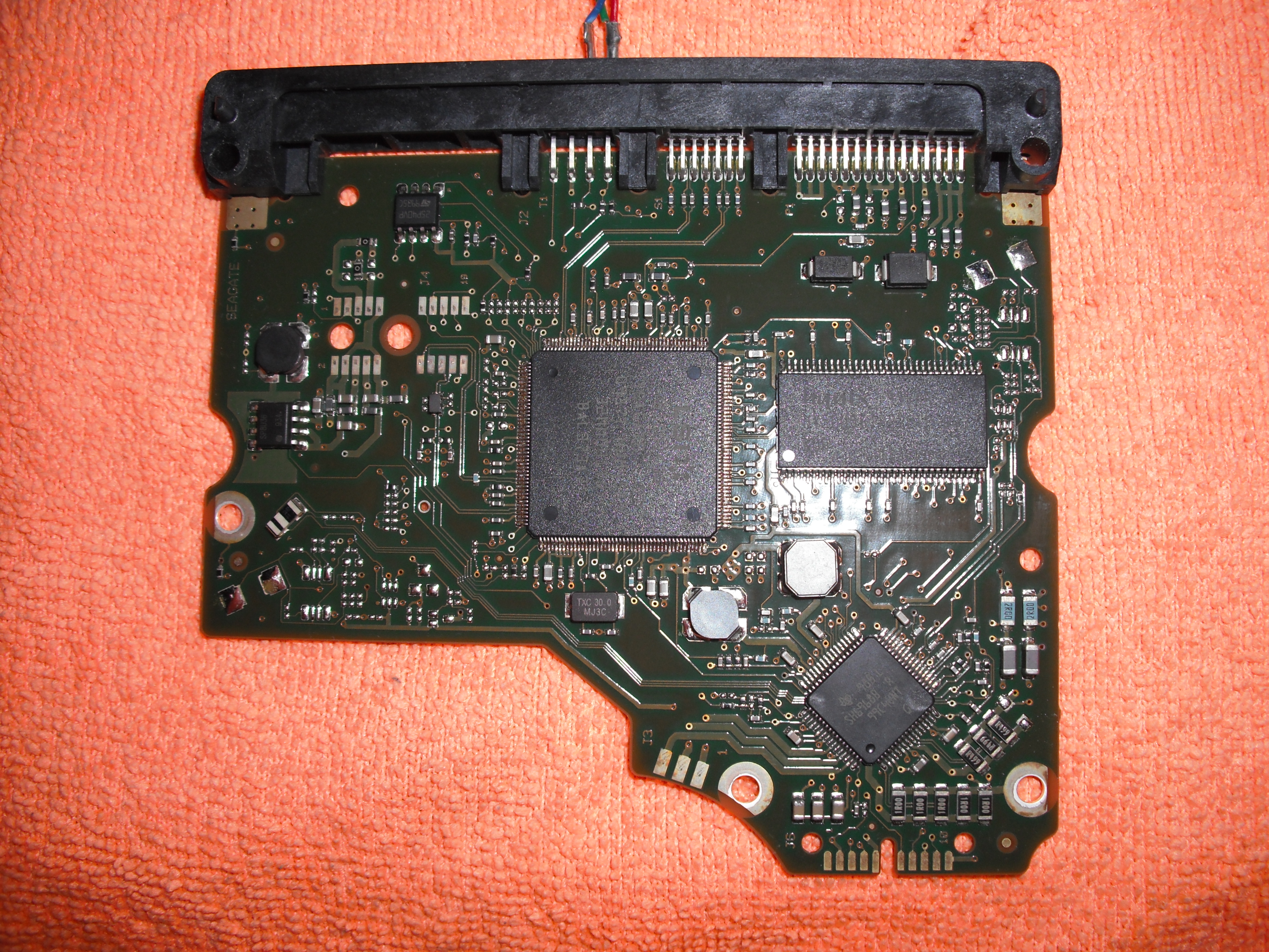

 Post subject: Re: Segate 7200.12 suddently not recognised from bios
PostPosted: August 10th, 2015, 7:27
Joined: August 8th, 2015, 9:46
Posts: 11
Location: europe
This is the board 100535537 REV A:
http://i.imgur.com/MM170b8.jpg
http://i.imgur.com/WYbs8oD.jpg
