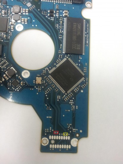

I have a Seagate ST3000DM001 HDD that spin correctly reaches readiness but doesn't read Drive ID/Capacity...
I could access terminal and test heads ans SMART and everything seems OK.
I had the same problem that I resolved by the F3 T>m0,6,3,,,,,22 command in terminal.
When I tried this command in Terminal, it shows me Partition formatting OK but when I powred ON/OFF the drive, the drive stuck in BSY and when I try to access Terminal it can't and shows me "Terminal : reply timeout error"
I tired to short-cut the read channel, the drive produce a BEEP and stop spinning but steel I can't access Terminal.
Could you please help.

I tried several times to shortcut the read channel until I got this:

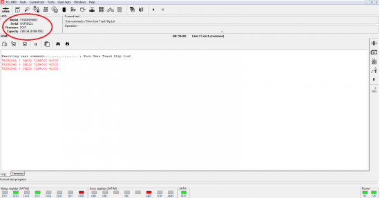

Then I tried to short-cut the read channel and I got:
Drive continue spinning, reaches readiness, drive ID read but with wrong capacity?, no terminal access:

See Photo attached:
Then I could re-access Terminal:

I followed the solution for "No HOST FIS-ReadyStatusFlags 0002A1A1" on PC3000 blog: http://blog.acelaboratory.com/pc-3000-h ... error.html
but unfortunately, in the end the drive reaches rediness and I can access Terminal but doesn't read drive ID :roll:
Any help please?
 Post subject: Re: ST3000DM001 BSY and no Terminal access
PostPosted: August 15th, 2015, 12:36
Joined: September 7th, 2012, 16:37
Posts: 198
The issue was RESOLVED and I could read drive ID and access DATA.
I just closed the utility and re-opened it :D
HTH.

Follow this steps:
