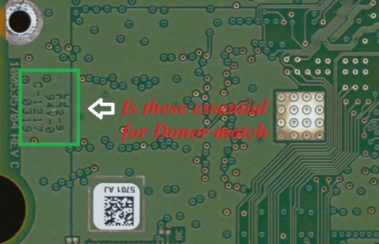

My HDD Spec
Seagate Barracuda 500GB SATA
Model ST500DM002
S/N S2A6M2A4
P/N 1BD142-302
Firmware KC45
Date Code 13382
Site Code WU

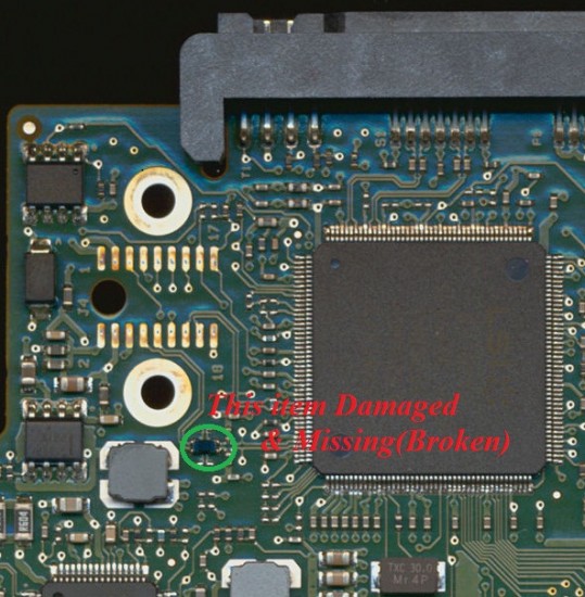

Damage in PCB
So To Replace the PCB Donor Drive Differ in Date Code & Site Code also some codes mentioned in the picture
is these numbers (Marked in Square Box) to be matched?
Pls Clarify the doubt
Note: Can i replace the Damaged component(Broken) from another board ?

For Pcb swap you need to match the Pcb number (starting with 100xxxxxx) and swap the ROM
